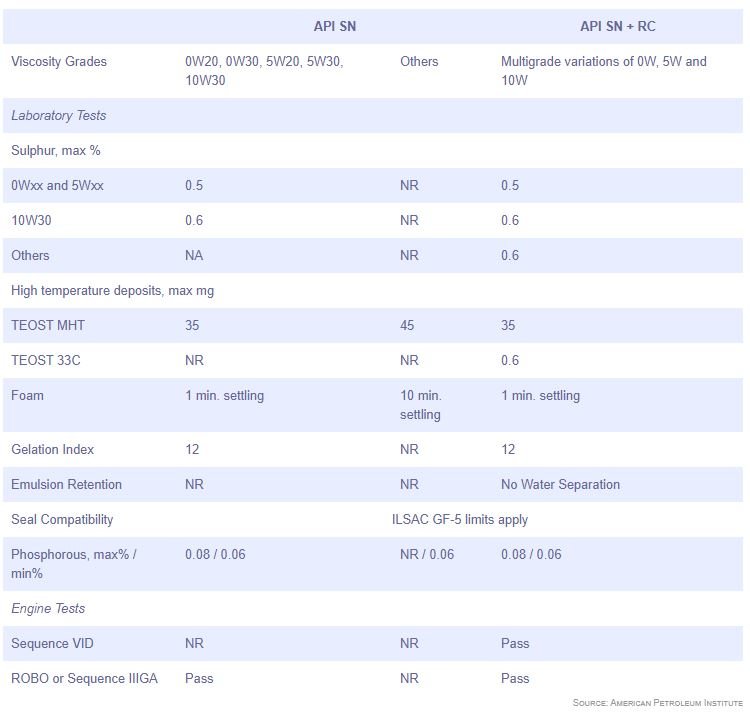

    To build on this... Oils are tested to meet certain specifications based on their requirements. For example, Mobil 1 specifies one of their oils meets API SN. What does this mean? Well in nerd talk...
    "Introduced in October 2010 for 2011 and older vehicles, designed to provide improved high temperature deposit protection for pistons, more stringent sludge control, and seal compatibility. API SN with Resource Conservingmatches ILSAC GF-5 by combining API SN performance with improved fuel economy, turbocharger protection, emission control systemcompatibility, and protection of engines operating on ethanol-containing fuels up to E85."​
    There are specific requirements that must be met to claim you meet this standard... whether dollar tree oil or snake oil you buy from an independent dealer. They all meet the bare minimum requirements. Some, however, may perform much better in certain areas, meaning you may have better sludge control, less foaming, and the like. The additive packages the oil companies specify are what drives price (for R&D and marketing). And as said before, this is BIG BUSINESS to the oil companies and is extremely competitive.
    Is a more expensive oil better? Perhaps. But a cheap oil that meets spec will also work for the recommended intervals the manufacture's engineers specify as well. Just like owning a Kia and a Porsche. Both meet minimum US DOT and safety requirements... but we know one is better at certain tasks than the other.

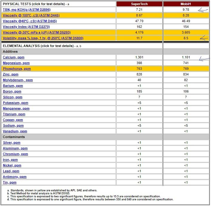

    I pulled up the latest SuperTech 5W-20 vs. a Mobil 1 5W-20 from http://pqiadata.org/ (they didn't have a recent 0W-20) but notice what I pointed out. The TBN is lower on the SuperTech/Kirkland/AmazonBasics which means shorter drain interval / less fluid life
    The volatility is higher (bad) on the cheap stuff, and the calcium detergent (cheapest) which tends to cause pre-ignition is at the highest level allowed yet still meeting API SN Plus so technically it does still work for Turbo GDI engines.
