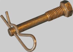

    Looking for others input whether this is a good idea. I was thinking about adding a cotter pin to the 4 bolts that hold the lower ball joint to the hub. These bolts are notorious for backing out. I may only be able to get a cotter pin on two of the bolts because 2 of the 4 bolts aren't exposed at the end once tightened. I put lock tight on them when I reassemble but was thinking about this to avoid lock tight every time and more peace of mind. Red lines in picture indicate where the cotter pins would go. Anyone ever done this?

    A cotter pin will not prevent the bolt from failing if it does back out to the point that the cotter pin is actually doing something. The constant cycling at that point would fatigue the bolt in no time and it would fail anyway. If you use medium grade locktight and torque them to spec (59 ft-lbs), and check them every once in a while, you will have no problems. You can also use a paint pen or similar to make a match-mark once they're torqued, then it's really easy to see if they move at all without having to check them with a wrench.

    if I'm looking at this right, even if the others backed out, these two by leverage would hold the joint steady. But drr is prob. right. On my tractor pins like this would get wiped out by grass constantly anyway.

    Red Loctite applied, Torqued to spec, holds.
    I've never seen a Taco BJ bolt back off if done so.
    besides...
    You likely won't need bust them loose for at least 100K or more.
    if ya gotta turn them off by hand, heat up the bolt and it'll soften the Locktite and turn.
    or use pneumatics and that'll bust them free pronto.
    Remember... always use new BJ bolts if removal occurs.
    Even if ya don't replace the existing BJ.
    ~ New Bolts, Red Loctite, Torque to Spec. ~
    ^ One of the plausible reasons why others BJ bolts have failed.
    ~ busts 'em loose, re-uses bolts, blue locktite cause it was handy, blame's the truck ~ :rolleyes:

    If you have removed your lbj bolts often, it might not be a bad idea to replace them. However, there is no need to replace them every time you bust them loose, they are grade 10.9 bolts (~136 ksi yield) and torquing them to spec will not even come close to permanently deforming them. Also, medium grade loctite (blue) is plenty of torque augmentation if you're checking them regularly.

    if you are really paranoid you can always safety wire them.

    What type of bolt is this? I'm interested because I think it could be the QD solution to mounting a tool box in my taco.

    Jbrant- I'm not looking for my lower ball joint. I am trying to find a cotter pin like this (ironically google image search took me here). Basically want to do the drop bar mod for the bed track system, then mount my tool box with bolts and cotter pins, so I can pull in and move the box out (I've got a 3 fold tonaeu cover).
