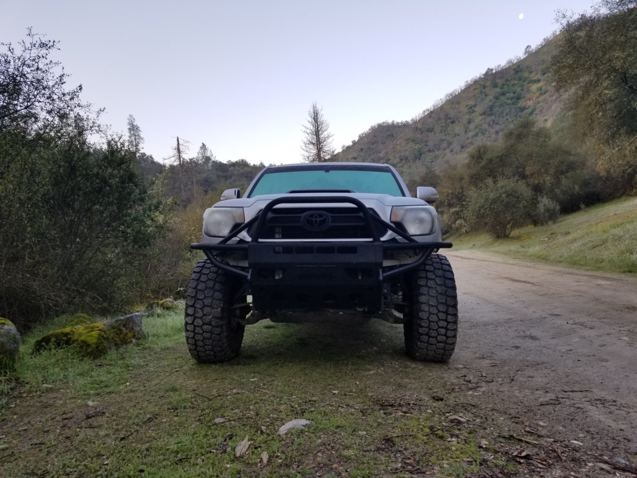

    BruteForce Fab hybrid steel front bumper

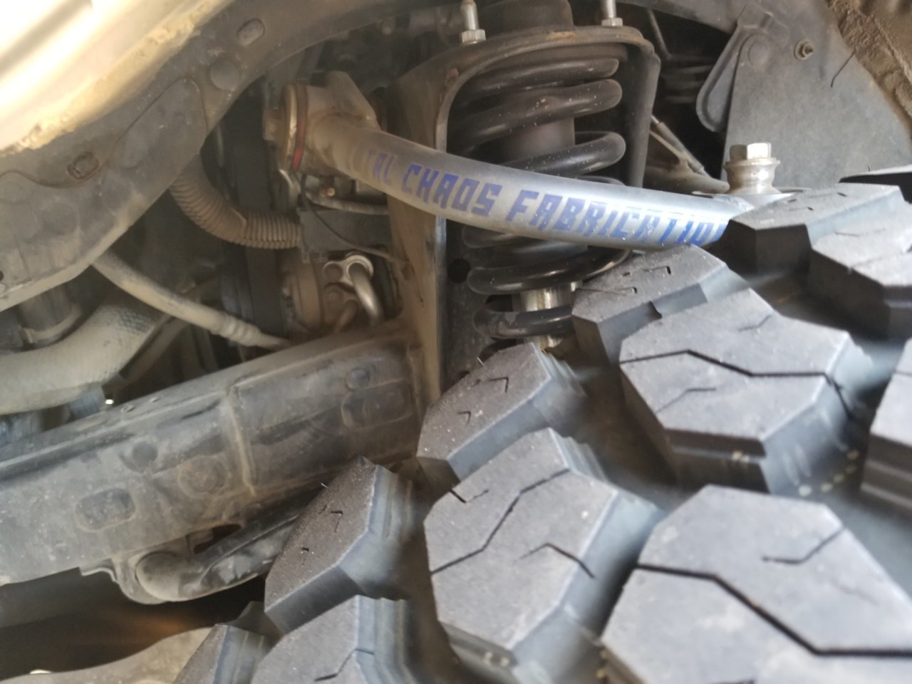

    Total Chaos Uniball UCA's
    Bilstein 5100s
    OME 887s set to 2nd notch

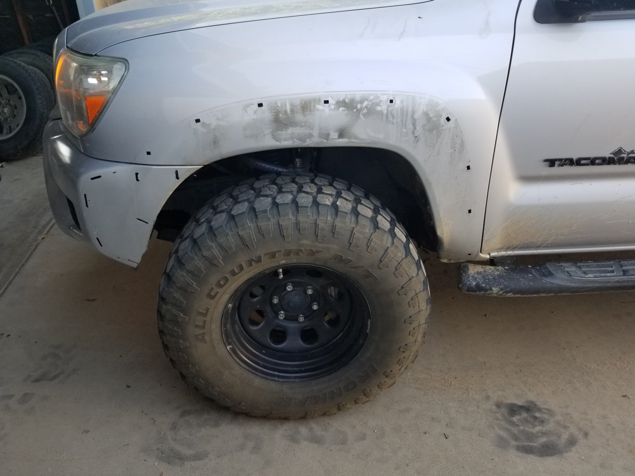

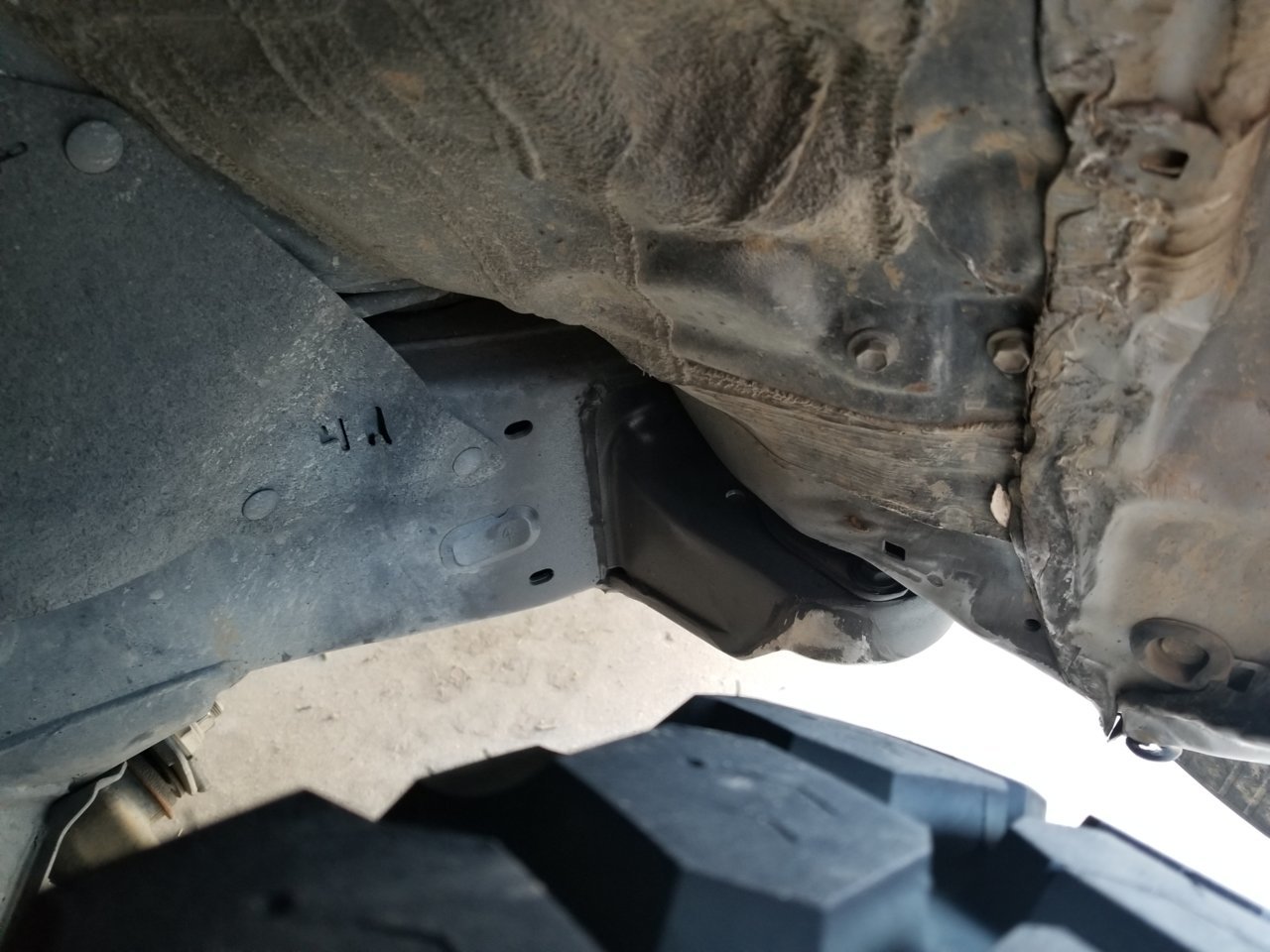

    Cab mount chop (still rubs a little) hammered in the pinch weld as much as possible.
    17 inch procomp steel rims with -19mm offset and I think 4.5 inch backspace. Removed plastic from fenders because they rubbed and it was annoying me lol.

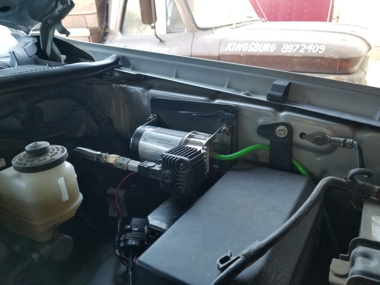

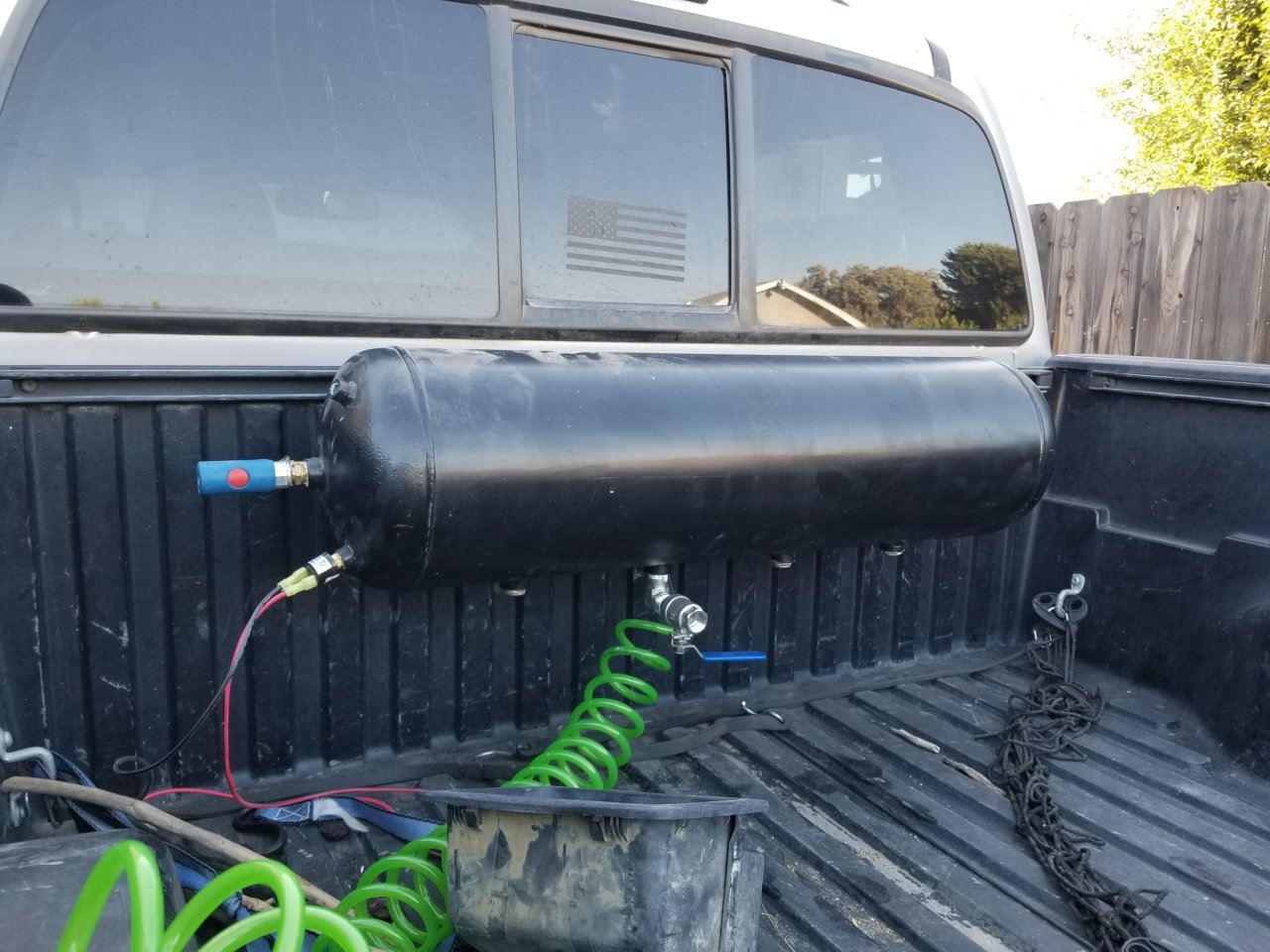

    20180622_181546.jpg 20180622_180909.jpg 20180622_180854.jpg 20180622_180809.jpg

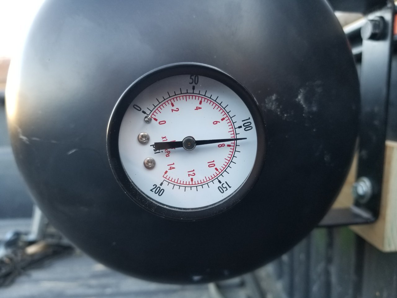

    On board air with an 8 gallon tank and a cheap firestone air bag compressor. System is set to 120psi. Haven't tried it for air tools yet, but this system airs up my 35 inch tires from 20psi to 32psi in just a few minutes.
