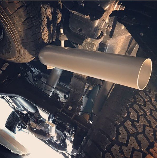

    Its the rearmost hanger, I had to cut about an inch off the end of the hanger so I could get the forward hangers on the rear section lined up and not have the hanger in the rear tapping the mount for the leaf spring right next to it. Itll make since once you look under there.
    Luckily I caught it when I was installing so I hacked it off before finalizing the installation...
