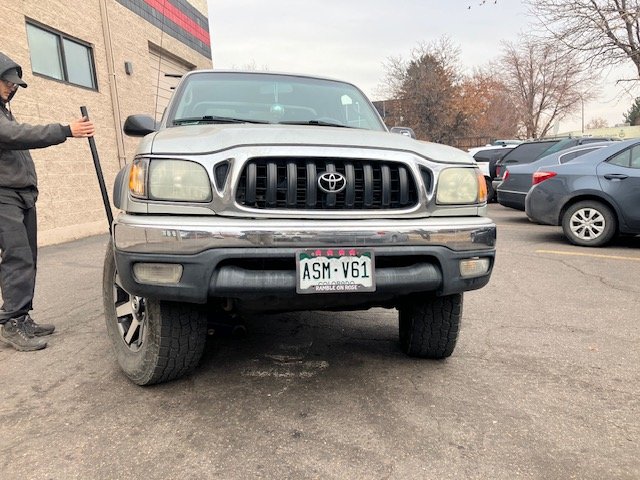

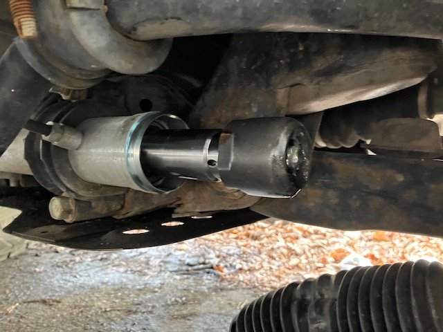

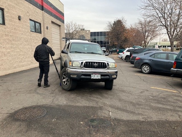

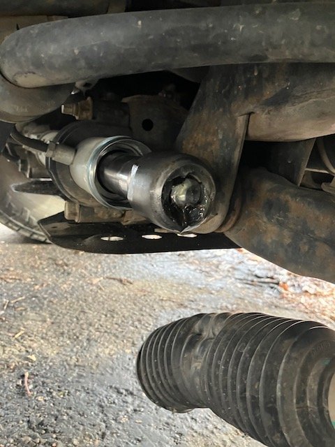

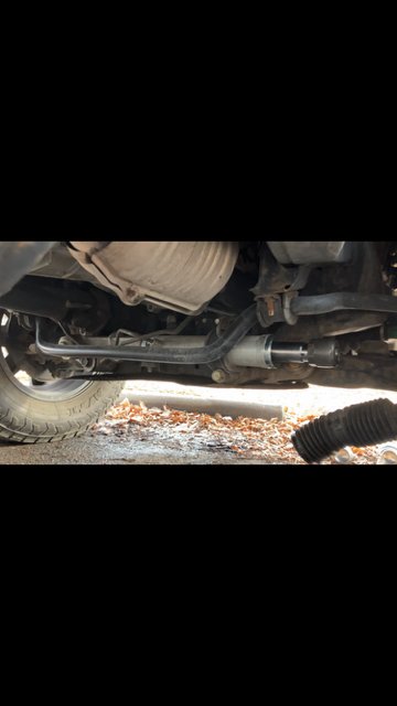

    went in for an alignment and tire rotation this morning. as big o tech reversed from the space i parked in, passenger side inner tie rod failed. snapped right off. the steering rack is new as of <10k miles ago. im glad this happened in a parking lot where it can be fixed and not on the highway or remote mountain pass. i drive like a grandpa so i suspect this is cheap parts and/or a bad install on the rack. have a warranty on the work for the rack so i will be going back to them with the broken piece to fight the good fight. new inner rods, moog, going in on both sides. happy friday ya'll!

    So it snapped while in tension......while drawing the knuckle back in...
    out of curiousity....how old are upper/lower ball joints.....have those ever been replaced?
    any chance those are binding up....
    what motivated you to get an alignment in first place....were there any signs?

    did new inners and outers when it happened, both sides.
    upper ball joints, originals, were just inspected and deemed in good shape.

    Did you happen to buy a NAPA replacement rack? Had one and found inner tie rod failure within 1k miles.
  13. Jan 31, 2024 at 6:26 PM
    xmon
    xmon [OP] Member
    Oct 13, 2023
    #435401
    9
    xavier
    '04 SR5 5sp
    Cardone
