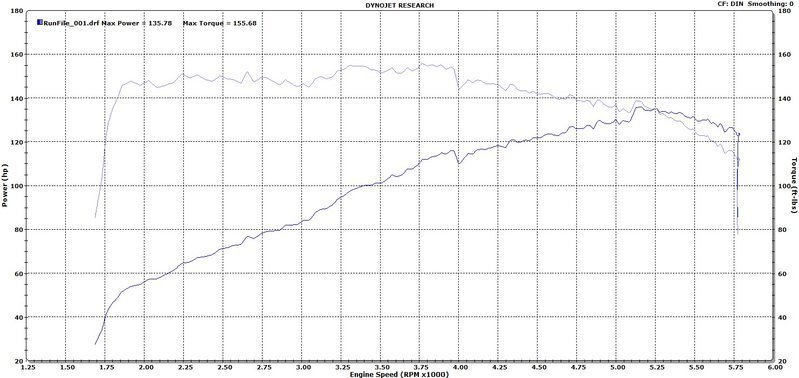

    It does have 94% of peak torque around 1,900 rpm, at least there's that :benchpress:

    Haha I guess so. That would be great if I never had to go over 35 mph.
