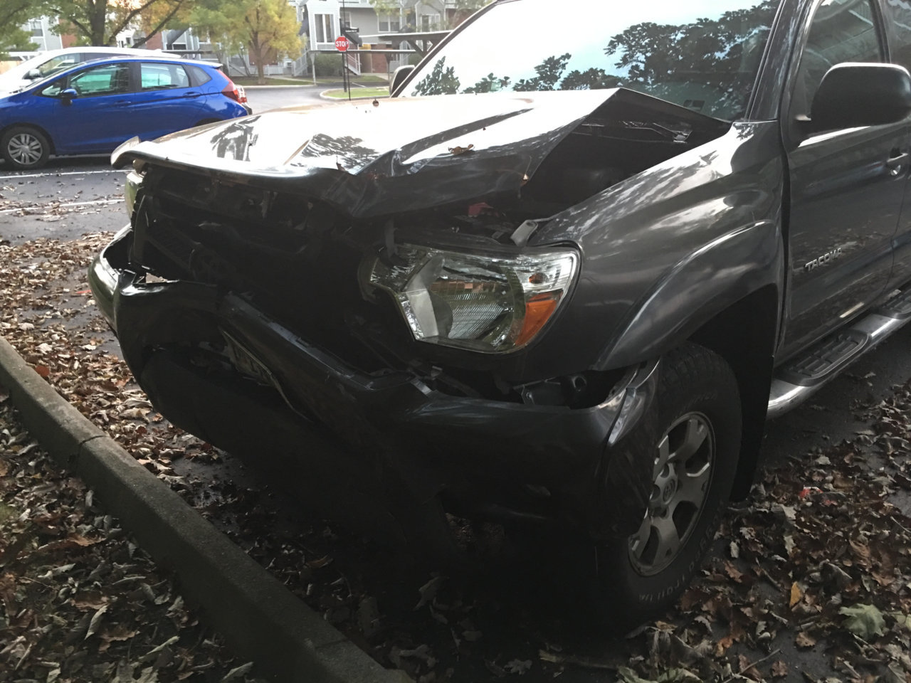

    I am having a devil of a time tracking down a squeak in my engine that is getting worse. It's actually worse now than this video.
    I was hit head-on by a drive-away drunk and left with $13k damage. (attached image)
    The bumper was pretty well V-shaped, the radiators had to be replaced.
    Could an impact on the fan shaft damage the water pump pulley or the water pump itself?
    There was no squeak in any of the pulleys out of the body shop, but the squeak developed over time. There was also a rattle in the tensioner pulley that has since gotten fairly bad.
    I am going to be replacing the crankshaft pulley due to some wobbly asymmetry there. But I don't think the crank pulley can squeak because I don't think it has a bearing, right? So something else is at fault. All the pulleys seem smooth when I spin them by hand with the belt off.
    Could there be something underneath the fan shaft / water pump pulley that is squeaking?
    I am concerned that this thing could fail in the next week or so if I keep driving it without fixing it. But I'm having trouble zeroing in on it.
    Thanks for any insights.
