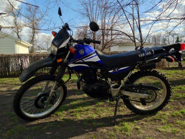

    I'm home! and only have a month to make progress before I leave town for six weeks.
    Here's my canvass:

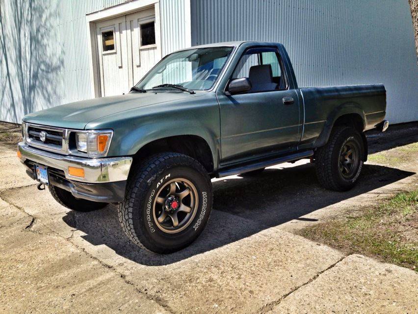

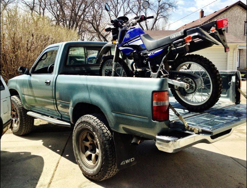

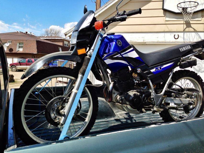

    Topper is off for the first time since I've owned the Pickup:

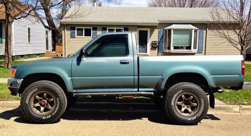

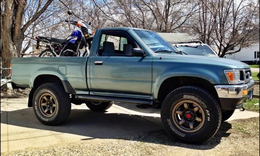

    Bike is loaded up:
    Took it to the shop for more room to work:

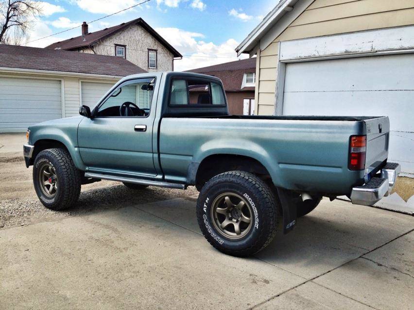

    Man, Truck, Bike:
    Cleaned off my dusty gear:

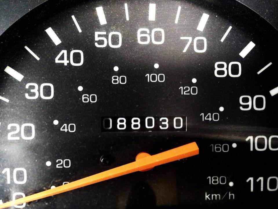

    Finally broke 88,000 :cool:
    And one for the road:
