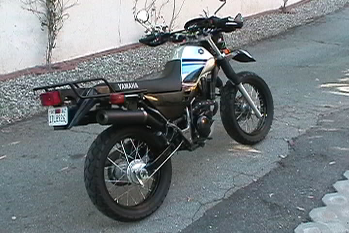

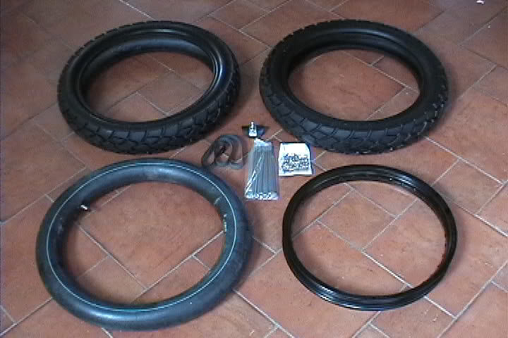

    Hey, that was my bike years ago! :)
    I'm the one who made it into a supermoto.
    This is the supermoto kit I assembled.
    It worked great!
    I ride a 400sm now... with the same milk crate. :p

    Just in case, I searched and found the full story on my xt225 motard conversion. It has every single detail with lots of pics: :)
    http://www.xt225.com/forums/ubbthreads.php?ubb=showflat&Number=5824&page=1

    Those kinds bikes are really cool, but they were totally out for me because they're way too heavy and I'm only 130 pounds. I lowered and lightened my 400sm down to 301 pounds running weight with a full tank of gas. Bought it brand new in 2007. It has 28,000 miles on it.

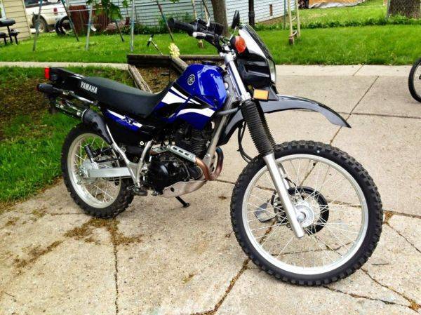

    Should have these all done this evening or tomorrow at the latest :cool:
    Stage 1:
    New battery [done]
    42.5 pilot jet [done]
    130 main jet [done]
    Idle jet screw 2.5 turns out
    Shim jet needle with 1mm washer
    Adjust air screw
    UNI air filter
    Flush fluids [done]
    Clean carb [done]
    Grease chain [done]
    Edit: I've decided on the Michelin Pilot Activ tires in 130/80 and 110/90. :yay:
    I'm also likely going to drill a hole in my exhaust (known as the Z1 mod) for a little more pep after I drill out the brass plug to get to my idle screw. I don't think I'll be taking out the snorkel though. We'll see.

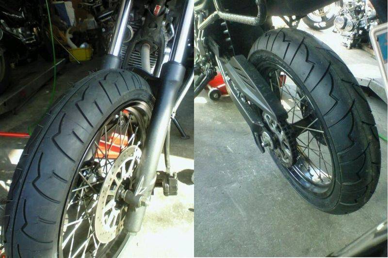

    Here is a picture of the front and rear Michelin Pilot Activ tires I'm going with:
    Only downside is that they only come in the size I need (same with BT45s) in a V speed rating rather than H. Considering I'd be lucky to break 80+ mph I really don't need that and would prefer the H rating, but oh well. From what I can gather I shouldn't run into any issues because of it.
    I may skip stage 2 and jump directly to stage 3. It is much more exciting :D

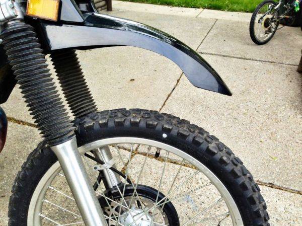

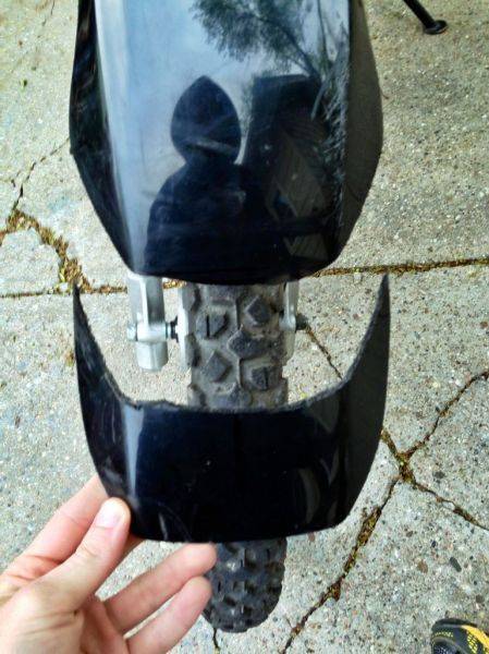

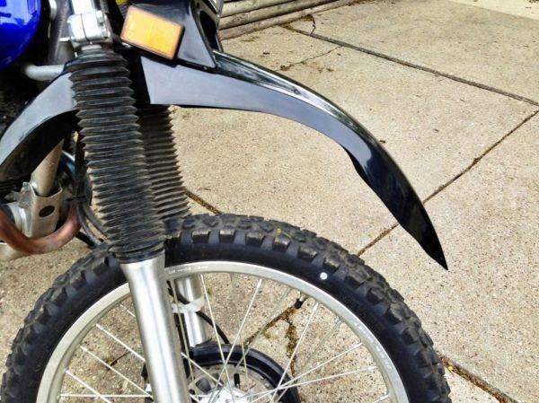

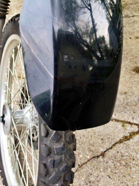

    Well, I haven't updated this much . . . Because I've been riding :cool:
    Not much to show, I did trim the fender today just because I felt like it . . .
    I drew in the new lines pretty similar to the old, but right how I wanted them:
    Here's the rough cut before filing it down nice and smooth:
    Stocker profile . . . derp:
    Rough cut, before final shaping and filing:
    I liked the stock shape and wanted to keep that widest point so I just bent some lines to make it work and look the way I pictured it in my head.
    Here's the final product :D :
