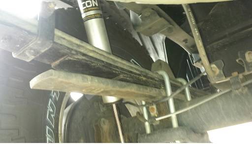

    Hey guys,
    I'm in the process of installing a Wheeler's three-leaf add-a-leaf set. My truck is a 2011 TRD Sport Access. My stock leaf springs are two regular, plus the overload.
    I want to leave my overload on, but I'm now not clear where the three leaf pack goes in relation. I'd been assuming that it would go above the over load, but the middle leaf of the three-leaf is the same length as the stock overload or slightly shorter, and the small (lower) leaf of the three-leaf is considerably shorter than the stock overload.
    Do I install the three-leaf pack on top of the overload, under it, or do I split it up and do the small leaf under the overload and the other two above? Or something else I'm not thinking of?
    My project is on hold until I can get this figured out, so I'd love some quick help. I appreciate any advice, but for what it's worth, I'm keeping the overload in.
    Thanks, guys

    this is how mine is set up. hope it helps.

    Thanks, Tanselow, I was able to dig up another member's photo who did the same. I installed mine like that and the ride is great.
