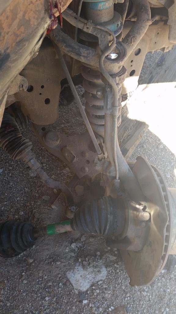

    I went off roading this weekend to the Bloody Basin Trail and the Sheep bridge for those of you who know the area here in AZ, and we had a little bit of trouble coming back up from the bridge. Needless to say we had a 5 hour wait on the side of a mountain until a friend came to pick us up, and I had to wait a day for the tow truck company to get my truck out of there.
    My insurance has covered the towing and said that I should take it to a repair shop and all I will have to do is pay my deductible ($500) and the truck will be fixed. I do the work to my own truck, usually with the help of a friend, so I normally don't take it to shops. I have had it towed to my friends house and it is sitting there for the time being until I decide what to do.
    Has anyone been through this? I have looked, and I remember seeing a first gen sitting like mine, but I can't find it now. I just need to know if I should call out the adjuster to look at it and give me the estimate or if I should fix it myself as I intended to do? Do insurance companies pay out for these kinds of things, or is that only if I take it in to a shop for repair? I have never been in this situation, so I am slightly ignorant when it comes to insurance. I just don't want it to be totaled out. I personally don't think it will be, but for the insurance company I am not sure (it has 269,000 miles). If any of you have ideas or have been through this, please let me know what you think I should do. Thanks in advance

    Looks like a lower ball join failure, pretty common amongst our first and 2nd gen tacos. If the LCA is in good shape, I'd change the LBJ's on both sides and uppers as well.
    Edit: No way it's totaled, the damage looks worse than it is. You need a new fender and flair which are common and all over CL since people upgrade to fiberglass.

    It was the lower ball joint that failed, but it didn't look as though the spindle and lower control arm are bad. I have all-pro upper control arms and they look to be okay, however I truly won't know until I take another look and get the wheel off.

    You were going slow when this happened I'm assuming , but the damage looks worse than what it is , the CV axle is where you'd expect to find it it just pops back in but check the retainer clip/ring to make sure its not flat on edge, should be round, other than that I'd throw it back together & drive it while looking for the other pieces needed no big thing really
    Just replace BOTH sides & get alignment checked at least when done

    Yes, be sure you get the other sides LBJ replaced as well. Since this one has failed, the other could go at any time. And I guarantee you they wont total it. Especially being a 4 door, they are worth a bunch haha
