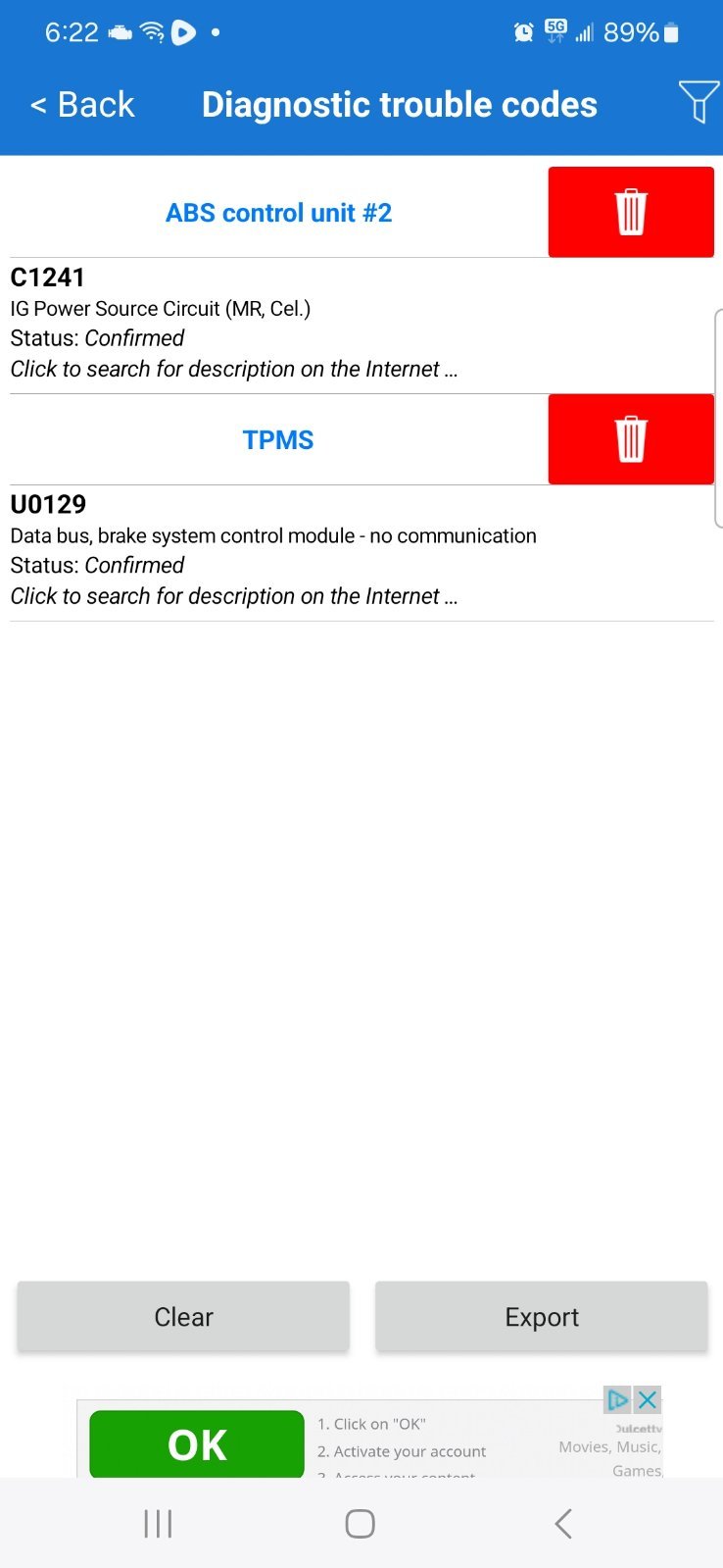

    we bought a new battery, and the truck started as normal, but when he left and I put my OBDII scanner, I got these error codes :
    U0129 [0xC129]
    Data bus, brake system control module - no communication
    Status: Confirmed
    C1241 [0x5241]
    IG Power Source Circuit (MR, Cel.)
    Status: Confirmed
    I have driven the truck for 15 minutes, the check engine light is now gone, and my dashboard doesn't have any "funny light".
    My question is, could there have been a "SHORT" somewhere at the back cause by the water, and will that cause a problem later?
    I'm not blaming the guy, I just wanted to know the possible cause so i can avoid it next time and know what to expect from now.
    Thanks

    Sounds normal.
    Battery went weak.
    Truck detected weak battery.
    Threw code for low/loss of power. (as it should)
    Carry on, nothing to worry about.

    Pretty normal for low voltage and communication codes to set when battery voltage is low so I wouldn't be too concerned about it.

    Forgot to mention, this is an almost new Tacoma with only 3k miles on it, bought from new... my worry is if there was a "short" somewhere on the back seats where the sound came from?

    Hi all, just want to update this thread, I bought a new battery, the truck worked fine. I then bought a Noco battery charger and charged my Toyota battery, then put it back on the truck... no problem.. so it was just the battery completely depleted. Thank you all for your input.
