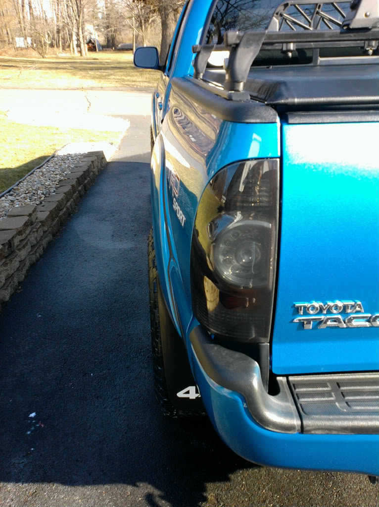

    A lot of guys have a similar set up to this. Also, it's not 2.4 inches past the fenders, it's 2.4" past the stock wheels which are currently well inside the fender. They will be about 1-1.5 inches past the fenders I believe. I went with a 17x8 wheel with 4.5" bs to try and keep it a little closer to the same as the fender width. Mine still stick out a little but not much.
