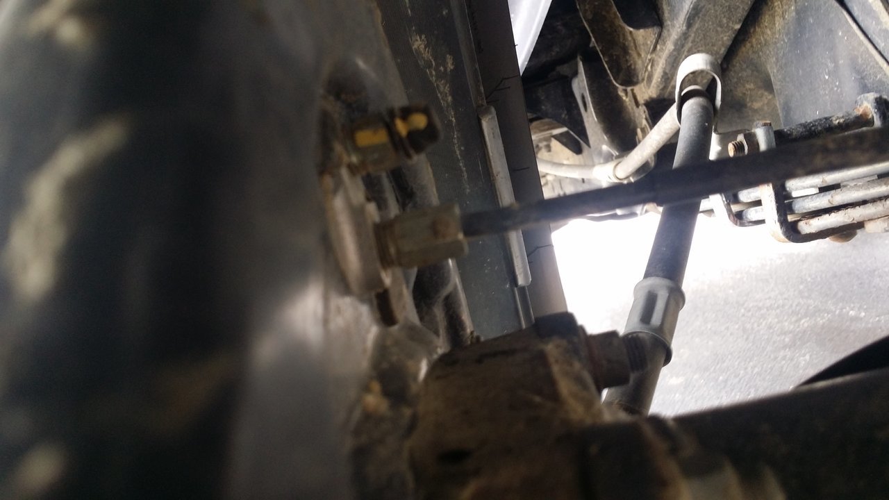

    Ok went out to my truck to grab a pic. Note all steel after the center hose. You can see how tight the cables are woth only about 2" lift. No tension on brake lines though because they are mounted to the axle

    You have your e brake bracket upside down, that's why there's so much tension.
