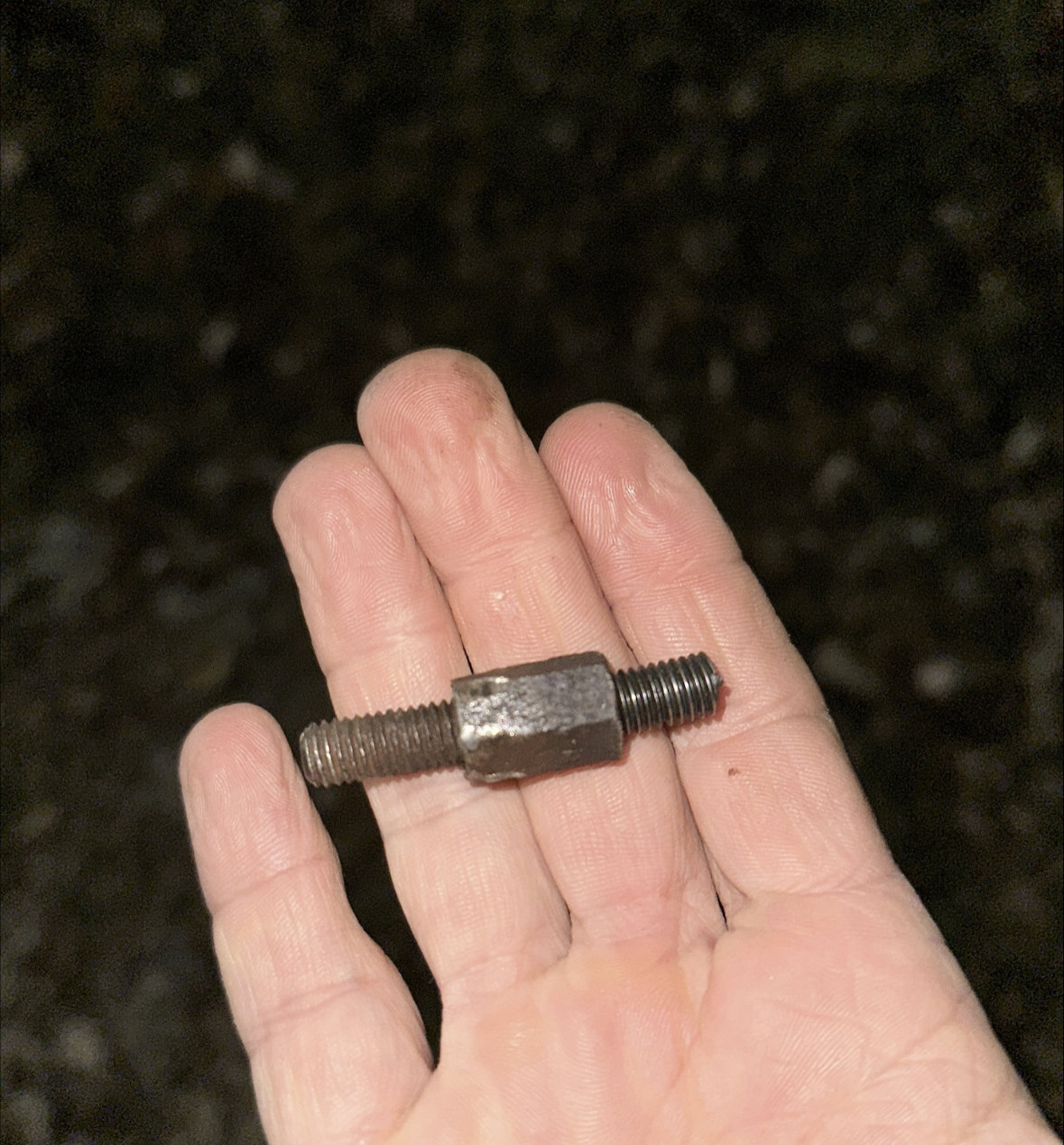

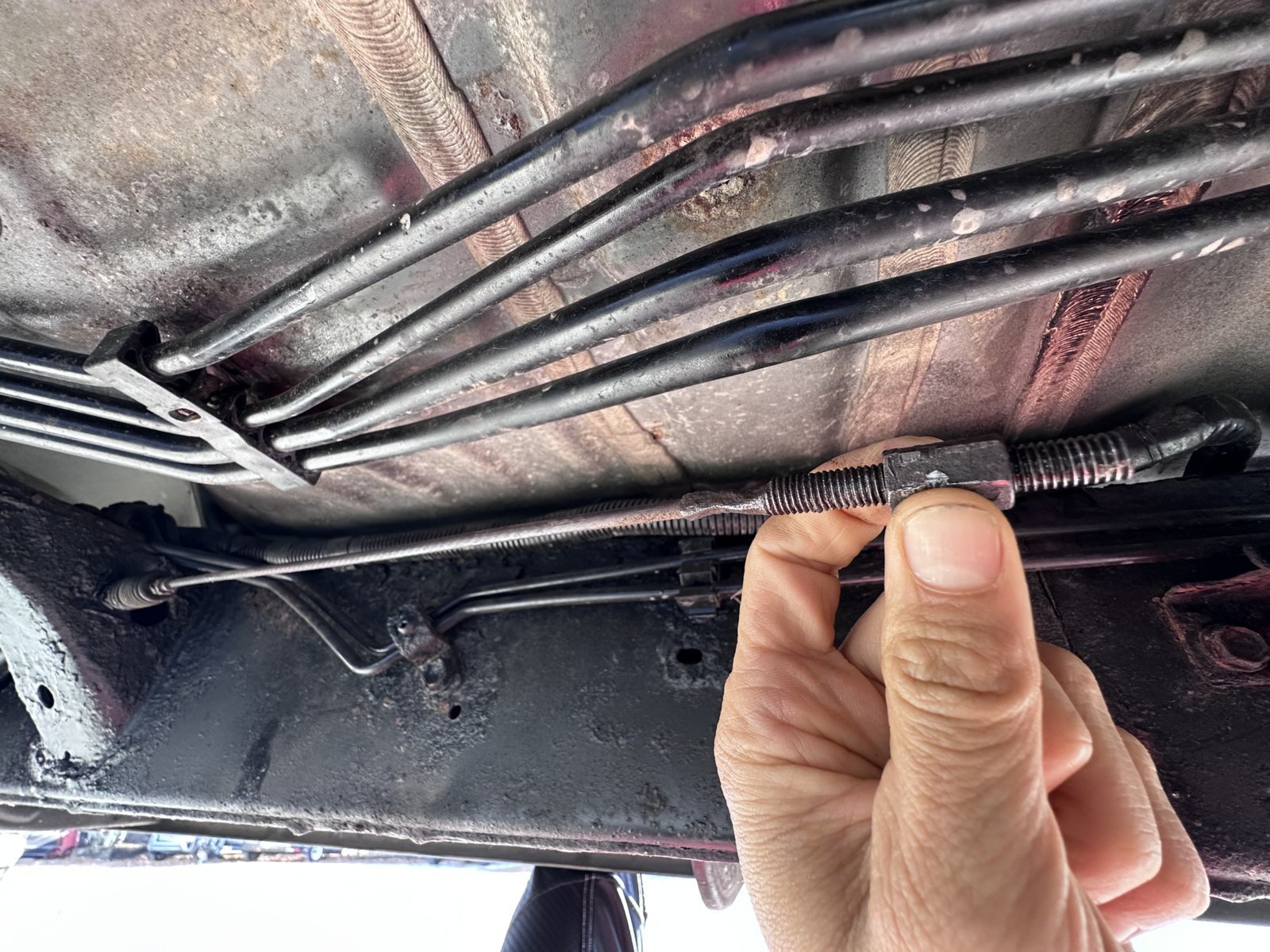

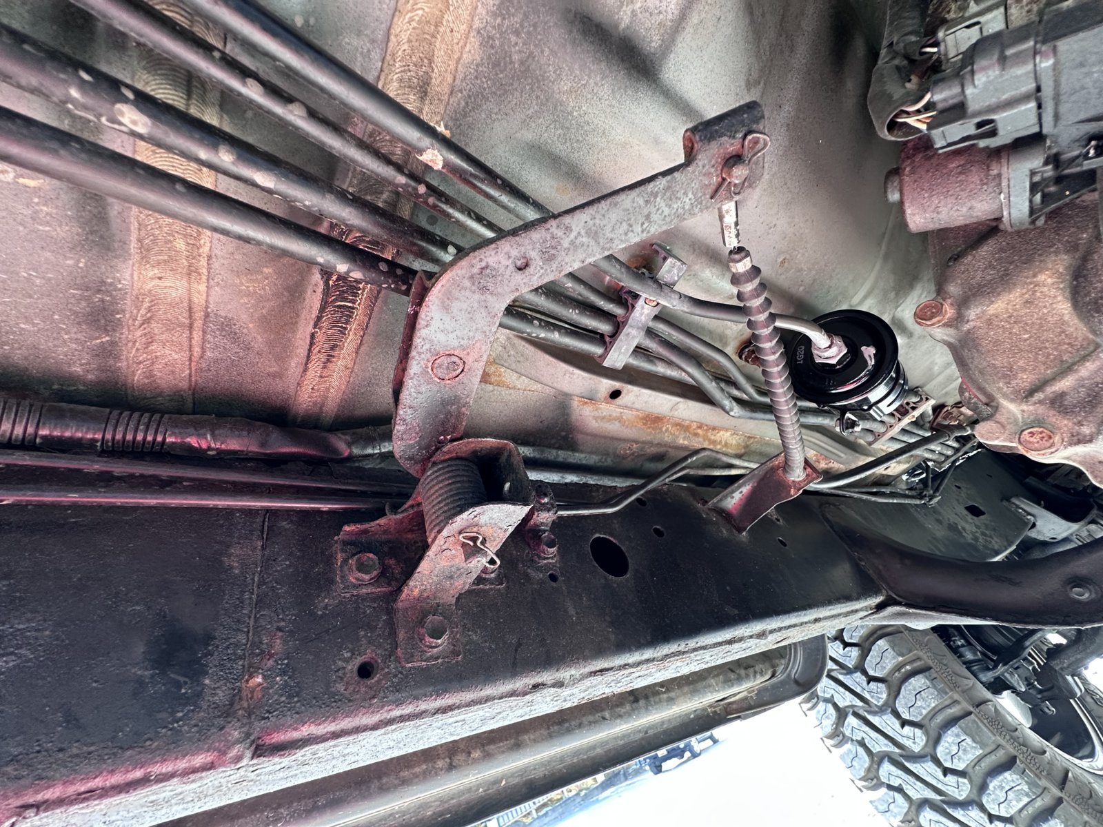

    Can someone helping me out to find out what couple size nuts that I needed it thank you so much it has broke of I have ordered the new one however it didn’t come with the couple nuts

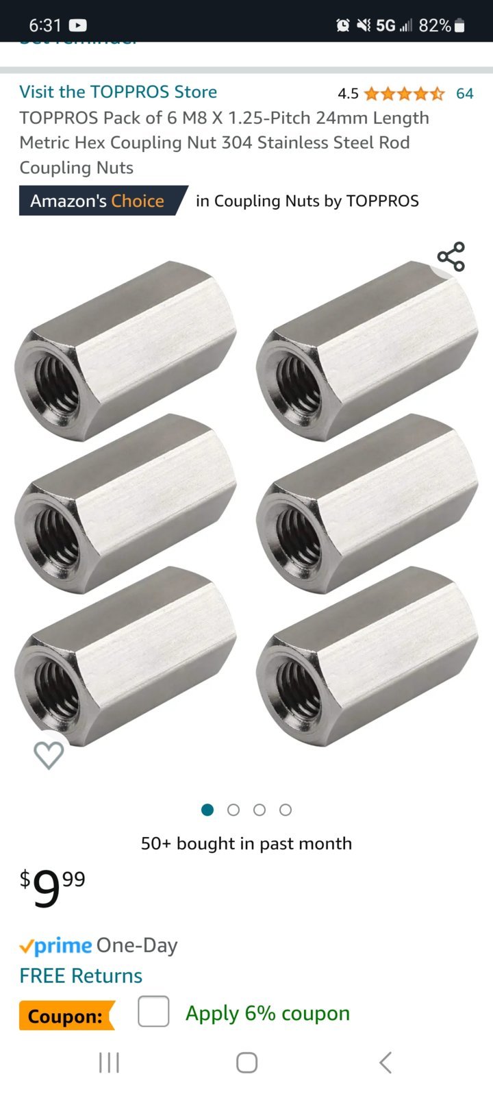

    These work for me

    Yep, those are the ones, M8 x 1.25, had the exact same issue with mine. $7 on Fleabay. Be sure you take the lever all apart and grease it up good. In my case it was the brake wouldn't fully retract when released and the brake light stayed on, turned out the front cable was slightly stretched, not the rear. Might as well replace that one too. :-D
