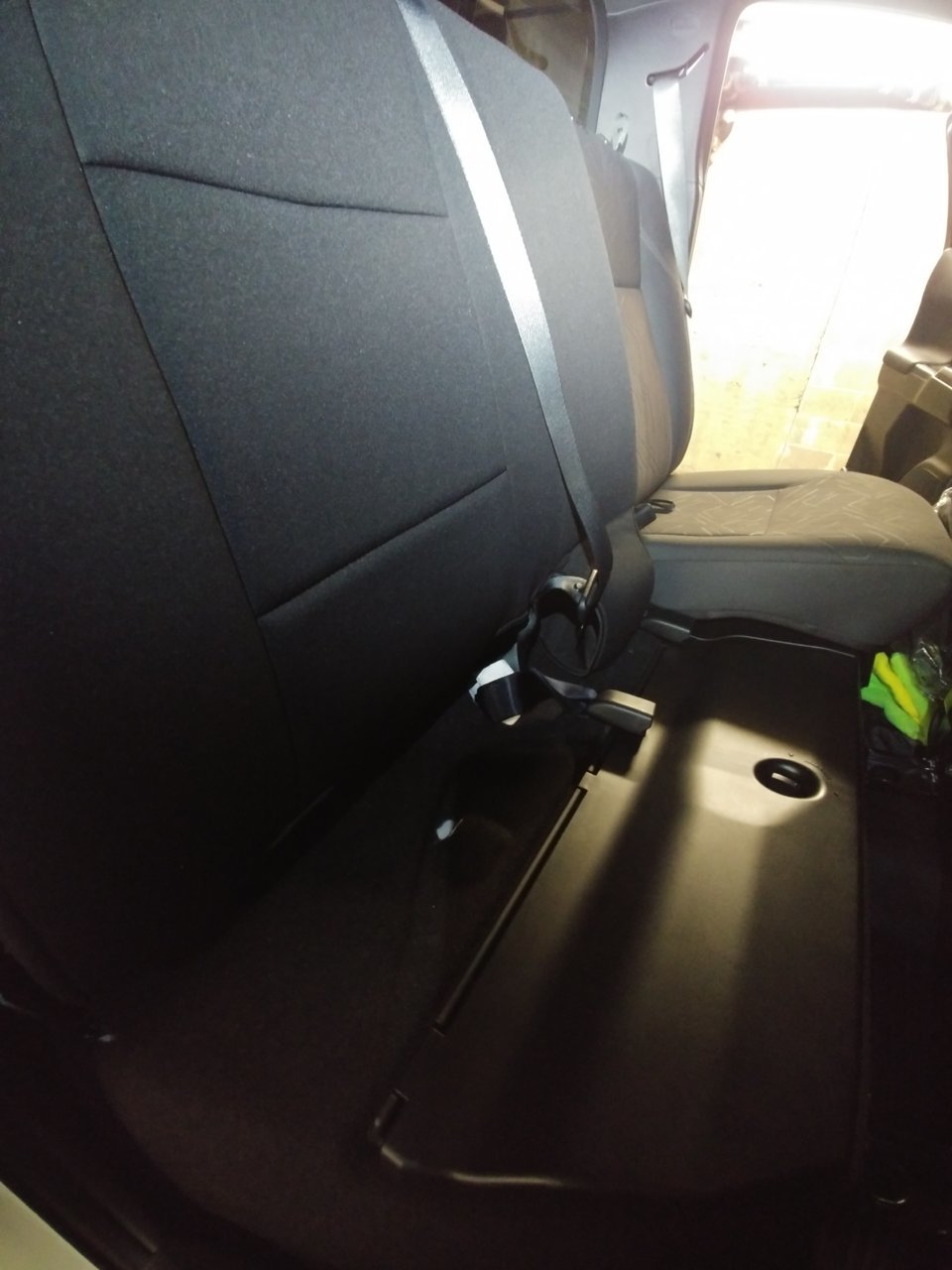

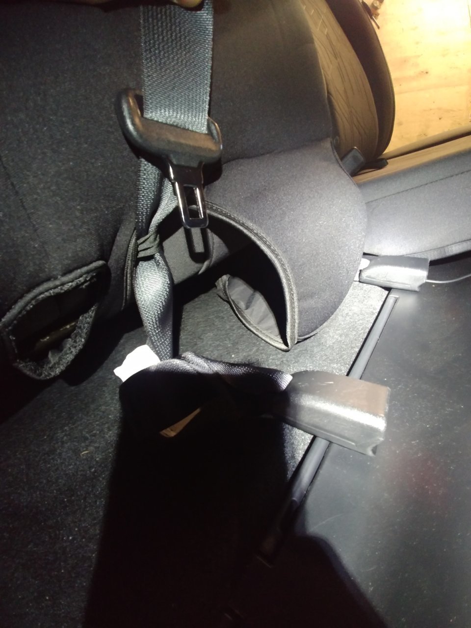

    Just trying to install these coverking covers.
    I feel like there is an issue with the securing fabric loop that retains the seatbelt.
    It seems to be stopping the holes with the brackets that I guess are for a car seat? From lining up.
    Anyone got tips??

    You have to unbolt the seat belt from the bottom and slip it through the original covers loop. If the coverkings have a loop, pull it through that and re-torque the bolt down really tight.

    Thanks ...thats what i thought...nothing bout it on the install vid lol
    No loop on new covers
