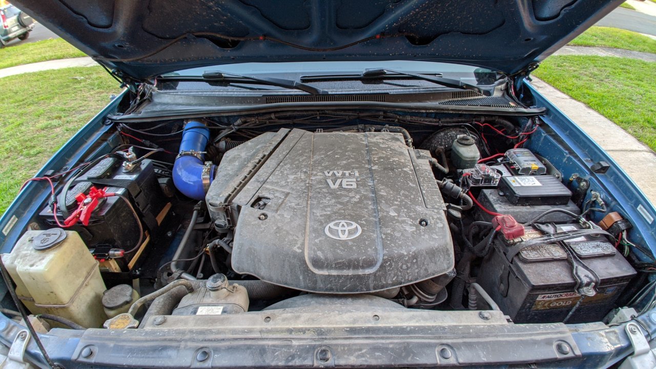

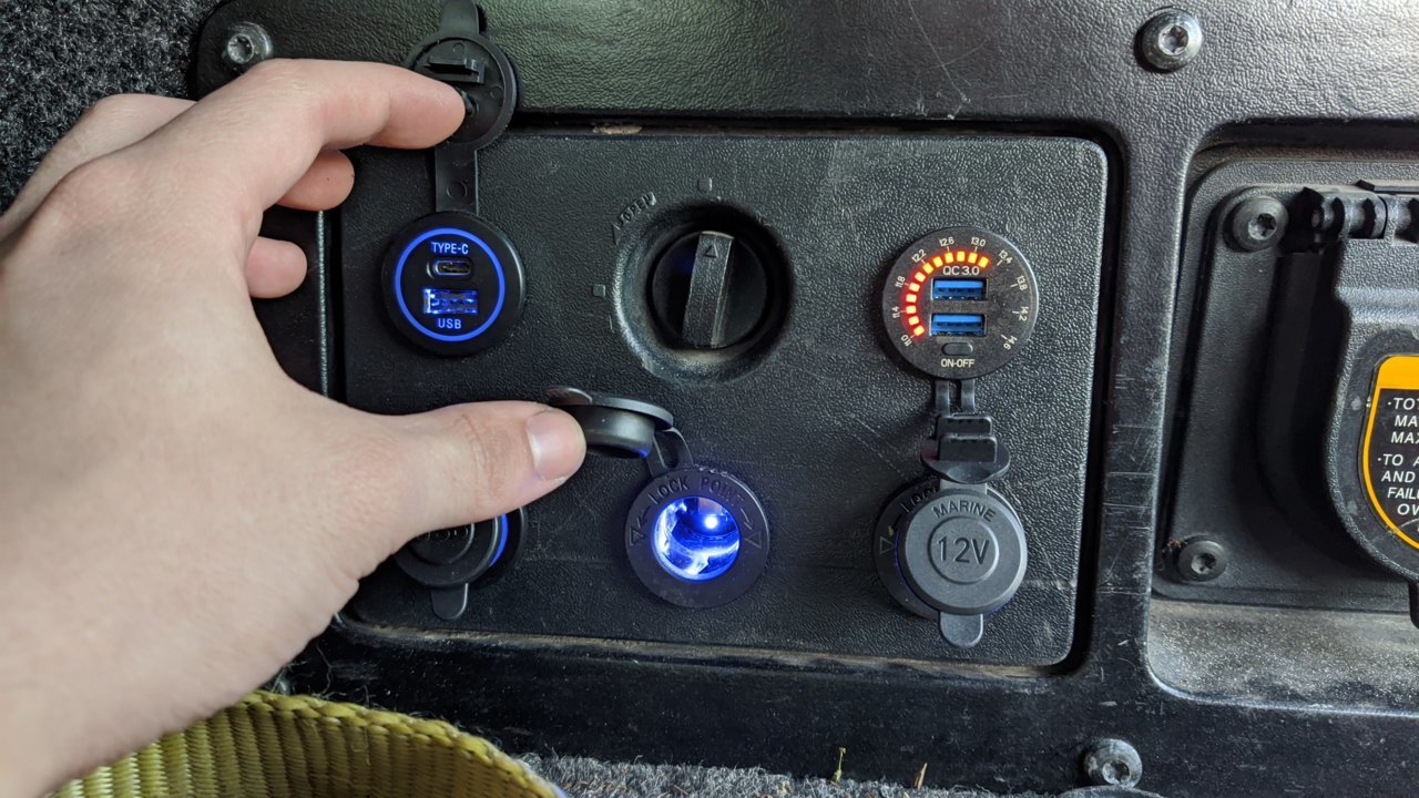

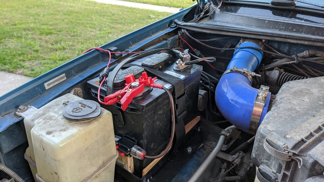

    Welp, 4 months later I finally did it. Started my initial dual battery setup using a 24DC battery because honestly I don't need much more than that. Have to add a VSR to connect both so alternator will charge my 2nd battery and also give me the ability to jump myself if ever needed. Also added a power panel in the rear for recharging any devices that I could have (2 USB C, 4 USB 3.0, 2 12v Sockets) with one of the plugs having a voltmeter so I can know battery life easily.

    Anymore info on that second battery? What tray? I have the same intake setup

    Using an Amazon $8 24DC battery tray that's bolted to a 14AWG steel plate that's mounted to 2 brackets to hold it in place. It's not my best work and I'll possibly finish it out nicer in the future but i'm lazy right now and it seems to be working fine so far. I've driven around with it without any issues and can manually try pushing around and it doesn't go anywhere so i'm content with driving around as is at the moment.

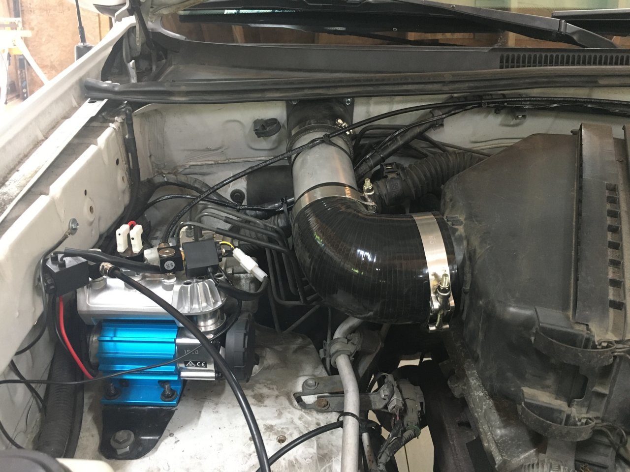

    I've done one for Gen 3, and it came out perfect. It is a more complicated job because the airbox is harder to plug into. You also need a flex connector for cowl attachment because the
    tube comes in at an angle. I created TIG welded aluminum adapters to make all this easy. The end result is clean and the modifications to the cowl are very similar to Gen 2. This is probably not an appropriate conversation for this forum, but PM me and I might be able to help you out.
