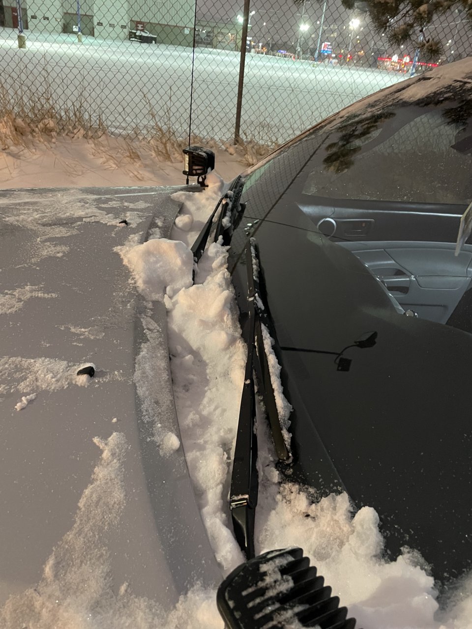

    Hey guys, I've been thinking of doing the cowl intake soon.
    BUT...
    One of my concerns is snow build-up on the cowl. How much wood this affect the engine intake?
    The picture below is what my (and everyone in the city) cowl looks like most of the time in the winter.

    Well, I live in an area that gets snow accumulation and my Truck sits outside the garage, and it's not been an issue for me.
    Keep in mind that your cowl has air intakes that also lead into the fender, and if you take the extra step to open up the other side, both fenders. So you shouldn't starve for air. It's why when it's covered with snow like that you can still pull fresh air in from outside via your climate control.

    Don't worry about that snow.
    -Montanan with the mod done

    I understand that the heater works fine with the windshield and cowl full of snow but I feel like it blows harder when cleared out. Maybe it's just something I made up in my mind lol
    With the cowl intake, I will make sure I keep the area a little more clear but it's just a PITA.
    I will drill some extra holes for sure and add some screens.
    How do you find the noise? I read that some say you can hear the intake from inside.

    I don't notice it. But I also drive with my windows down and stereo up a lot. Plus since I removed my jump seats and back panel, I hear noise from the cab vent more often than any noise I'd hear from the intake.
