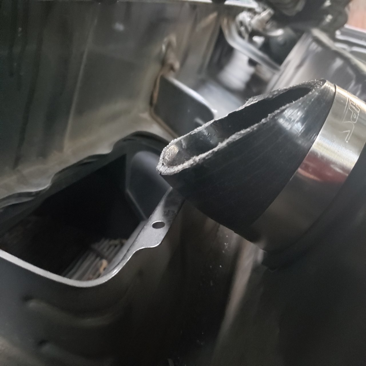

    For the holes in the cowl side walls, its pretty obvious where to drill. For the elbow on the intake, I bought a 45 deg elbow, put it on the end of the pipe, then drew a line where to cut. If left at 45 deg, its too close the under side of the cowl cover

    45 or 90 elbow?

    45

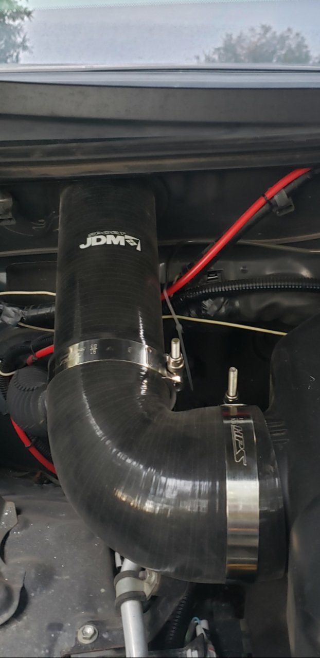

    interesting, most I’ve seen posted are using a 90. That’s what I got too.

    Also, I was able to find a 12” silicone tube, so I’m going to try this again. I’ll post pics when I dig into it for some pointers from everyone.

    The 90 degree is for the turn from the air filter to attach the straight pipe that goes through the fire wall. The one im talking about is at the end of the pipe inside the cowl. As far as i know, no one else has done this. It just adds a little more protection from water getting into the intake should the cowl flood

    Gotcha okay. That’s smart, wouldn’t have thought of that.

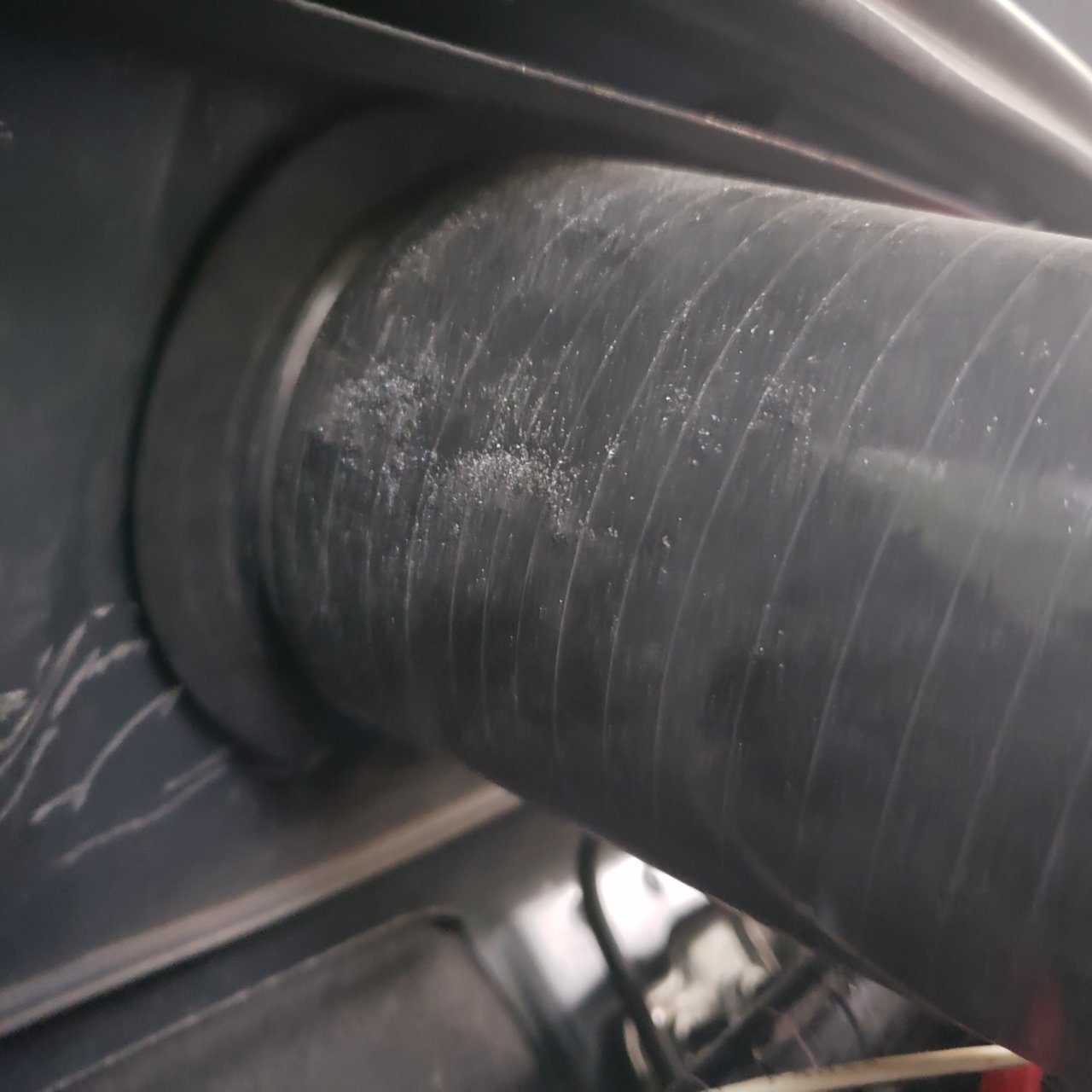

    I'm 5+ years in with no issues so far. The felt I used is heavy "furniture felt", which Home Depot sells in small sheets with adhesive backing; it's about 3/16" thick and takes 4-5 passes with a razor knife to cut it to size since it's got so many layers of overlapping fibers running in all directions. The number of pieces and locations I stuck it have everything wedged together tight enough that nothing moves around significantly, and there's not likely to be the kind of sawing motion that would be needed to eventually wear through the pads. I was actually more worried about the sharp edged on the hole pushing through the kinds of rubber seal material that I was able to find - mostly foam rubber weather stripping, nothing like a good solid gasket.
    My alternate plan was just to wrap enough layers of duct tape over the end to make it fit tight inside the hole, but it would have been dozens of tedious fit-checks to keep putting it back in and out then putting the intake horn in and out every time, plus I couldn't figure a way to allow for the hose clamp holding the horn in and there isn't room to run that hose in from the back side.
    If I only had the silicone hose at the bulkhead/firewall I probably wouldn't have even bothered with the felt because I wouldn't have heard the rattle caused by the aluminum intake horn that I used contacting the edge of the hole.

    you think just running the silicone through the firewall with no edging is okay? That would be awesome for me if I could do that. What about then putting a bead of silicone around it?
