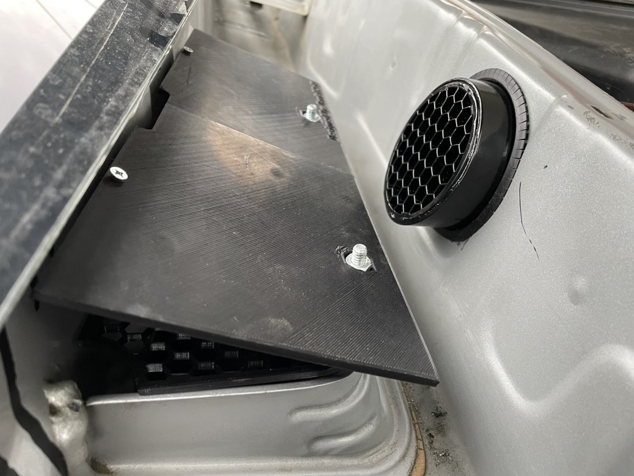

    I wonder if that small of a screen will restrict the flow?
    I thought about using a screen of some kind but I decided to challenge myself and design something.
    I think this can become a product that people will be interested in. I am too busy these days to finalize the design and get some printed. This might be a good winter project!

    That's why I printed a screen for my intake too :D

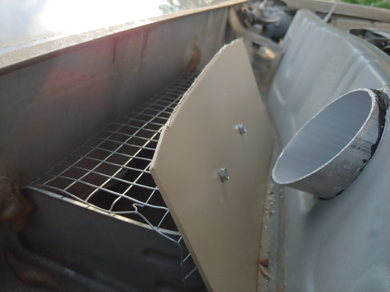

    I just used hardware cloth over the A/C intake, and a piece of Kydex to act as an air dam to separate the two. The intake itself has its own filter and I haven't seen anything in it, even though I had a bunch of crap in my cabin air filter at the last oil change.

    How did everyone mount their air dam? Dpele has the plastic to get some bite on. I’ve got a perfect sized piece of aluminum and was gonna use some self tappers and aim for the holes in the bottom. Might be kinda loud though. Maybe just glueing the aluminum piece in would be better?

    I'm mad that you made me go look up pictures from two years ago. Mostly because I have to look at my functional but ugly attempt. This was prior to my move over to Spectre duct.

    lol, sorry to make you relive old nightmares. Those are self tappers as well into those two little flanges? Did you bend them for a better bite?

    Yes and yes. And even given that I didn't go to the extreme of setting up a complete cover system that FORCES air to be retrieved from the sides instead of from everywhere, I do not have extra noise in the cab that I am aware of, and the A/C has no issues with breathing I can find.
