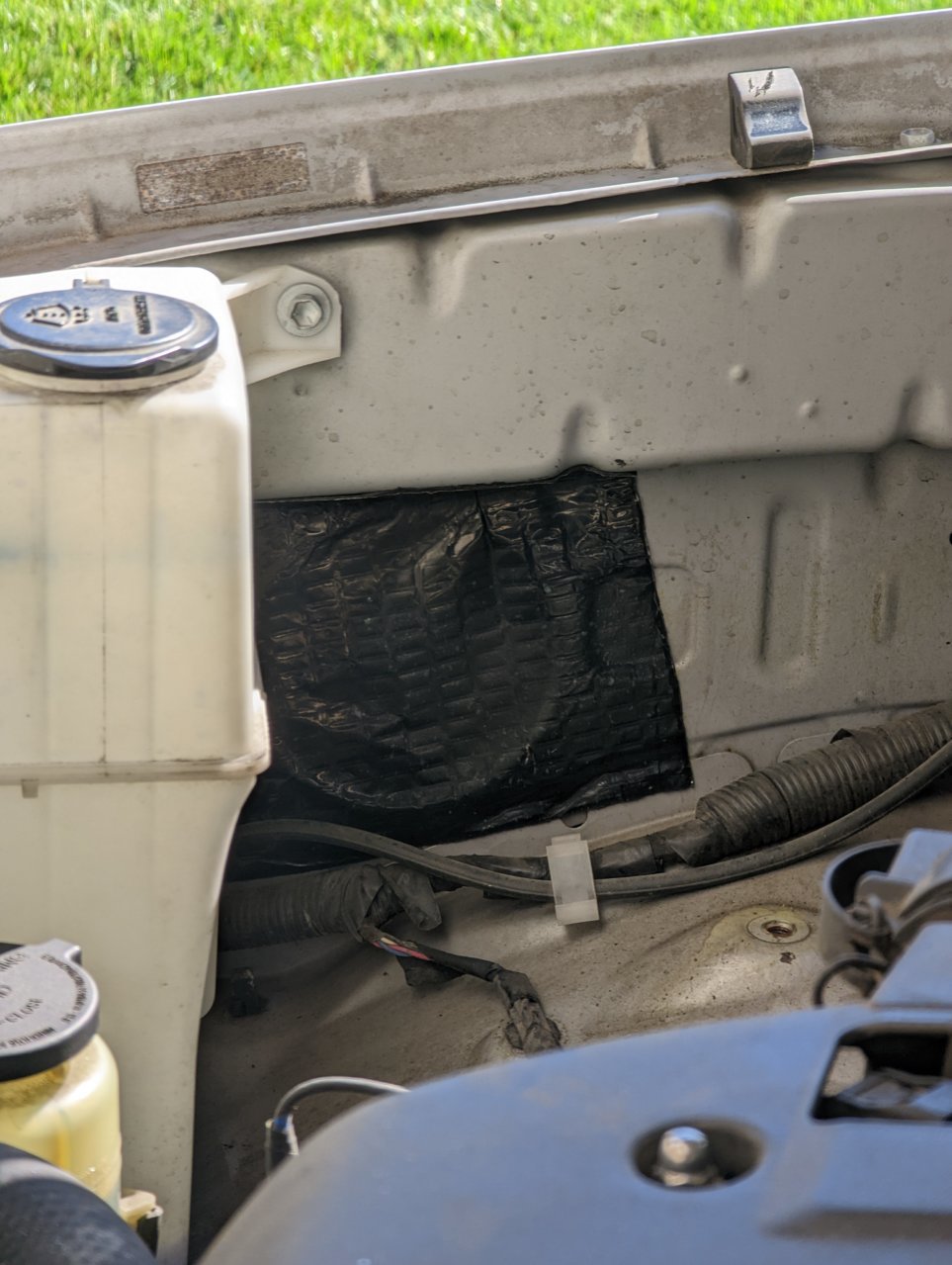

    What did people use to cover the hole left behind from the old air intake?

    Gorilla tape I think? Maybe I stuck a PVC cap into it and gorilla taped over it. I forget, it's been a long time.

    cool tape it is

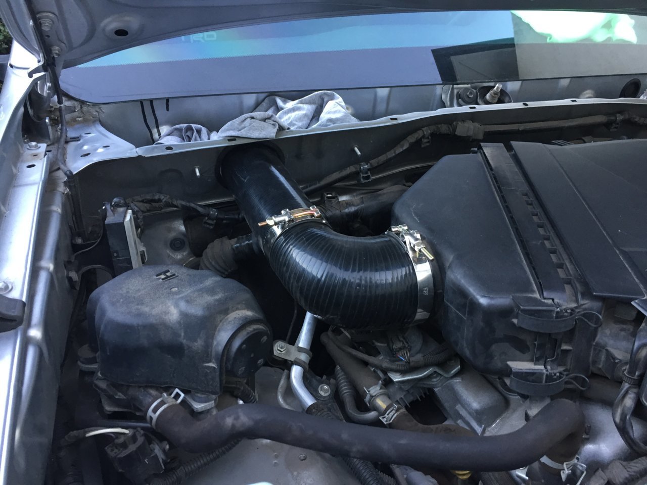

    Where are you guys finding a 12” silicone pipe with 3” od? Unless you’re putting a coupler from the elbow to the pipe?

    203

    Wait, you guys covered the hole?

    I didn't want to open up the hood and find it an inch deep with fine dirt and gravel after a trip to a local wildlife area. So yep, covered it right up.

    I printed a piece for it

    Oh, nope. I lied. I didn't use gorilla tape. I used sound deadening mat.

    I slid the silicone hose on the aluminum tube to check fitment. It went on easily enough but holy shit I couldn’t get it to budge once it was flush. Ended up having to cut the hose and tube together on the miter saw. Anyone know any tricks to removing when you cant get the same leverage or force applied when the tube and silicone even out?
