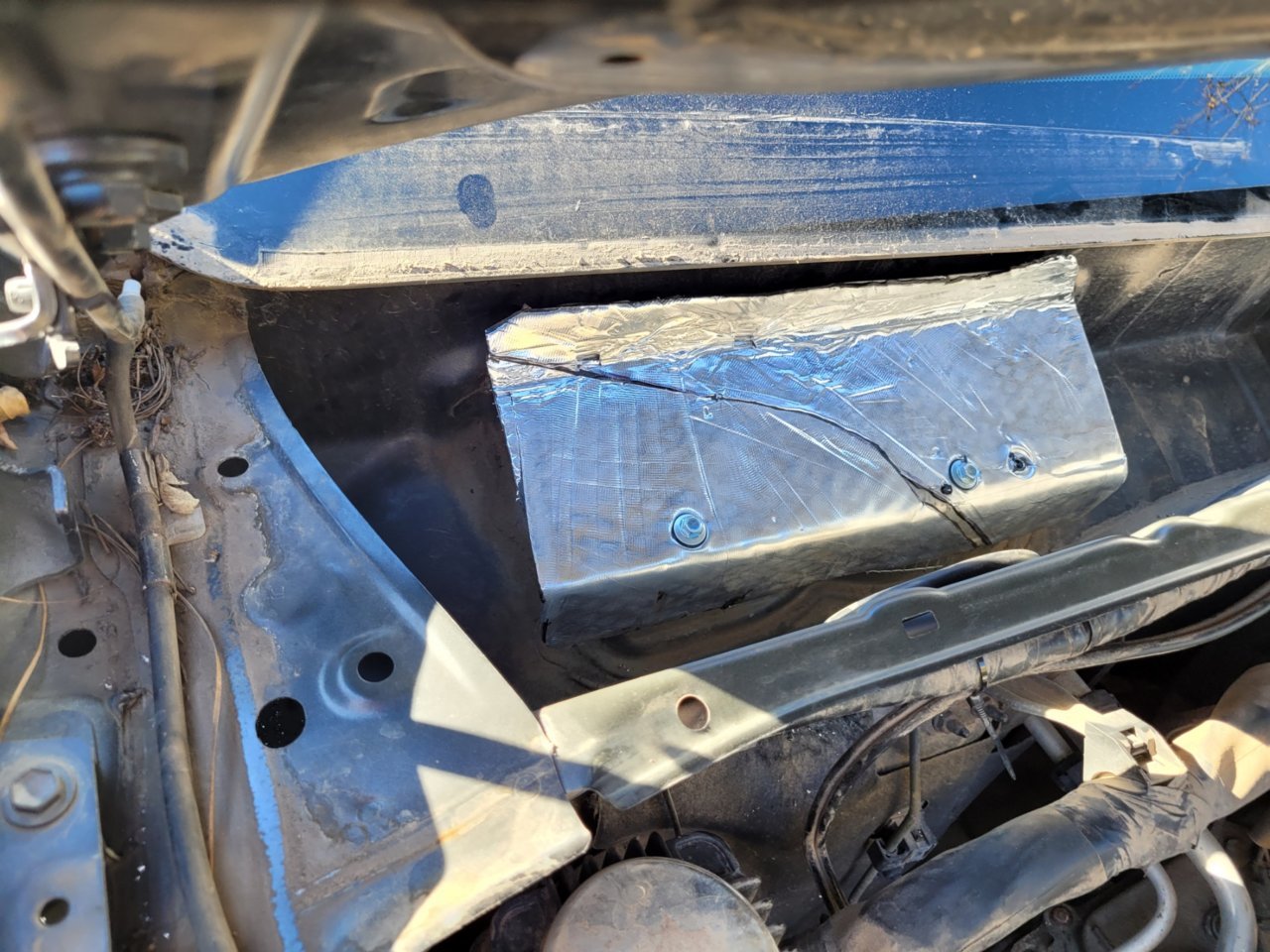

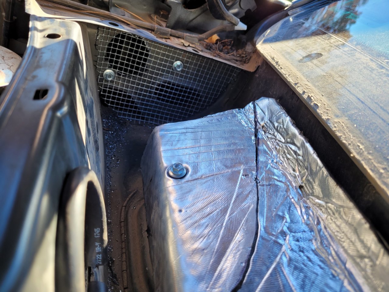

    Just did it this weekend. Cut 2 inch holes on both sides. and I used an old license plate with sound deadening for the hvac cover.

    I believe he has a gap between the plate and the opening. It is hard to see in this picture. If not, not sure how it works lol

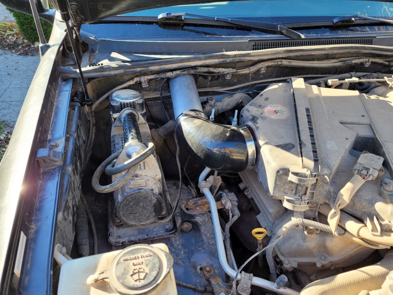

    This is what I have.

    The reason we've been putting "plates" in that location, ahead of the engine intake and above the current fan intake, is because of a perceived need to provide a secure path for air to move into the intake and also into the A/C - I thought this was intended to protect the engine intake at WOT from being starved due to the A/C fan being on high. But they end well before they reach the top of the cowl, and leave a large amount of space for the fan intake to operate from - basically just providing deflection to the engine intake and nothing more.
    From those pictures that were posted, it almost seems like the plate is instead a floating lid, leaving an inch on the underneath and at the very top lip? I can't tell, it's hard to tell clearance from the angles. But that's going to put needless strain on the fan motor while providing very little extra benefit to the engine intake if the clearance over that fan intake is too small.
    And to be fair to that entire line of thought, I'm not even sure there is truly a need to provide a diverting plate for airflow - it feels like an extremely fringe thing that MIGHT occur, but with the plate at least it's not to the detriment of either intake.
