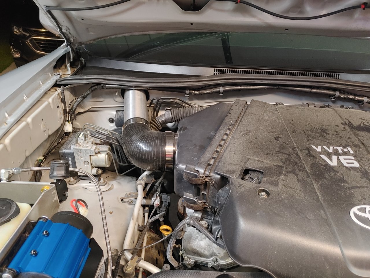

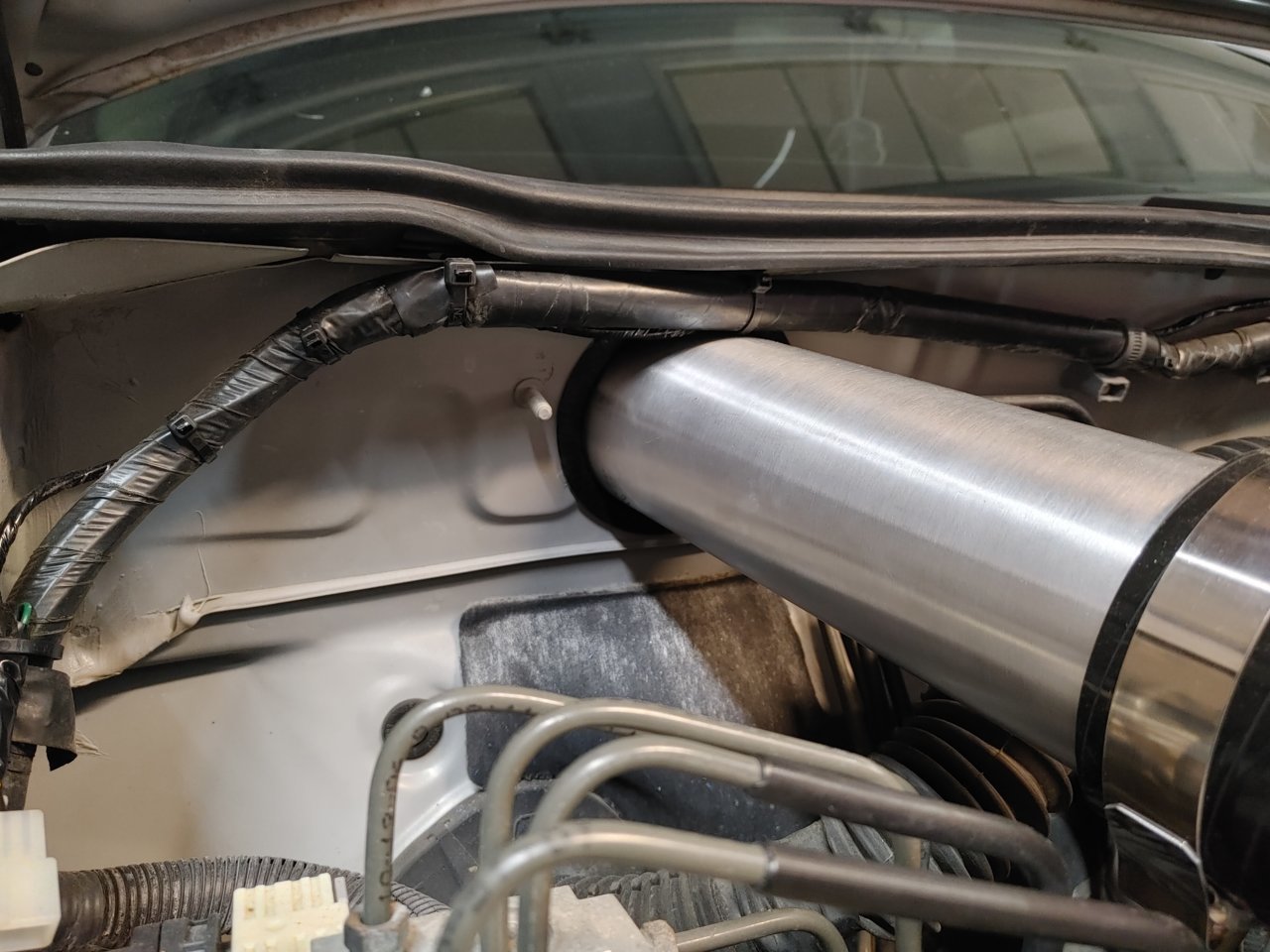

    Did mine last night. Only issue was I had to cram some rubber weatherstripping around the pipe, even though I used some rubber trim around the edges of the hole because when the engine is started the pipe would knock against the edge.
    I see no reason to cut anymore holes on the edges of the cowl panel, there are 2 large cutouts already and I am not running fender liners so those holes are open to the outside anyway.
