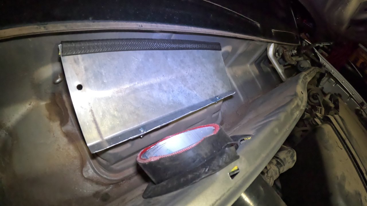

    What is everyone using to line the hole and isolate the pipe from vibration? I've got 3" OD alloy pipe and a 3-1/4" holesaw bit. I was thinking that I could use a 3" ID silicone tube as sleeve, but that looks like it'd be a bit too thick to fit.

    I think the easiest is a piece of door edge trim.

    I used door trim at first but it rattled, then I took Rob's advice and used bulb seal (think that is what it is called). It's linked somewhere in this thread a couple times. Hasn't rattled since.
    Same as door trim but has a little cushion piece on top.

    I split some fuel hose.
