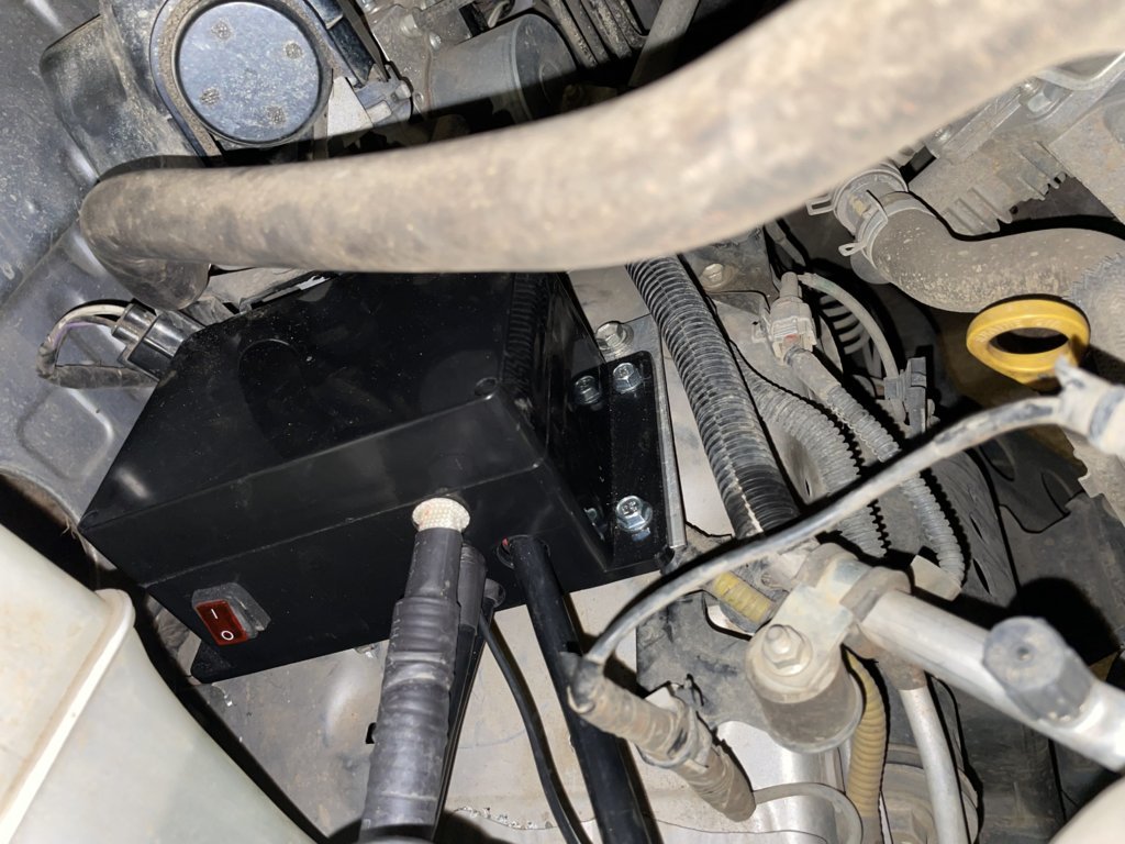

    That is the main reason why I plan on doing mine with my compressor and my switch panel all in the drivers side corner I’d love to get rid of the intake and move my compressor to that side also plan on cutting fenders eventually so that stock air box has to go

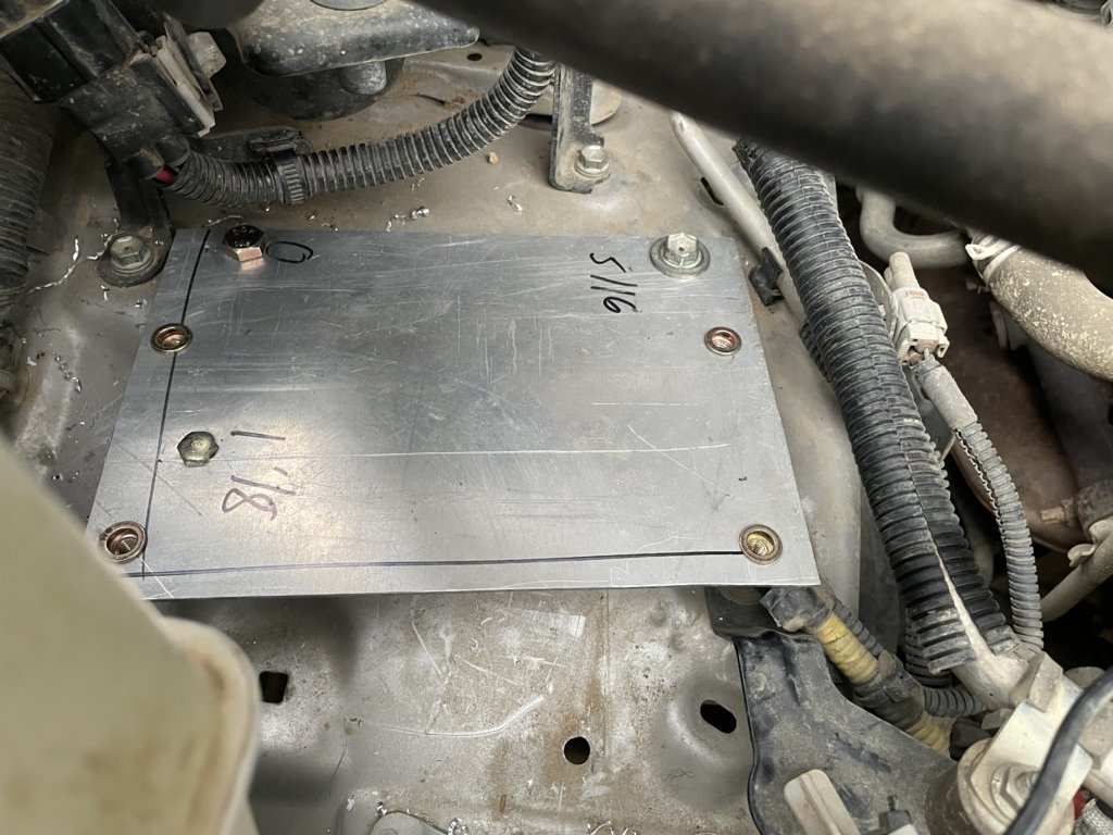

    I also forgot to mention that I used the extra space for mounting the winch controls from the badlands apex 12k.

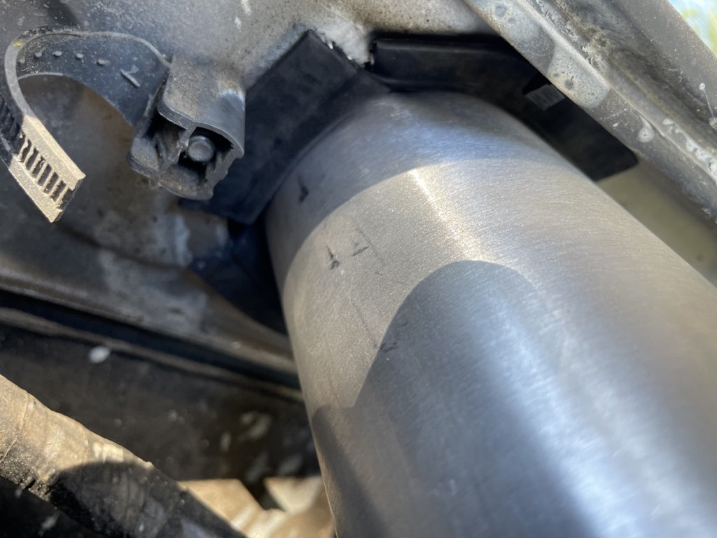

    Just adding my modified Pele Prints cowl intake for reference.
