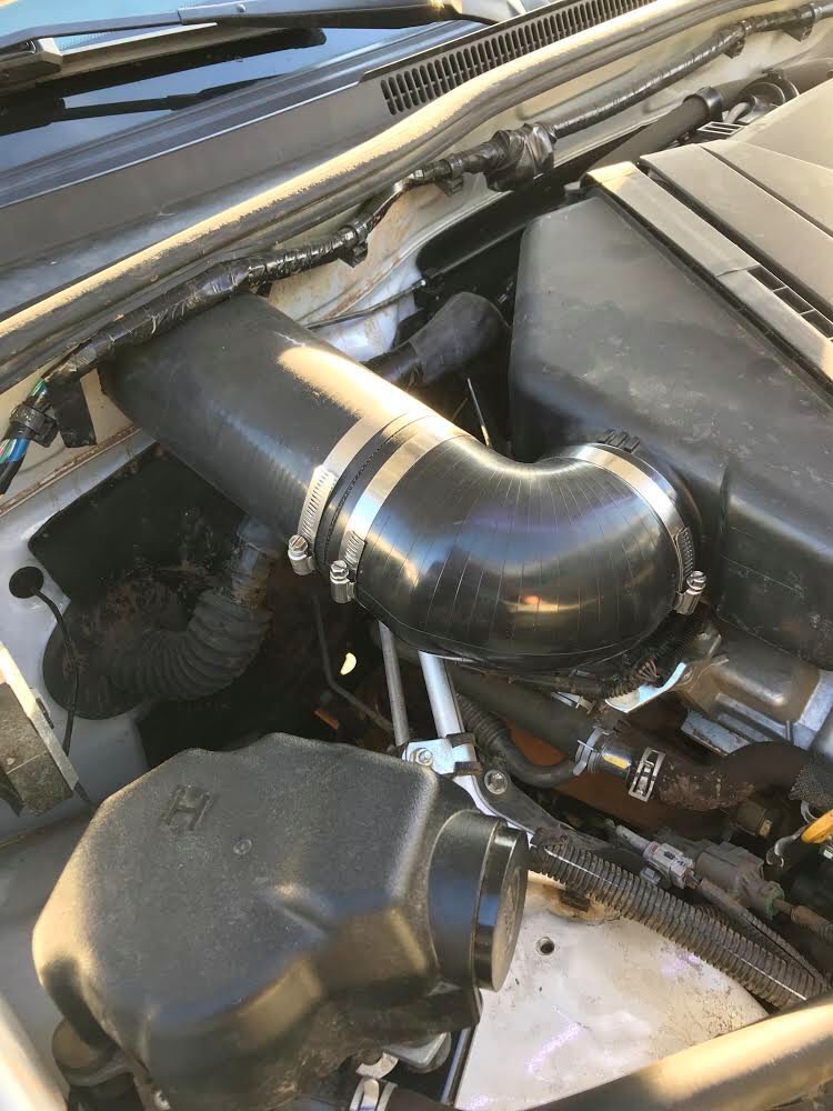

    Did this a few weeks ago. Works awesome so far. Just need to fix the pipe from vibrating, the door edge trim I used isn’t soft enough. I think anyway
    F8074E6C-59C5-462A-8BA6-ED0AFDCF627E.jpg 6C0BAC88-B1ED-4261-8026-48A87585B639.jpg
    RA77, FishTacoTruck and Taco-Obsessed like this.
