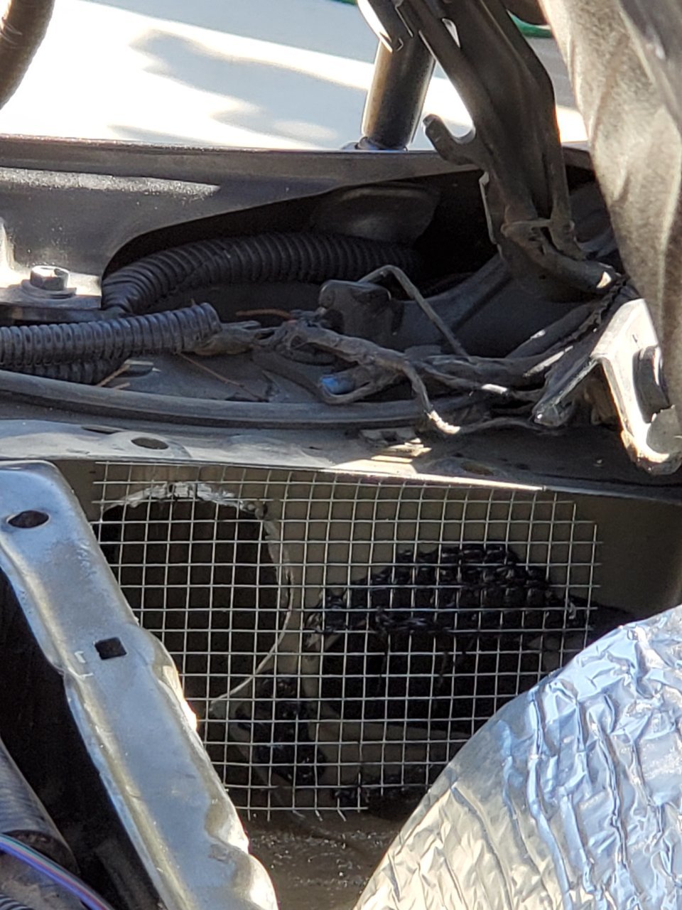

    Shortened flowmaster exhaust with a turn down pipe, under cowl intake, throttle body spacer, train horn, underhood led lights, hood struts, dual 27f yellow tops. Led ditch lights, led front roof light bar, led fogs and headlights, behind grill mounted piaa dual color driving lights. Aux fuse and relay panel. Pro comp skid plate, bilstein 5100 leveling shocks on a 2in. lift, b110 rear 5100, add a leaf, front superbumps, light racing jounce rear bumpstops, sway bar relocation, brake line bracket extension, driveline carrier bearing drop, front diff drop, on board air compressor, 10 gal pump driven fresh water tank, cb radio, pioneer 4200 hu, infinity reference component front and component rear speakers powered by rockford fosgate 4 channel, jl audio 10TW3-D4 sub powered by kx800.1 amplifier. Big three upgrade, capacitor. Full cab sound deadening and thermal insulation. Led interior including added footwell, courtesy, cupholder, center console, and glovebox lighting, rock lights, bed lights, ring gear armor, under bed ammo can storage, pistol safe, body armor sliders, roof rack, hilift, 285/70 17 nitto rodge grapplers on american racing teflon atx, tailgate strut, and tailgate lock, retrofit projector headlights(home built), rgb halos inside turbine shrouds, black out surround, black chrome reflector and shroud, white halo outside shroud, white led drl, rgb behind grill on rf control. Mods followed from a TW thread: Anytime fogs Anytime rear view camera Anytime 400w inverter Alternating blinker/running lights 110v center console outlet ABS kill switch Engine kill switch (magnetic) 12volt bed socket Rear diff breather relocation Led bed lights Cargo net anchors Grid it center console top Grid it sun visor Locking center console Instrument cluster led swap Map lights on with dome Cigarette lighter add (shifter position) Dtrl kill switch Hilux lighted 4wd selector switch. Vios hvac knobs Hood scoop led bar

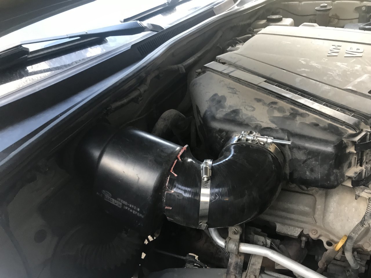

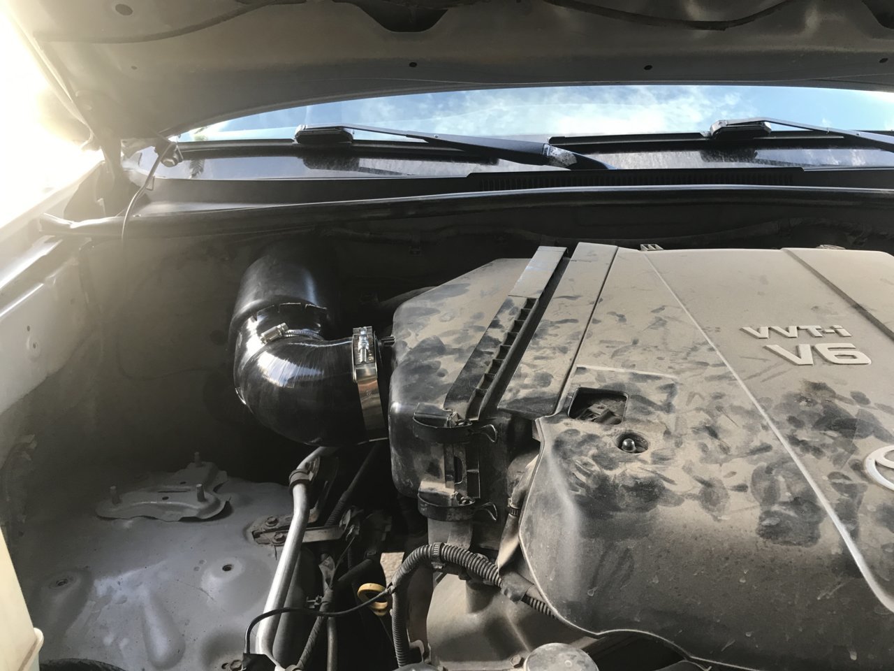

    I wanted to share my experience with this mod. Probably about 2 years ago I did this after reading another members post detailing how he went about it. While it worked ok I was really sick of all the cabin noise it created. Then I read this thread and it lit a fire under my ass to go back and change it up. I had a rattle at first and tried a number of different things before eliminating the noise. This time however I am stoked on the results. First, I liked the use of hardware cloth over the openings to keep rodents out. So, added it in this time around. Second, the engine noise was frustrating after a while and I hadn't used any sort of barrier between hvac inlet and intake inlet. Stole the idea from op again and created a plastic divider lined with foil backed foam insulation. Huge difference, now I don't feel like all the sound deadening I installed when I did my stereo system was for nothing. Even my wife was impressed on how quiet it is in the cab now. Third, although I live in so cal where rain isn't a problem and I don't usually go too deep when crossing streams, I was concerned about water getting into the intake. Again I used op's train of thought and kept a nice, deep channel open under the hole for the intake and formed a lip under to guard against splash back. Finally, I didn't think the holes in the side were necessary for better flow at first but since I had it open I went ahead and followed suit with two, 2 1/2 in holes, one on each side. Wow! The hesitation on acceleration is gone and my butt dyno can feel the difference. As far as rattle, some creativity with some rubber plumbing couplers and about 3 inches lopped off the aluminum tube did the trick. I also wrapped the tube with insulation in hopes of keeping the air temps down. Not sure if it will actually make any difference but no harm in trying. All in all, it has been worth the effort to change it up so good job op! TW is one of my favorite sites to visit because of the ideas and guidance that can be found. 20200703_093537.jpg 20200703_093557.jpg 20200703_111528.jpg
    RA77, badger[OP], elricfate and 3 others like this.

    This is the best option in my opinion for a taco air breather mod. I was looking at the volant cowl option but this seems like such a great alternative. I would think it’d be cleaner air as well than pulling from the wheel well. I’m going to wrap insulation tape around it for a heat shield and use a bigger foam ring for the cutout.

    I too wrapped the tube in insulation. Not sure how much it would really affect performance but if it drops the air temp by even just 2 degrees it's an improvement. Besides, it took about 2 extra minutes to do so why not. I wish I had revamped it several years ago. How much would the volant kit cost? Including a new hole saw I think I am at less than 50 bucks.

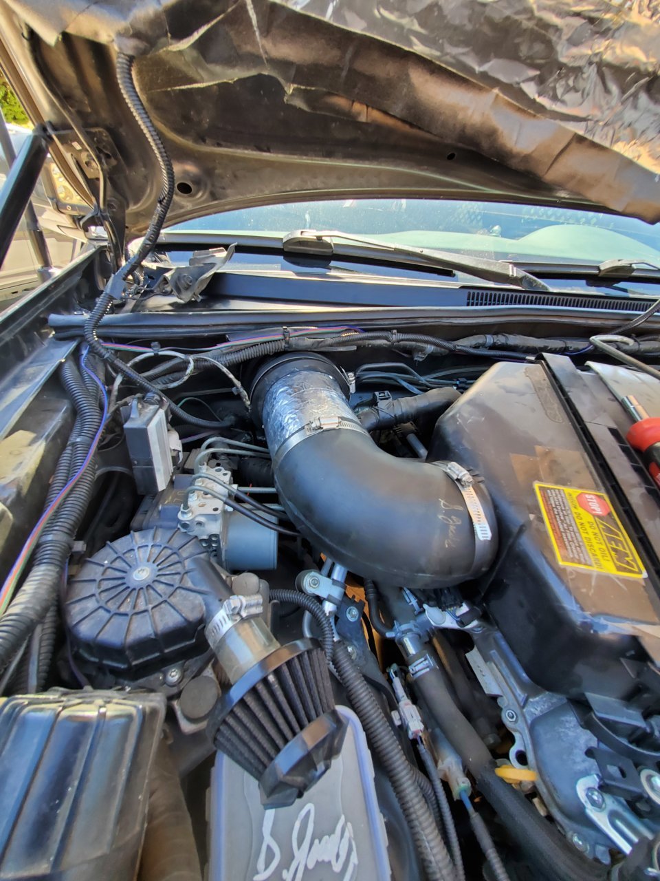

    Also I noticed in the pic that your secondary air injection pump is stock. Go to a aftermarket filter on that thing before it degrades and breaks the pump. It's a costly repair that toyota is just recently starting to admit is their fault. Just my opinion, not trying to tell you what to do.

    Thank you! I need to just do it already. I kind of forgot about that actually. I will do that when I insulate the tube. The volant air intake is like $450
    Holy sh.... 450? Geez that better give you an extra 20 hp. On the pump filter I got one from uni for a couple of bucks on fleabay. I changed it after my valves went bad. Figured it would be next to go if I didn't. Whats good is it takes a minute to pull off if you have to go to the stealership for something so they don't try to use it as an excuse to void your warranty. Unfortunately for me toyota wouldn't help me when mine went out. It was only after I paid for new ones and installed them that they recognized it was a problem. Anyway good luck on the mod, I am happy with mine.

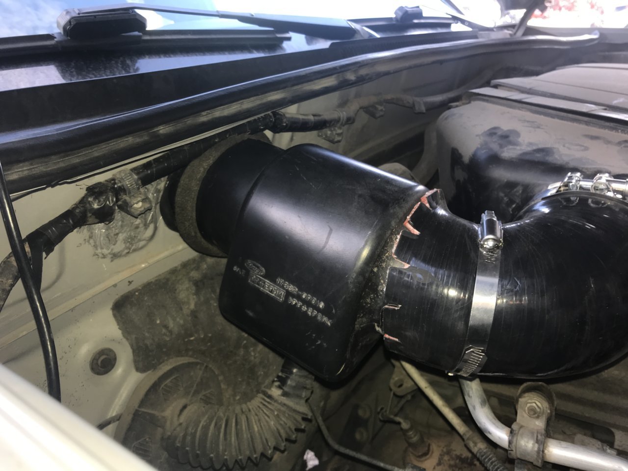

    I think so, if you have the secondary air injection system. Is there a black pump on the passenger side of the engine with a hose running into the head? It wasn't until late 2012 that toyota started to make the pump run for a bit after engine shutoff, I think.
    I had the noise issue the first time I did the mod and it was really loud. But after re-doing it and using a baffle between the engine intake and hvac intake, the noise is almost inaudible. My wife used to give me that look too, lol.

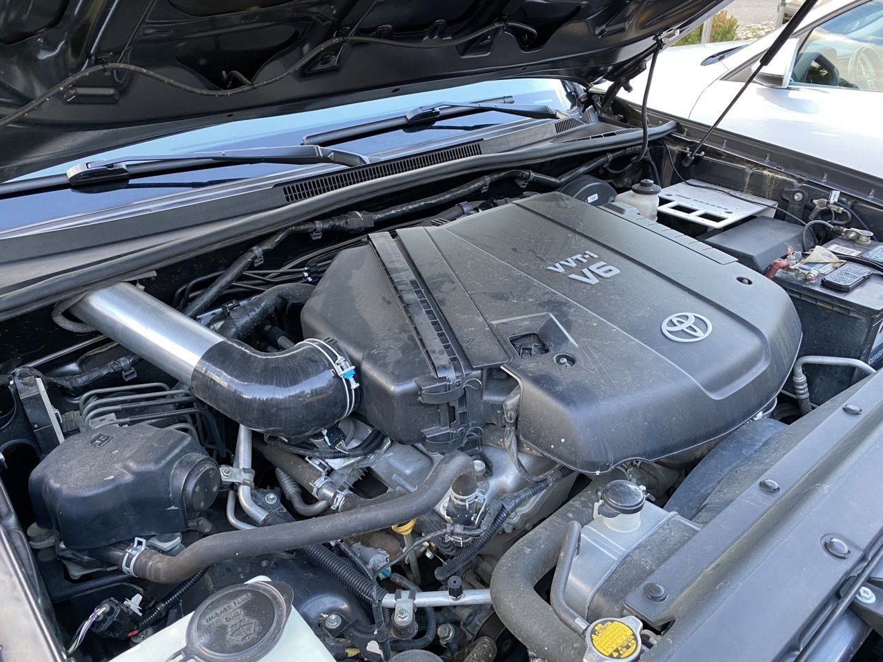

    Toytec Boss 3" lift URD Short Throw Magnaflow dumped 285/75/16 Duratracs SOS sliders Ext brake lines NWTI Bumpers VHF/UHF/CB Shackle flip

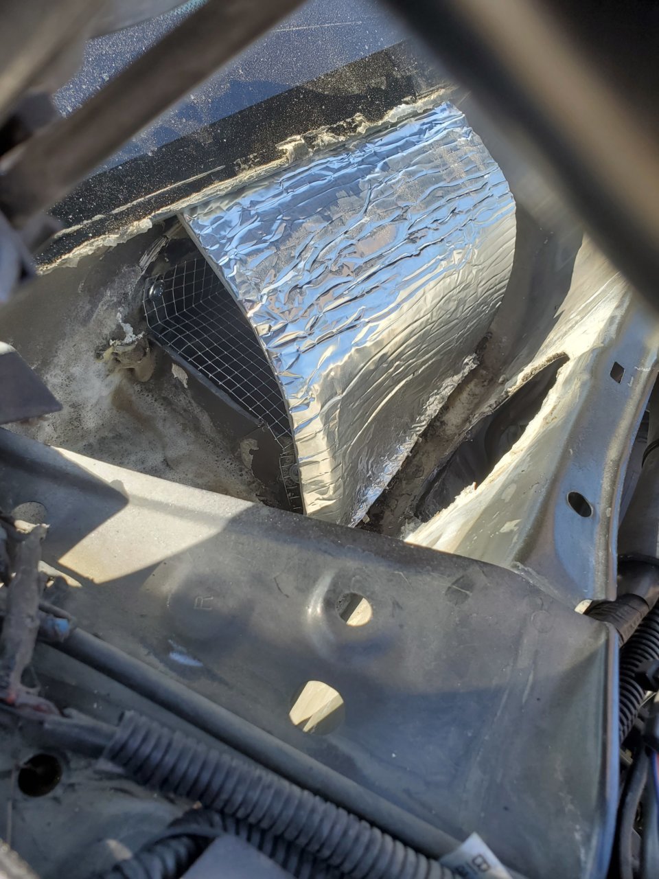

    Couldn’t track down a 3” piece of pipe so I improvised and used the existing air intake but cut it down. Worked pretty well. If I was to do it again, a full 4” elbow to stock/cut down intake to a 3.5in hole saw would have been the ticket and saved a bunch of time in this scenario. Use what ya got I guess
    Edit: and f*#k hole saws...
