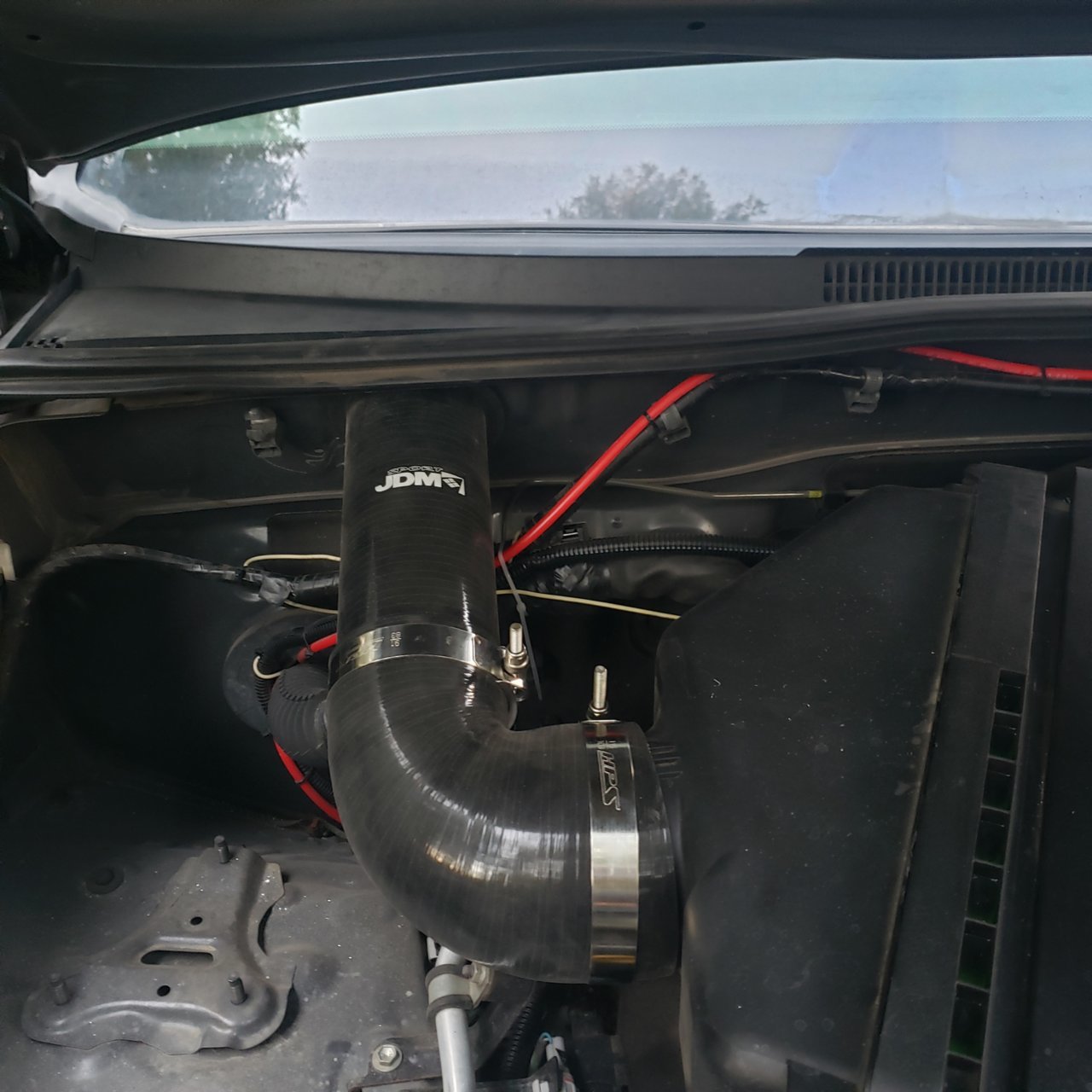

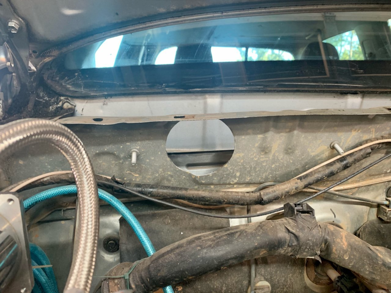

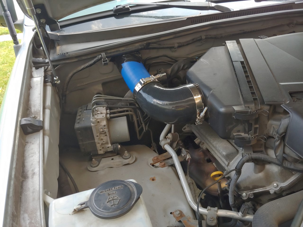

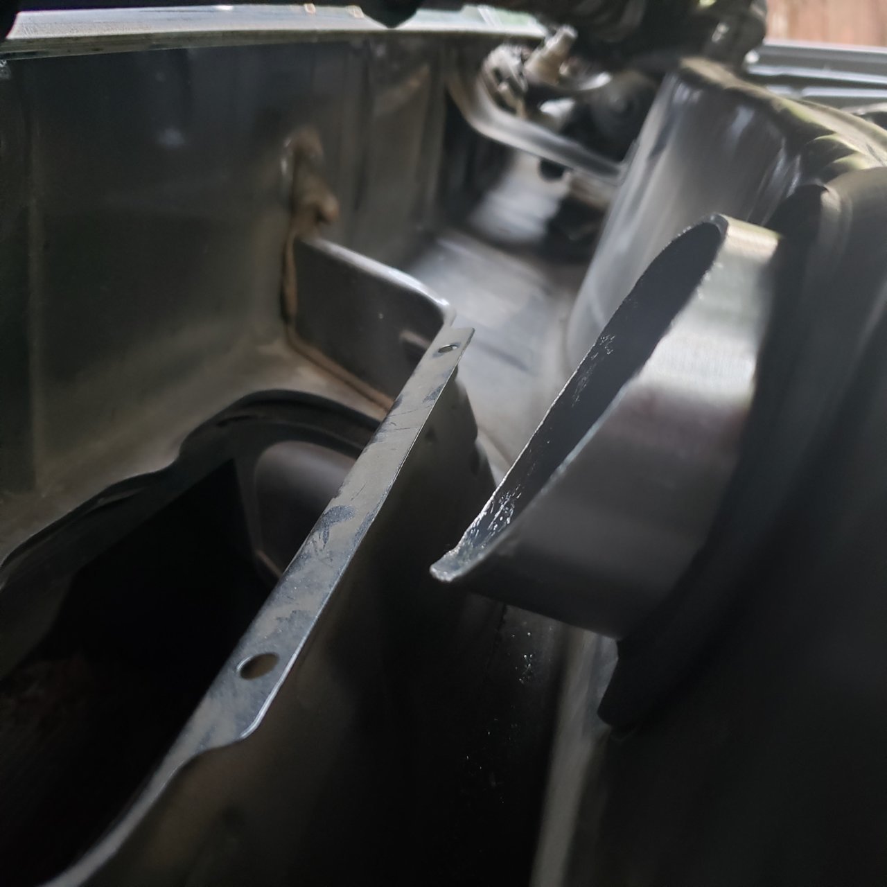

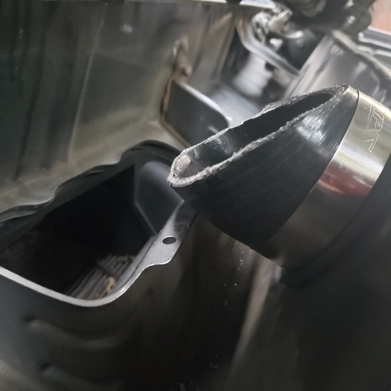

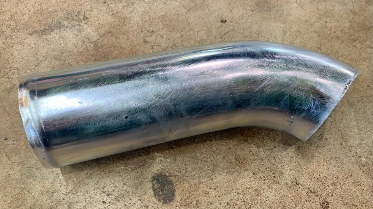

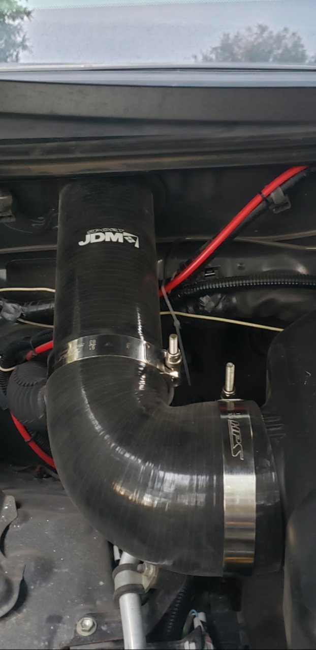

    Got this mod done today, all in all took a couple of hours. After reading all the threads starting from the original back in 2013, took points from several different takes on this. Went with a 4" to 3" silicone elbow, 3" aluminum straight pipe with silicone pipe cover, cut a 3¹/4 hole, had to dremmel out a little to make room for the gasket. First I tried the idea of cutting the aluminum pipe in the cowl at an angle to prevent back splash from underneath
    I was not happy with it so I went a step further and put another silicone elbow on the cowl end and cut to the angle needed, much happier with it.
    The HVAC intake will flood well before the motor intake will. I planned on doing the divider but tested without and the noise is minimal, only noticeable at full throttle, a subtle growl, and I actually like the noise. HVAC does not seem to be fighting for air so I am foregoing the divider. Still need to cut the extra holes on the sides of the cowl and add the chicken wire to keep rodents out
    This is a GREAT alternative to a snorkel! Thanks to all that posted ideas and suggestions, especially OP! I feel much more confident for river crossings!

    Cowl induction is a much cleaner install than the add-on growth of a snorkel.

    Absolutely! I despise the look of a snorkel, and with the intake in the cowl, I would have to get in about 5 feet of water before it flooded. Best mod I've done yet!

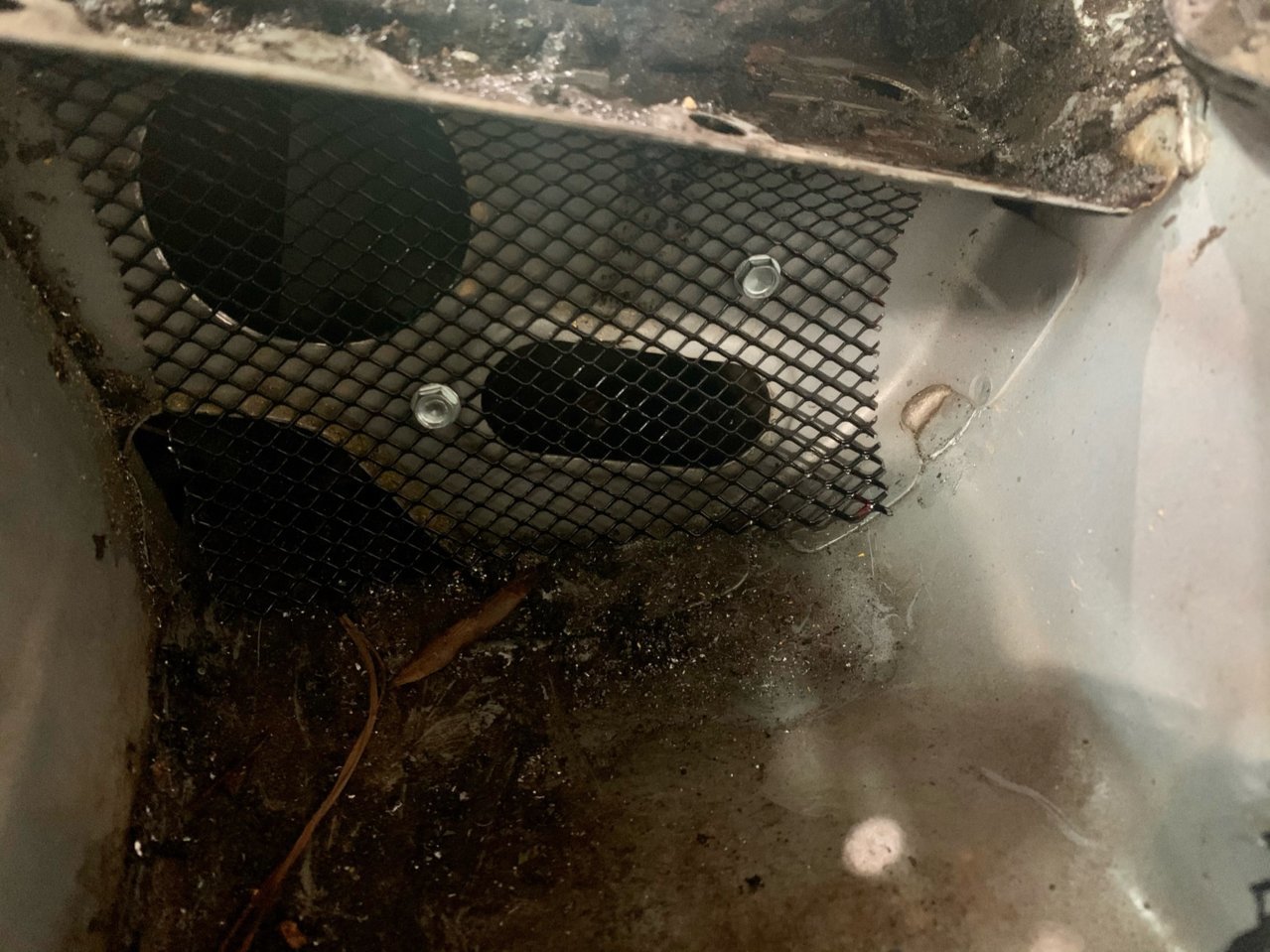

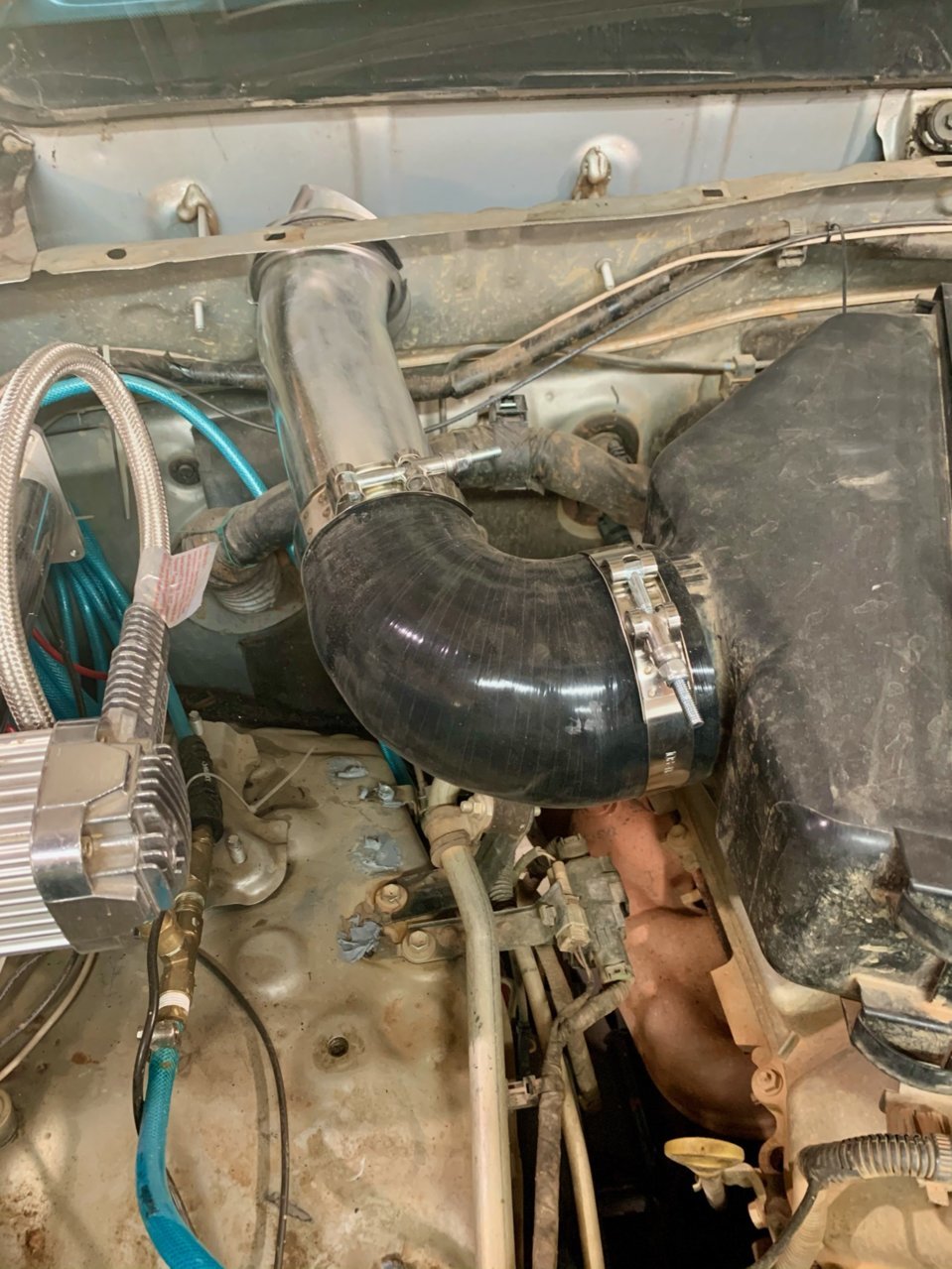

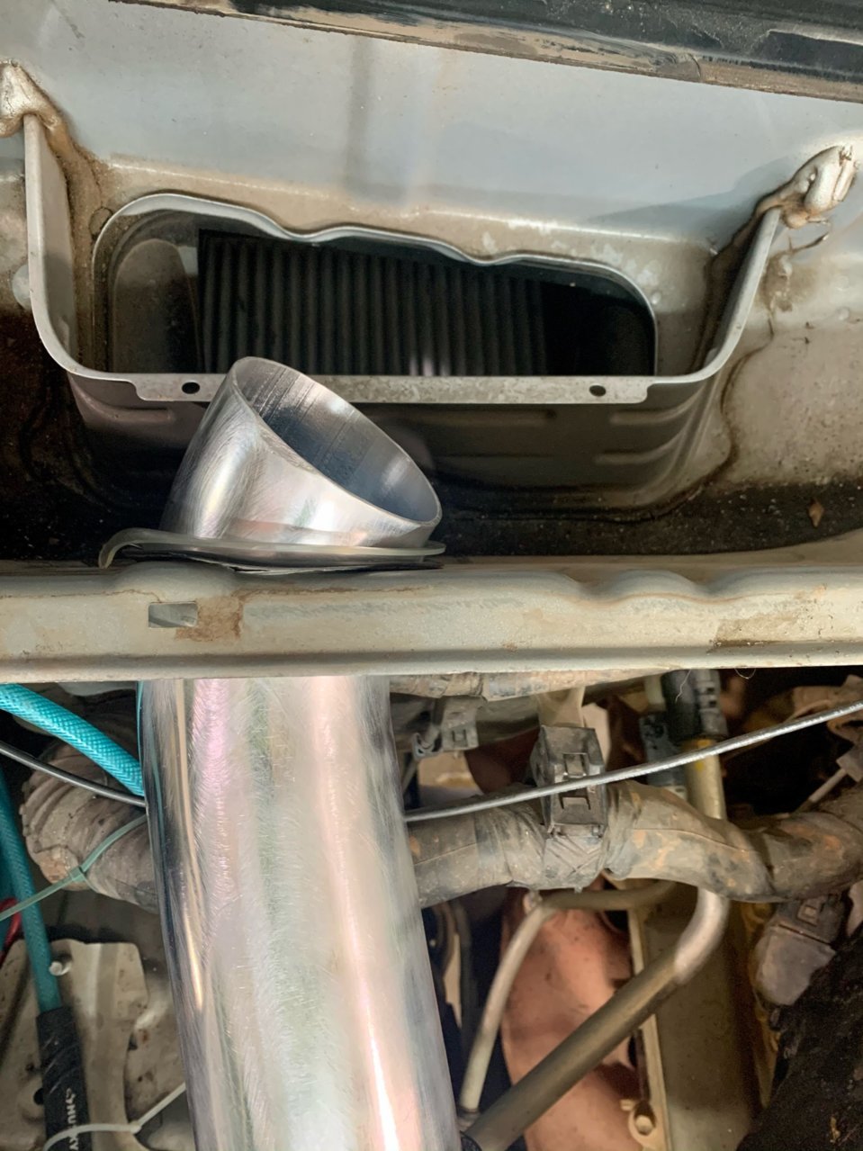

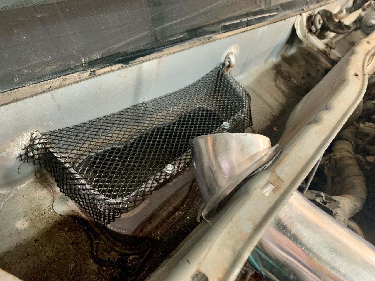

    Dayman Karate
    Dayman Karate Ruffling feathers and turning eagles into vultures
    Dec 18, 2017
    #238838
    4,719
    Clay
    Central Alabama
    2001 4Runner, JKU Rubicon
    https://www.tacomaworld.com/threads/daymans-karate-class-but-you-wont-learn-nothin-4-link-lt-and-previous-iterations.755134/

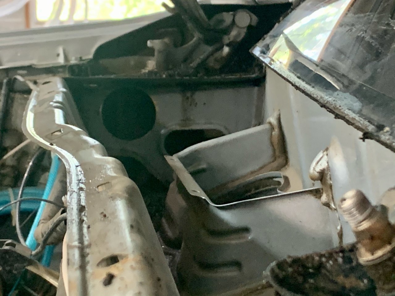

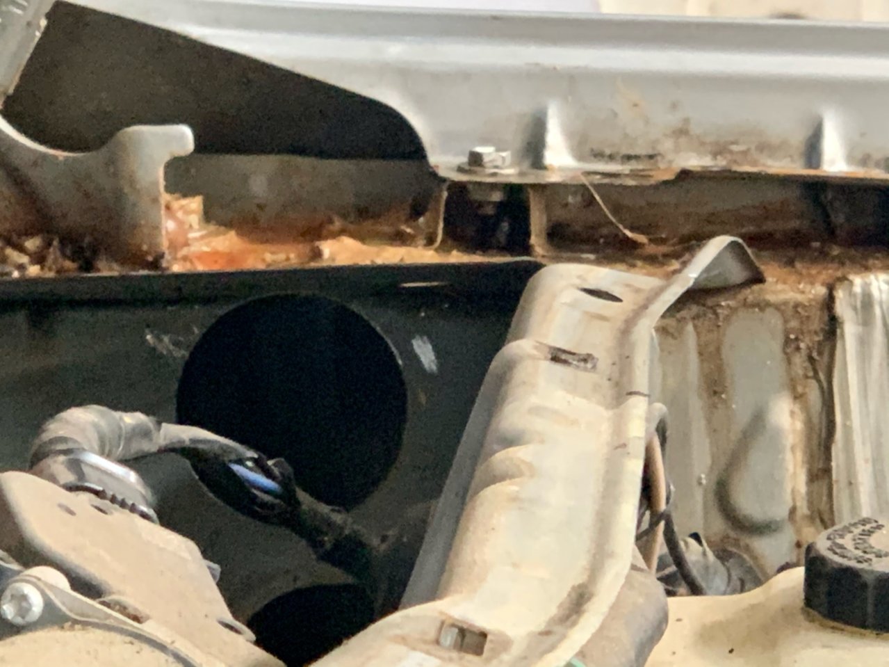

    did mine a while back. Maybe these pictures will help someone determine where to drill the holes. I used an aluminum piece with a bend and cut into the bend to have a little extra lip and angle away from the cabin air. Needed a solution after cutting and sealing up the fenders for 35s and wasn’t huge on snorkels.
    35189EEE-DB4E-439B-BDD0-180323F291A6.jpg E0D92505-C4AF-4764-8549-BD591235D88F.jpg F4C4A9D9-7DE6-4CD4-902B-A1E11CE93232.jpg 11D2453A-52BF-4A81-9390-409FD38A161E.jpg 4F74E56F-8609-4817-B548-EE4CD25E9CB2.jpg 847A0965-C544-45A0-A97C-6EA95711366B.jpg 71931A98-2B48-4EDB-8072-5136A71D3C33.jpg 177E0DAE-A6CA-4049-98B7-3CD48AFE52B3.jpg
