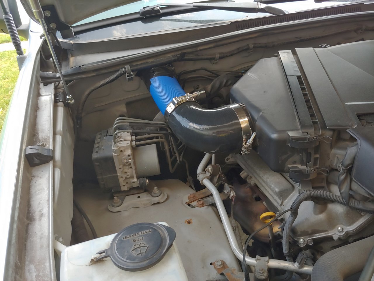

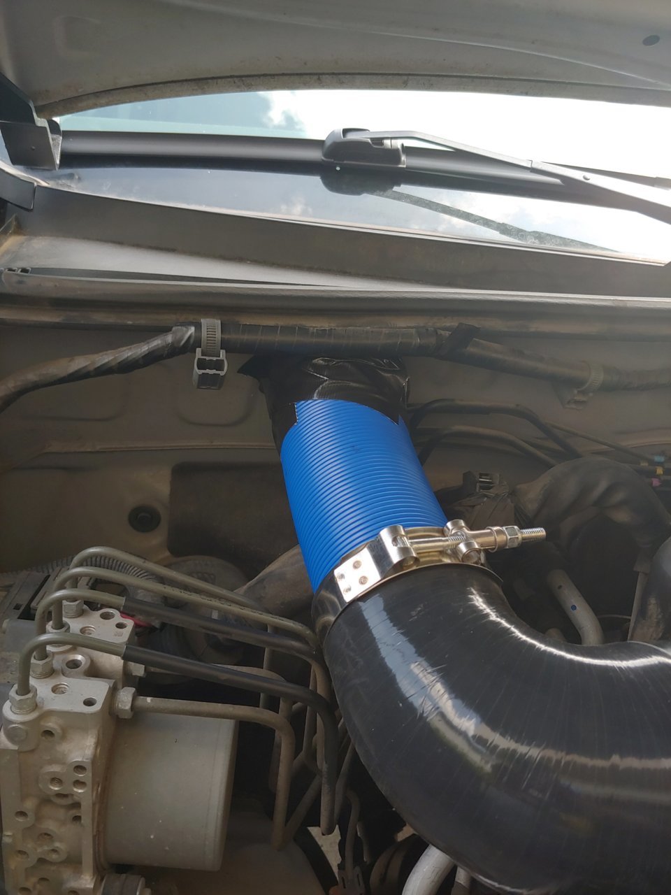

    Did this mod over the weekend, haven't put in a sound break in front of the HVAC intake as I didn't have any metal for it but hopefully will have something for that soon. Next step is to eventually fabricate a 2nd battery holder to fit in the open spot and run a dual battery setup. Overall it went fairly smooth, Milwaukee hole saws are expensive but made light work out of the sheet metal, had to go with Blue to match the rest of my truck. As of right now these are the only clean things under my hood!

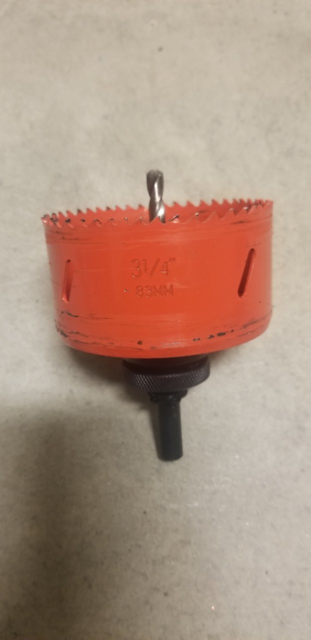

    Just got this done...... and would like to pay it forward..
    I am willing to donate my 3 1/4 hole saw and arbor to anyone wanting to get this done. Used once and it cut like butter.

    Any of you guys experiencing a thud?
    Im getting what feels like a thomp or thud upon acceleration from a dead stop, it sounds like the intake tube is hitting the firewall.
    I have no rattling, i have a fuel line that is lined for the opening to prevent this

    i may be hitting he HVAC intake area. as you know he engine moves with load. id the tube right up against the metal wall of HVAC area

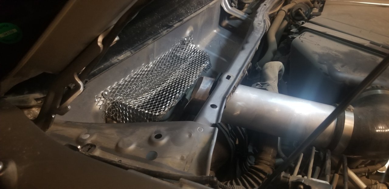

    This is when i installed
    I left about 1/2 gap

    If I were to hazard a guess, based on those original installation pictures, you are likely hearing a clunk or thud from potentially two places. Where the ABS lines will rub against the aluminum pipe and where the aluminum pipe will rub against the A/C intake cowl. Again, just throwing out a guess, you could PROBABLY figure this out by having someone sit in the cab and rev the engine while you watch the flex of the intake to see where it's hitting.
  16. Jan 14, 2021 at 6:15 AM
    #156
    elricfate
    elricfate Well-Known Member
    Nov 26, 2019
    #311771
    857
    2009 Tacoma AC Silver Mica
    Alternatively, if there's enough flex on the intake, what you MIGHT be hearing is the aluminum pipe rubbing against the rubber of the brake line, forcefully, while it moves into and out of the cowl. Sort of like when you try to drag something heavy over a rubber mat and it sticks and releases, causing a jitter.

    Im taking my tube back to drawing board lol.
    I noticed that the intake is really tight in the hole so tight it actually flexes the sheet metal upon load :/

    For that reason, right there, that's why I went with flexible intake duct instead of the pipe. It is dead silent.
