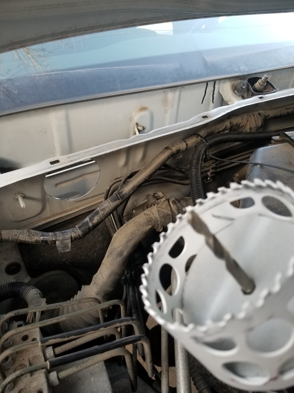

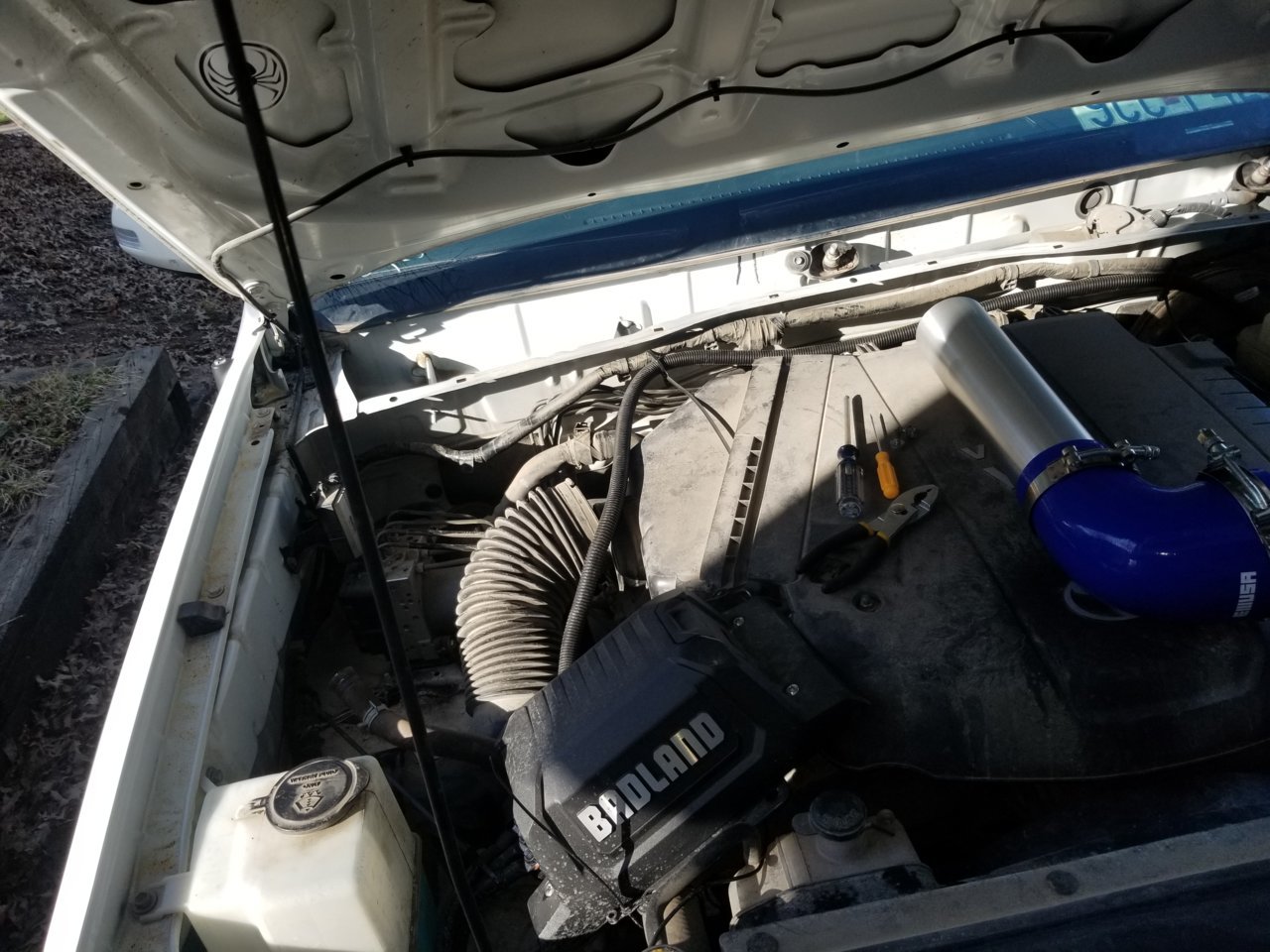

    Does it just attach the metal or do you have a section of tube running through still?

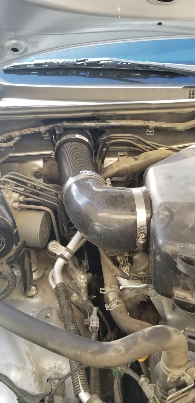

    I just ran the flex duct right through the firewall. I didn't add the connector plug they sell or anything, which is why the tape is there. It's basically just to make sure that it stays wedged.
    Edit: I didn't get a picture of it with the cowl off, but it's in there a couple inches.

    I gave up on the aluminum tube. Went with flexible to mounting plate, no more noises and will take away the flexing from the firewall:)

    It was good on pavement but i drive dirt daily from work and that thing rattled like no other. Super happy now

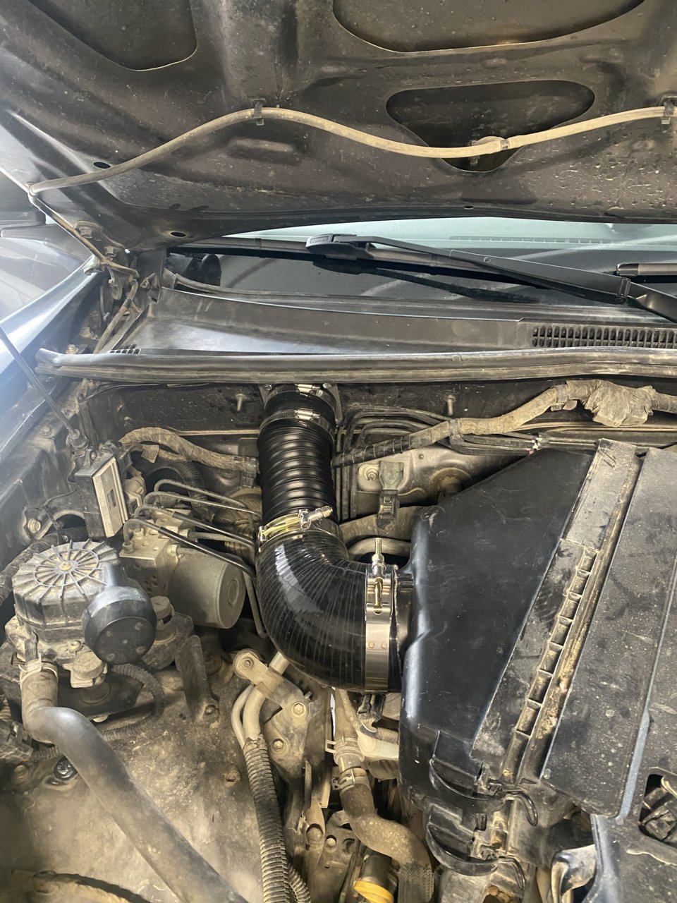

    Did mine today...thxs to the OP and all that contributed part numbers to make this process easier.

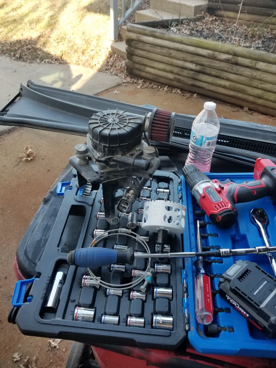

    Looks good. Now do the unifilter mod on that air pump

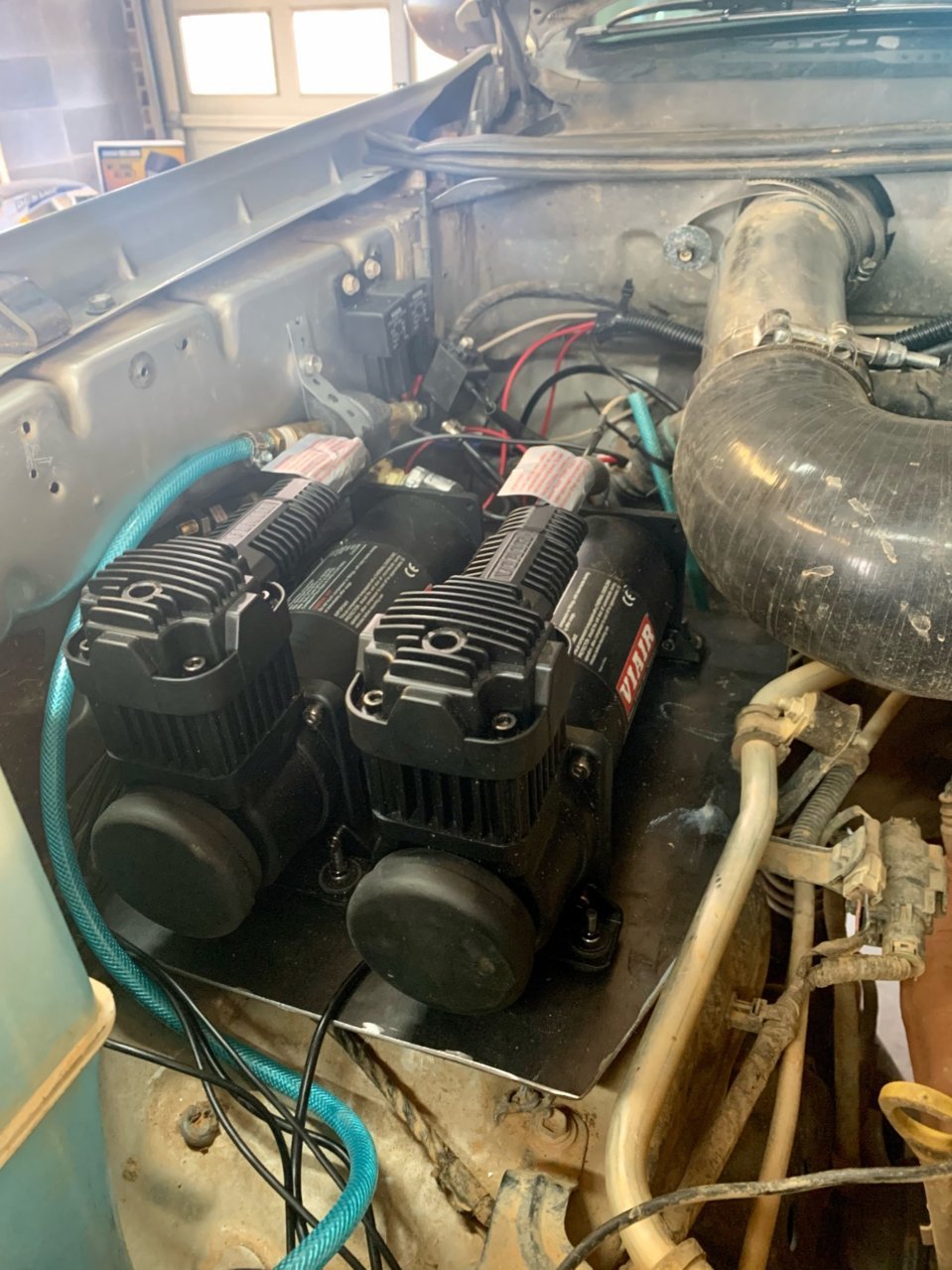

    Mine is still going great. More room for fun on that side. I put a worm gear on mine to keep it from making any noise. There was some factory bolt thing right there I put a large washer and nylon nut on. It’s weak by the way so don’t crank down too hard haha41A73A17-4396-44FB-A372-8C3546413F55.jpg

    Twin pumps?

    mine made horrible sounds until i added the air duct mounting plate to the firewall

    Yeah, makes filling 35’s much quicker haha

    I have a single right now and I swear it’s 10 mins per tire even with a big compressor lol

    Don't those Viairs get pretty hot?

    Not that I’ve noticed. I ran a single one with 35’s and a 2.5 gallon tank and it never tripped the thermal protection and I ran it solid probably twenty minutes under the hood after wheeling all day. They have 100% duty cycle, too. They don’t run much with no tank, maybe 2 minutes per 35” tire from 12-26 psi.

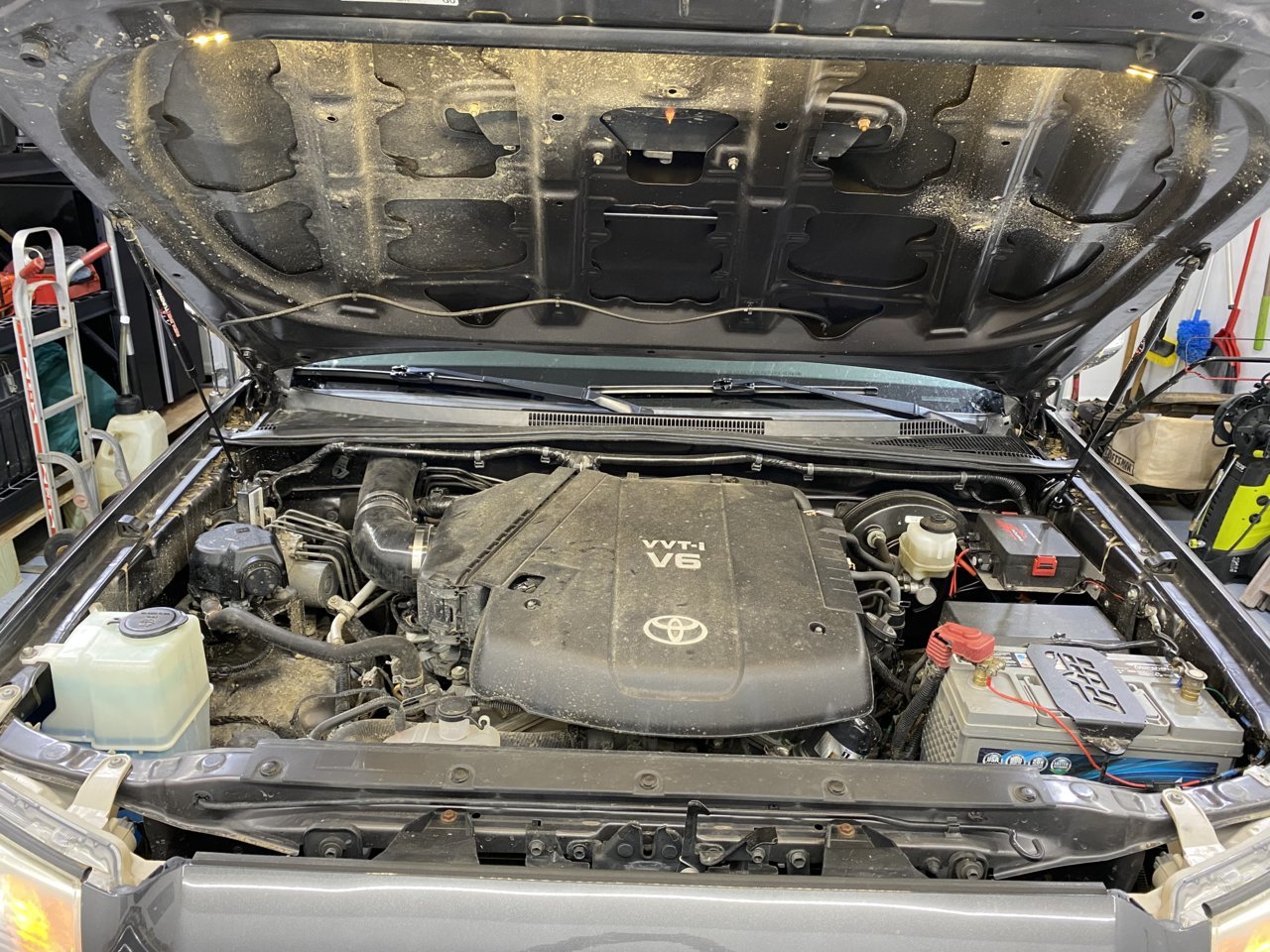

    Thanks for answering my questions. Wrapped this one up over the weekend.
