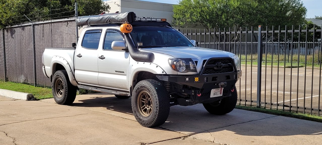

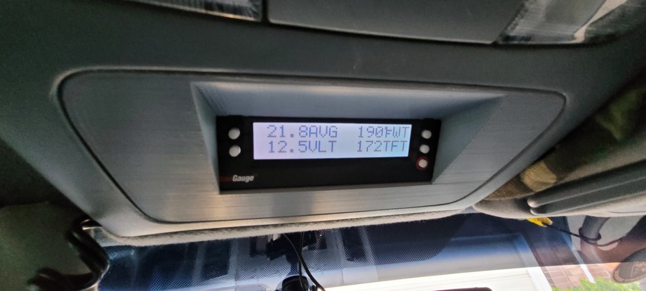

    You really shouldn't flip your snorkel inlet backwards. The venturi effect it has at certain speeds can literally suck the air out of your engine rather than supply it.
    I like my snorkel. I've noticed some mileage increase for sure.

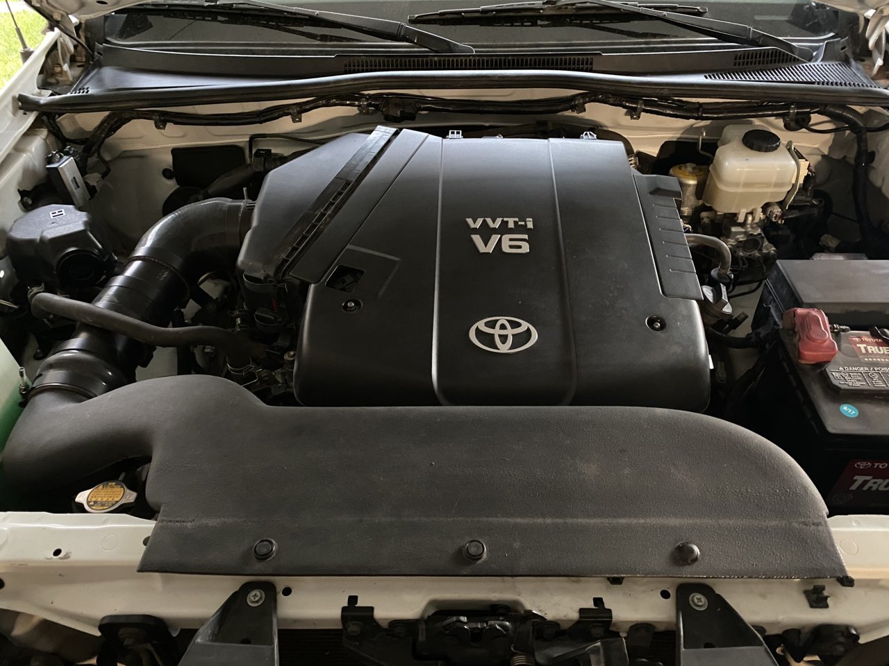

    Custom ram air was my go-to mod after trimming my fenders. Not a huge fan of the snorkel, and the ram air scoop does perfectly fine in rain/snow. Volant air scoop, pipe, and couplers off ebay.

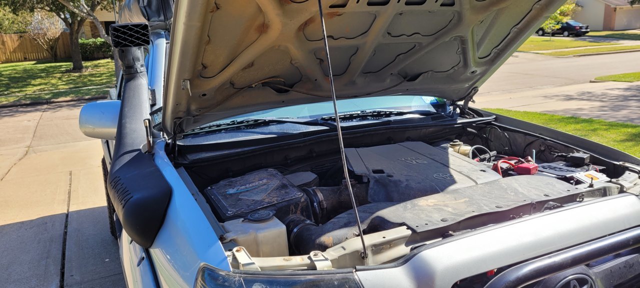

    Just regurgitating what I've read from ARB haha. I have seen plenty of people run it backwards though :cheers:
    Ah I like the volant ram as well. Double ram effect in my case :D too bad it ain't gonna double my hp :D

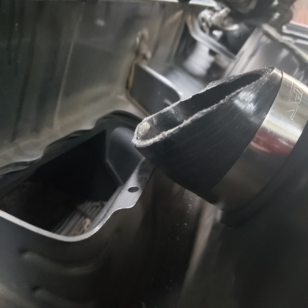

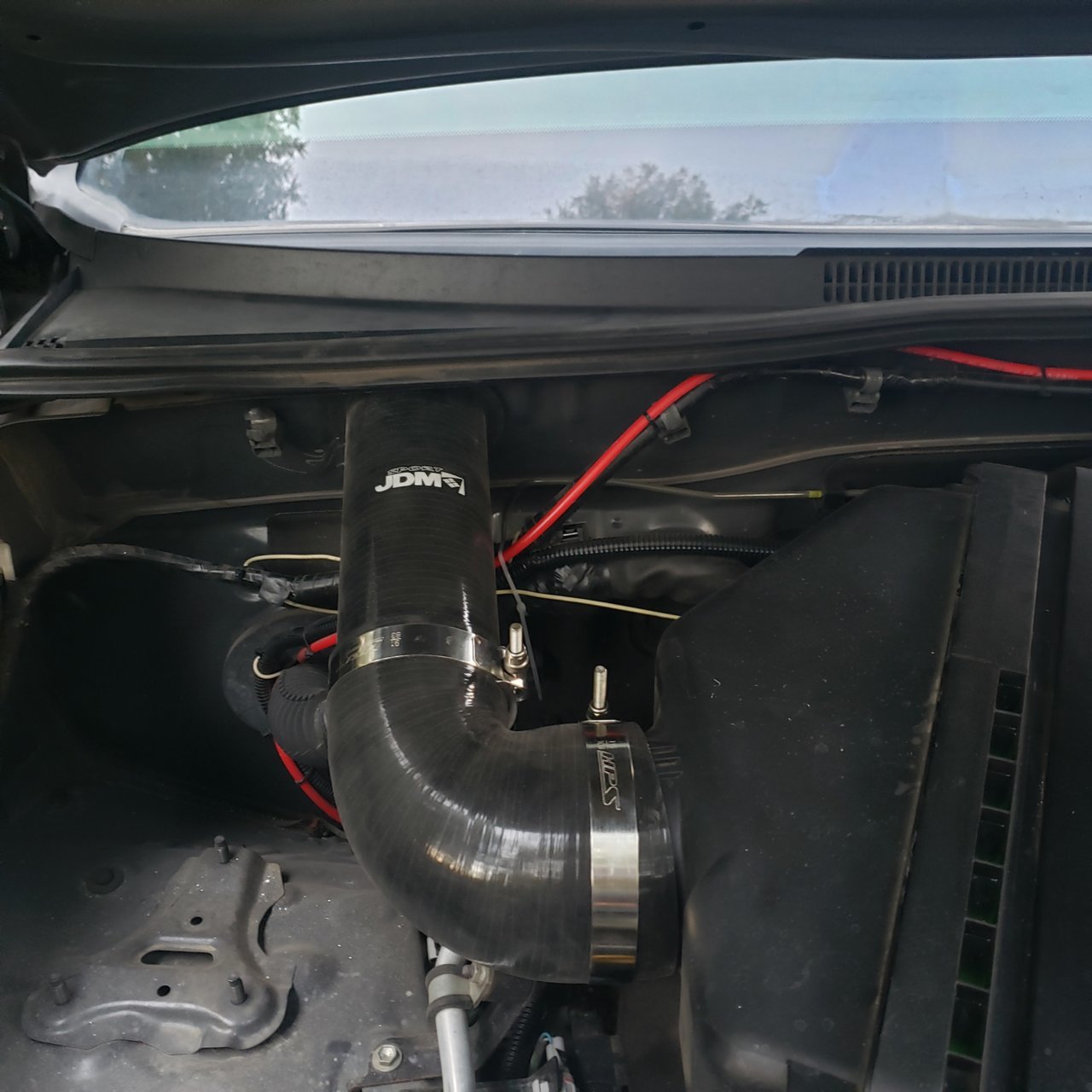

    My vote is for the cowl induction. I did this mod not too long ago and have since done some deep water crossings, water rushing over hood, no issues what so ever. I live in the Pacific Northwest and have run it in plenty of rain, no issues. I have yet to see the cowl covered with snow, that is coming soon, but after cutting two extra holes on the sides of the cowl area, I dont see this being a problem. I personally do not like the look of a snorkel, and do not like the idea of cutting a giant hole in my fender. I made a slight tweak to the mod, and the engine intake is sitting just over the hvac intake. The hvac will flood before the engine does. Granted, the cowl induction will not allow you to get as deep as a snorkel, but how deep in water do you really want to get? If your getting into water deep enough to flood the cowl intake, you've got other problems

    Update... went through winter with the cowl induction, plenty of snow, no issues what so ever, excellent modification

    I agree with cowl mod. Did mine a few weeks ago but I’m not sure she’s pulling enough air. Where did you cut extra holes into the cowl?

    Extra holes cut in the side walls of the cowl area on each side, used the same hole saw for the intake tube through the firewall. What makes you think she's not getting enough air? Driving different?
