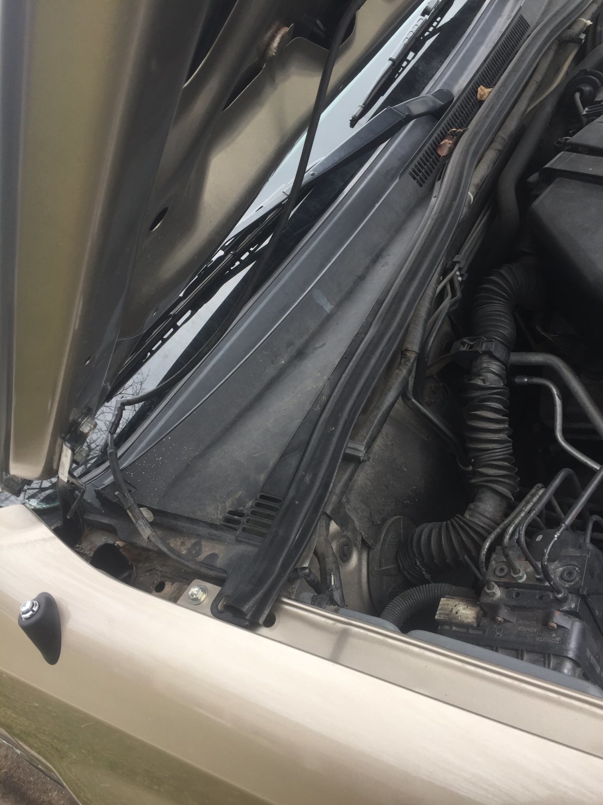

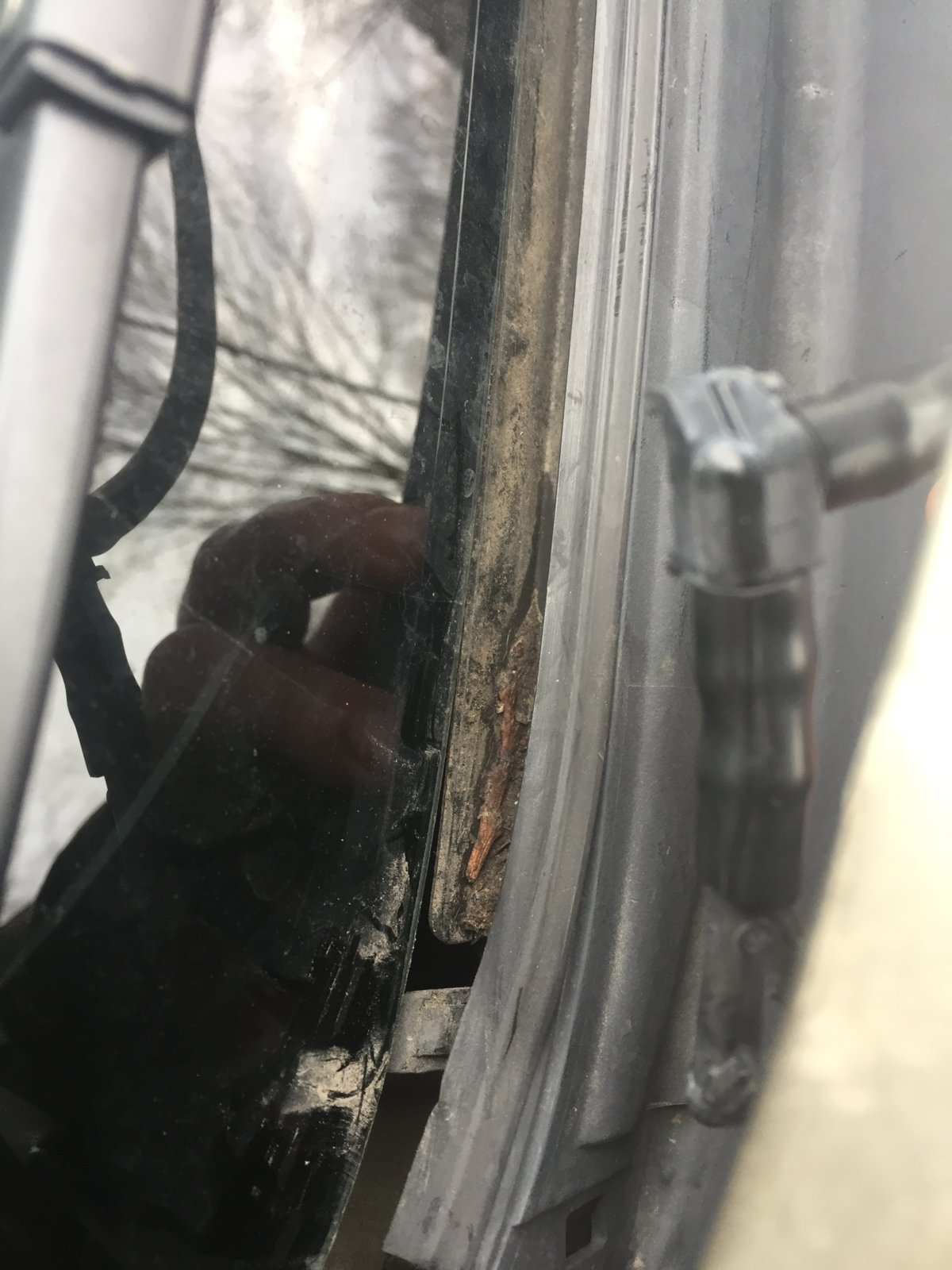

    From your first picture it just looks deformed, possibly from removal. I've removed many cowl panels and some were tough to get back into place (especially on the Lexus RX300).
    I would remove it again and the reinstall paying attention to the gap between the rubber and windshield as you work. You can maybe get one from a junk yard or eBay?
    Silicone/sealant is not the answer.

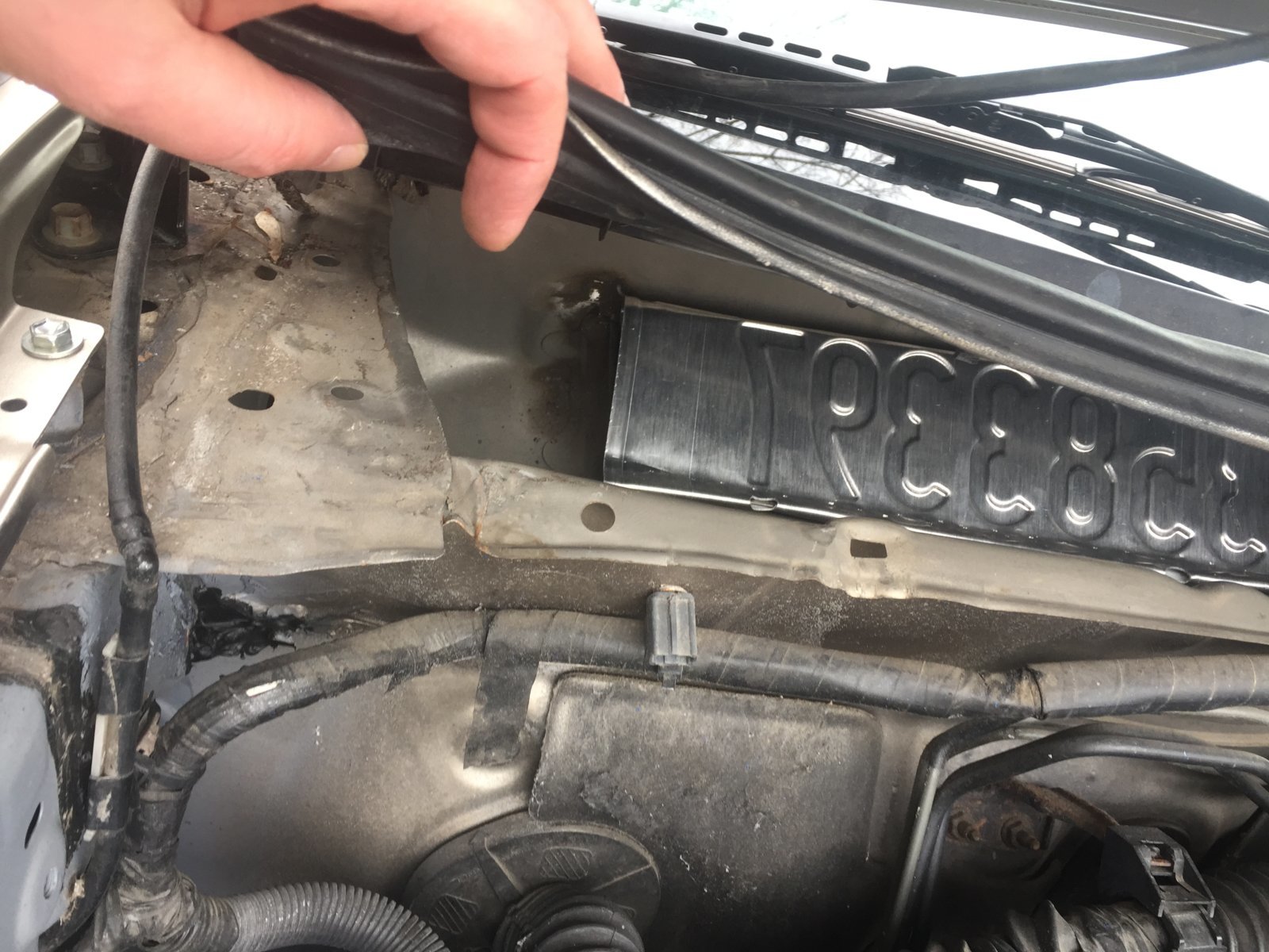

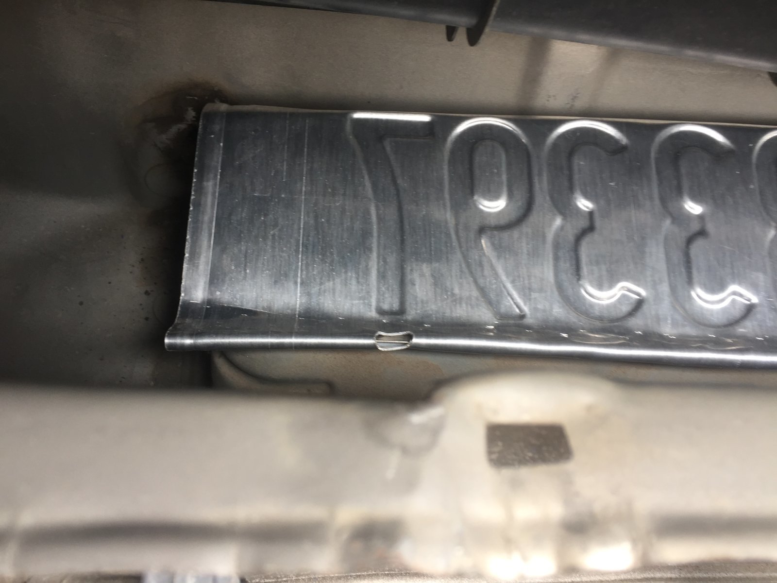

    Woke up this morning after a hard rain to find standing water on my passenger side. Ugh!
    1st time this happened to me. Curse the truck gods! Damn, I feel like I'm getting hit hard with the little things recently.
    I'm thinking about bending an old license plate as a little roof for the air intake under the cowl. I'll post some pictures is it works out ok....I'm trying to shy away from the silicon sealant solution. I have a crack starting in my windshield so I'll have to replace it at some point. Ugh...
    Here's what it's looks like. Might not be perfect but I hope it helps. Day 1 we'll see how it does. Enjoy!

    sounds easy.
    1. Flex seal tape over gap if you don’t want to replace cowl with updated design
    2. PELE 3d printed cover with shield
    3. inspect area metal for any cracks to seal
    I still have to figure out what to do about my cowl gap. Going to try tape.
    and did not yet inspect or test surrounding metal for cracks that could need seem sealer.
    despite that, after only the addition of PELE 3D kit, water ingress has either mostly reduced or stopped entirely.
    but hey the plate looks good and if it’s there already could be done.
    Note: the PELE shield tilts up at an angle to allow for cabin air enter through the sides. It’s not flat.
    it looks like you completely blocked off the cabin air port by bending the license plate flat. I see a lot of room behind it going up the firewall to windshield.
    You could re bend it into more of a triangle on the sides so it goes up like a tent. And the water slides down it.

    Did you apply the tape on the outside? Over the top of the windshield and cowl? Got a picture?
    I'll be getting that PELE set-up but I'm squeezing pennies right now.
    Good Luck!
