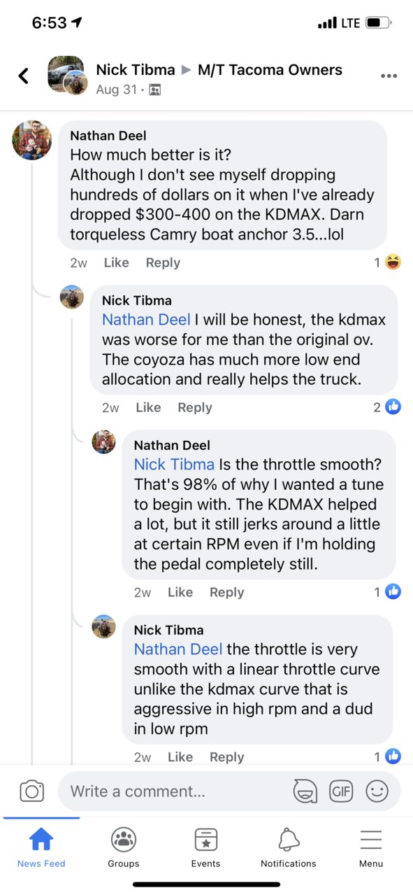

    I am set up to get the KDM XXT tune this Saturday in San Antonio... then I found this tune thread... is there any word on how this one compares to the XXT?

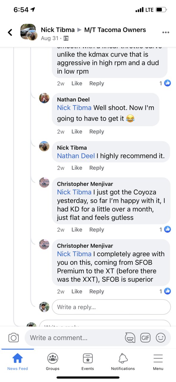

    I’ll leave this here, as my options are biased. Not to stir the pot with any kd guys. There two guys on this thread who compare the kdm xxt. This information is posted publicly on the M/T Tacoma Owners page on FacebookF0AF9B95-43DA-4F28-B85F-D72CA3FF975E.jpg 241036BA-3ADB-4174-97A9-E0E3592A158C.jpg

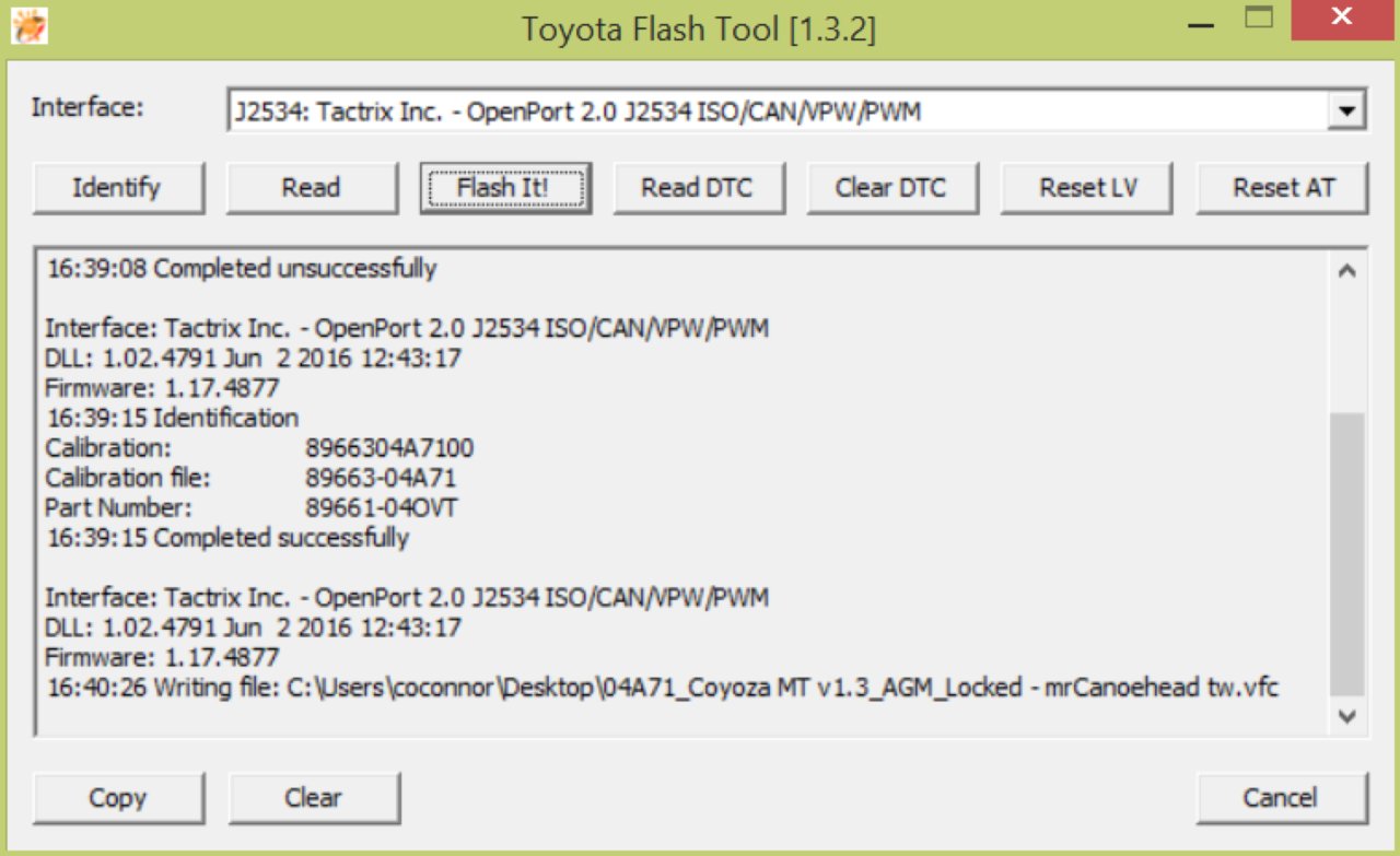

    Just bought this tune, trying to flash it. First I tried to open it in VF Tuner, no joy "file is locked, contact owner." Then I tried VF Flash tool - I am sure the "file is corrupted" message is pilot error. Can anyone clue me in?
