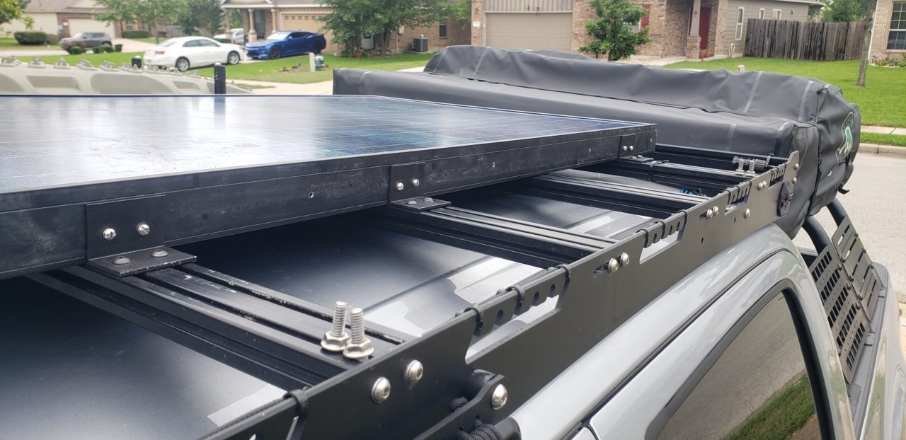

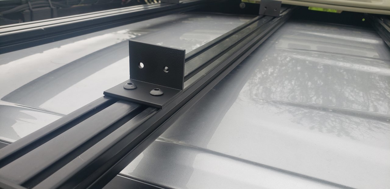

    Now that I have this unit, I needed to find my roundtoit and get the solar panel installed on the truck.
    Took one of the old 80 watt panels and made some brackets.
    Late day charge test, panel was charging at 30watts average. Factory 120v brick was doing 44 watts.

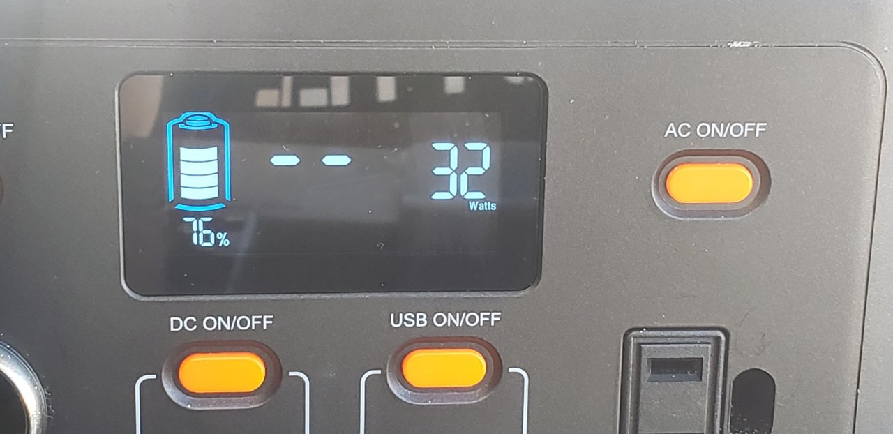

    We got to use the golabs powerpack on our recent trip.
    The breathing machine used about 50% battery each night. The 80watt solar panel mounted flat on the roof was charging between 10 to 36watrs depending on solar exposure and one day with full sun charged from 53% to 100% in roughly 4 hours.

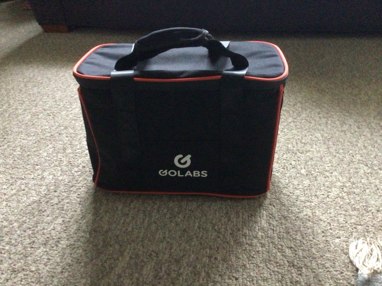

    Golabs just sent me this carrying case. When I bought the power supply there was a card in the box that said email for a free gift. So this is the free gift I assume. They now have a $80 off coupon on Amazon, it use to be a $100 off. Still a great deal.
