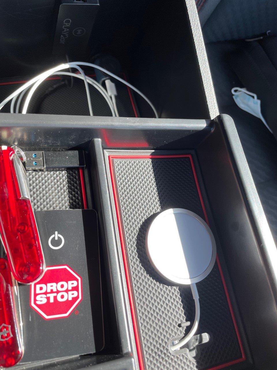

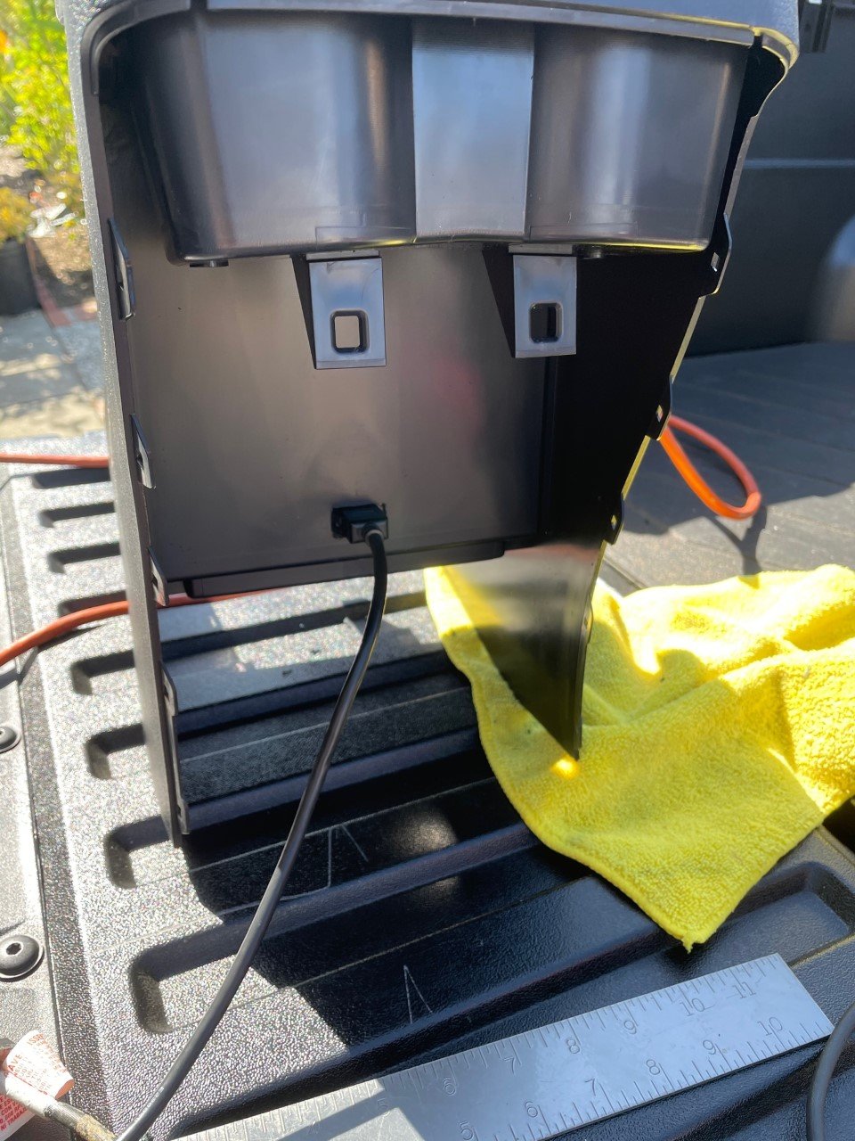

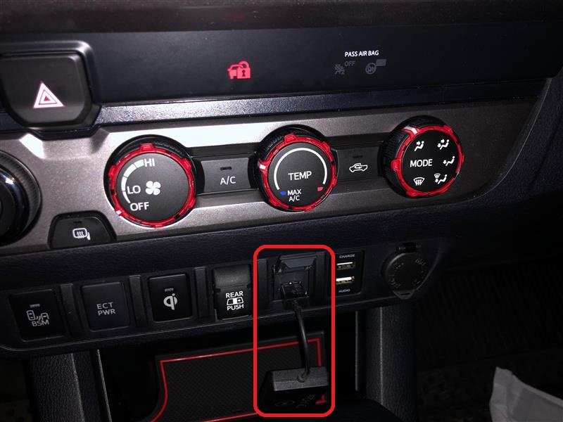

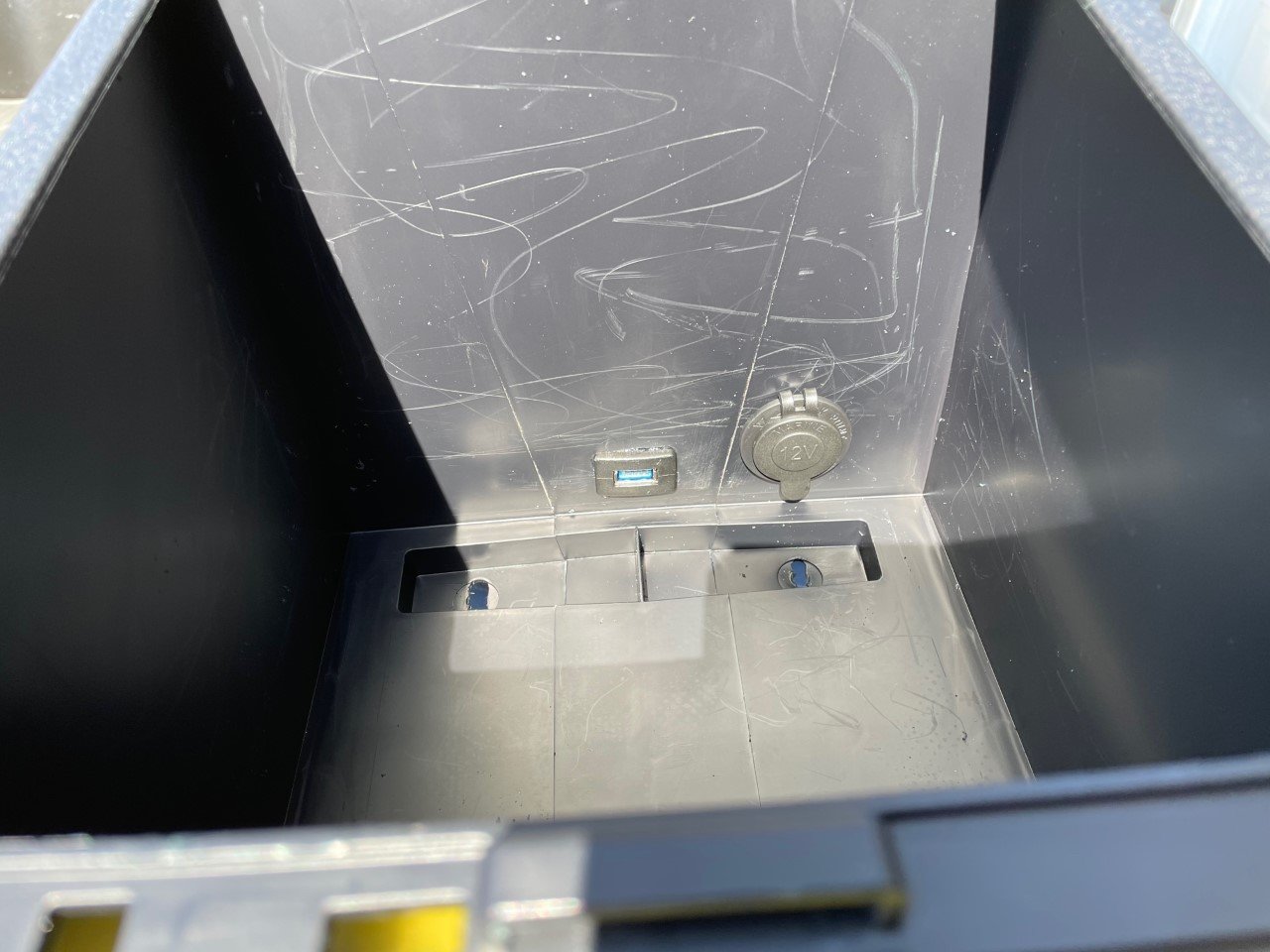

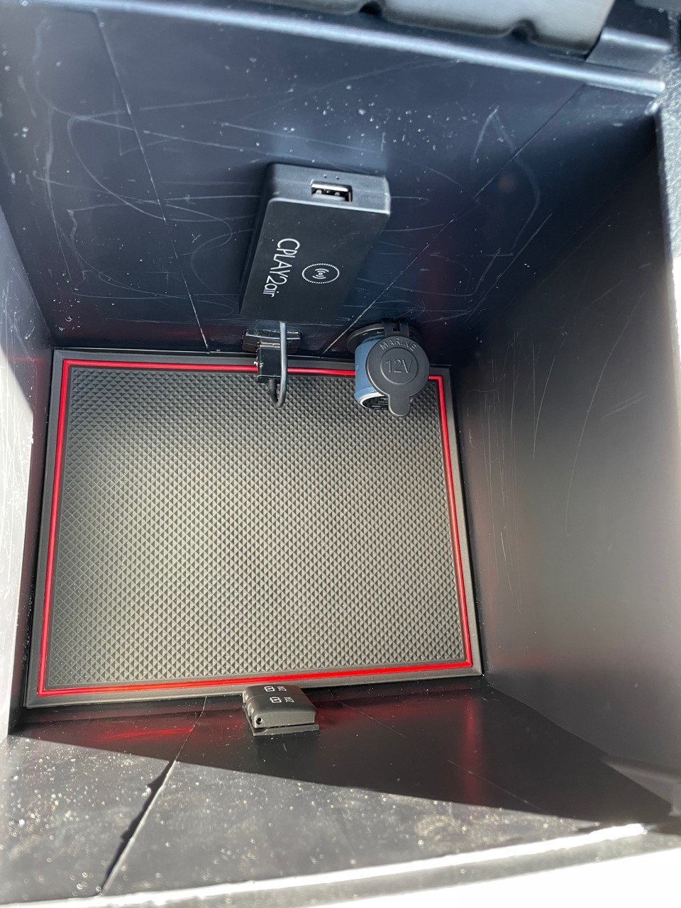

    Like a lot of people who buy the CPlay2air - they have to plug it into the single *media* port in the front, and either stick it somewhere around there or just let it hang down.
    Honestly - that annoyed me. I wanted it in the center console. Out of the way and out of sight.
    So - I bought a USB port extender cable (6') asnd then popped the media port out of the console and plugged that bad boy in and put it on shrink tubing.
    Routed it back to the center console and put it in the rear of it.
    Added a 12v adapter in there as well.
    Then plugged in my CPLAY2air wireless car play adapter. Worked great. No issues yet.
    Bought one of these on Amazon... made sure it worked with the Apple MagSafe USB C charger (it did)
    Then - just because I wanted an authentic apple MagSafe Charger in my center console because I didn't like the Qi charger.
    NOW... I have everything right where I want it. Apple charger (wireless) and the CPLAY2air relocated to the center console.
    All nice and tidy.
