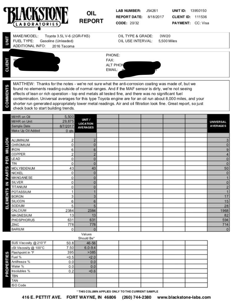

    I swapped my CPS at about 25k miles, also had positive improvements by cleaning my MAF. Asked about the "anti corrosion" issue and lean/rich condition. Also, if it makes any difference I took this sample out of the filter instead of during the engine drain. Forgot to do it then.
