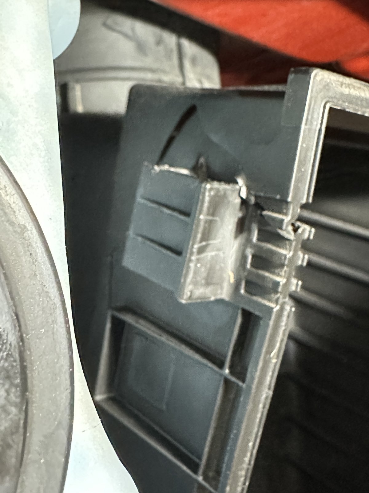

    I was checking the oil tonight and found a small crack in the airbox where the clamp closes.
    Looks like the crack is before the filter, so I think air is still being filtered.
    What do you guys think, still ok to drive this way? (since I probably have been for a while).
    Thanks

    Crazy Glue it?

    JB Weld it and just drive

    The crack is before the air passes the filter, so its fine to drive on. To be honest, you could probably drive this another 200k miles with a slight dip in mileage and a probably unnoticeable increase in intake sound. Just make sure the airbox makes a firm seal around the filter.

    Yank it and rough it up inside and fiberglass patch the inside or try to find a replacement one.

    Thanks for the helpful feedback from most. I figured it was on the other side of the filter and was ok, just wanted further validation.
    One more thing I didn’t notice when I bought the truck, but so it goes sometimes buying used.
    I’ll see if I can find a good price on one online or from the salvage yard, if not, I’ll try to patch it.

    Thanks for the link. I was actually just contemplating whether OEM was important for this type of part, and I was leaning towards not…just a plastic box basically.
    I think a tech at the dealership probably forced it and broke it since it’s right and the point where the clip pulls it tight.

    Considering it's on the intake side of the filter, I would do the opposite. Patch first, then, if your patch really bothers you, take your time to find a replacement.
    But either way, there's no need to rush out to do anything about it right away, just one of those things that ought to be done.

    Thanks for the feedback, that’s the way I am starting to lean. Even the used ones on EBay are going for about 200 bucks.

    Use a bit of acetone to clean the crack and the area around it and be generous with the glue when applying. It will seal the crack right up.

    These airboxes can be found at scrapyard for next to nothing…….

    Totaled. Post the part out ASAP.
    JK. Superglue or pull one from a junkyard for $5.
