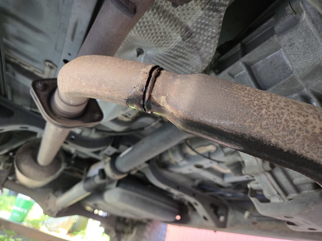

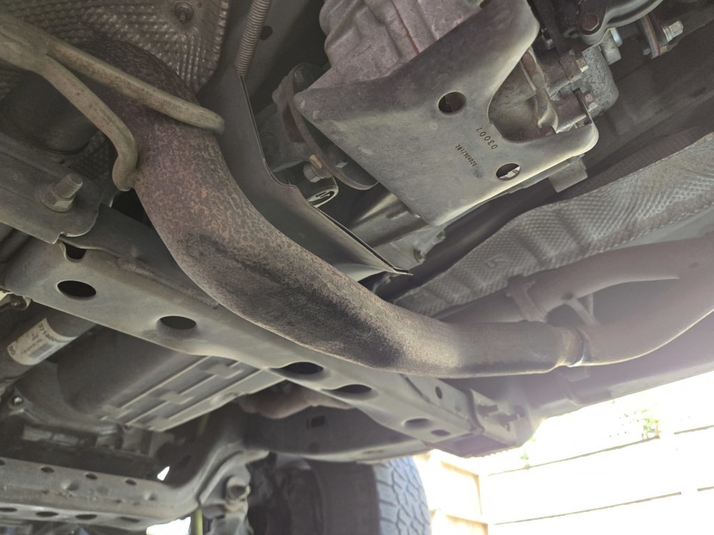

    Curious if anyone knows a quick fix to a crack in my catalytic converter pipe..

    Best option would be to weld it.

    find a local exhaust shop-- many will do it for extremely cheap.

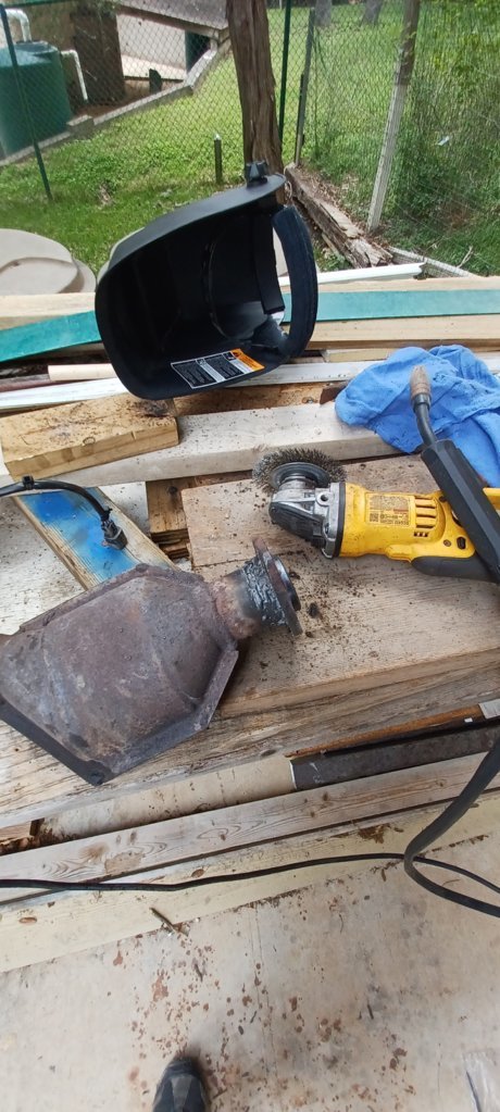

    Just welded mine today, actually. No more CEL. P0420 gone. Weld ugly but sealed.
