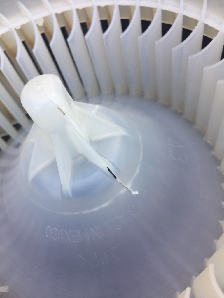

    Here is a photo of my fan, this was taken about a month ago, the fan has continued to function well when kept no higher than setting 2. I think I lucked out, my buddy's failed instantly and apparently the fan fractured into multiple pieces.

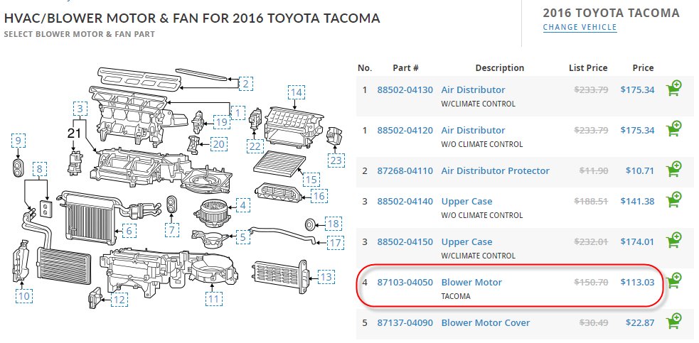

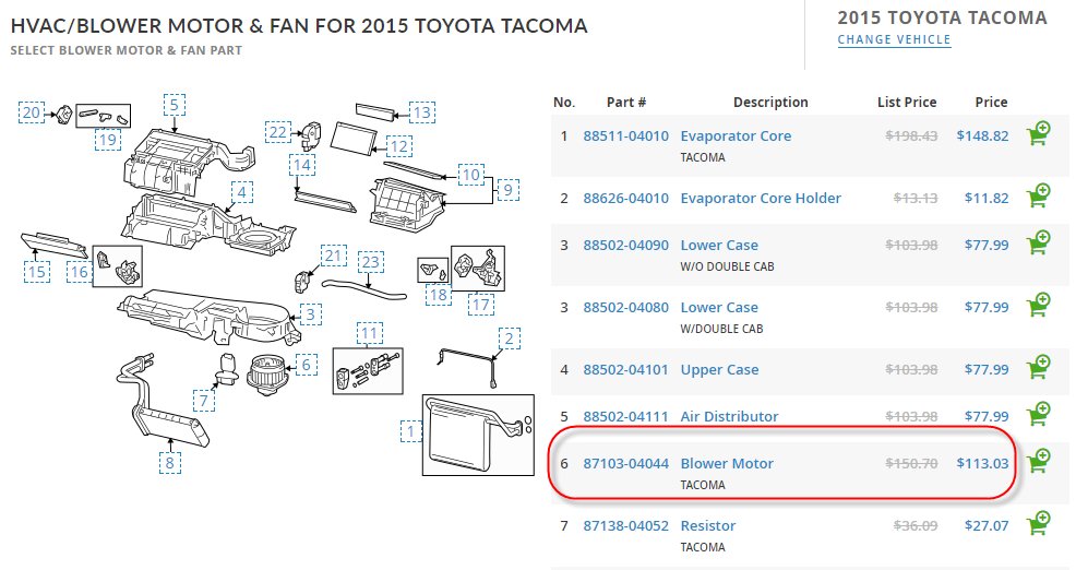

    diferent part # for the 2nd and 3rd gen, but same price on them. Wonder how different they actually are. The fan cage is not listed separately, but probably the same.
