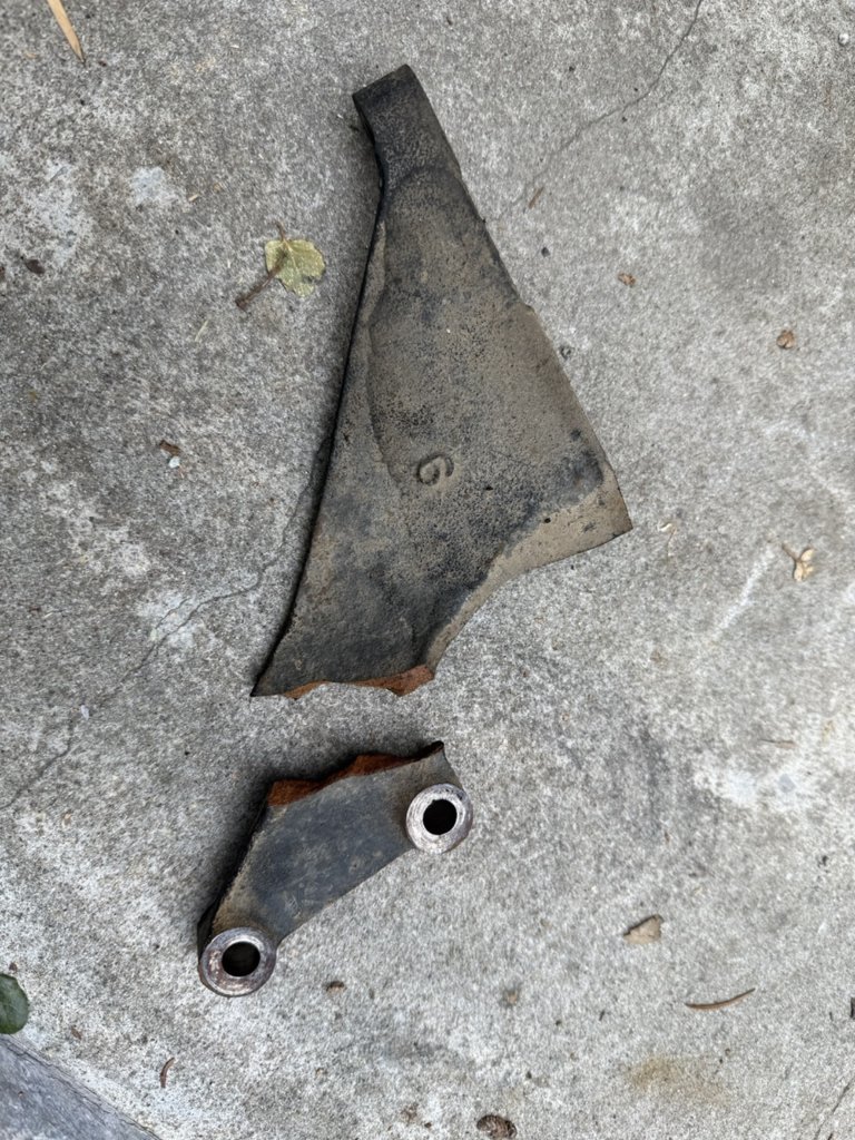

    Found this part connecting the driver's side engine block to the manual trans lower bell housing was cracked today while changing my steering rack bushings. I can't find it in any of the online OEM parts listings. Any idea what it's called or what Toyota's part number is for it? It's a 2.4l base 5-lug taco.

    Try looking for stiffener plate, I believe that is what you are looking for. About $90 or so. Toyota parts Center Online says they have them in stock.
    33118B-26011

    Thanks for the ID on the part. It's actually the left hand (driver's side) stiffener bracket. After much digging I'm getting 33119-35040 as the part number. Seems near impossible to find online however.

    Ah, this sounds like a good junkyard part scavenge, try a couple good junkyard data bases. I've had decent luck doing that in the past for old land Cruiser parts.
