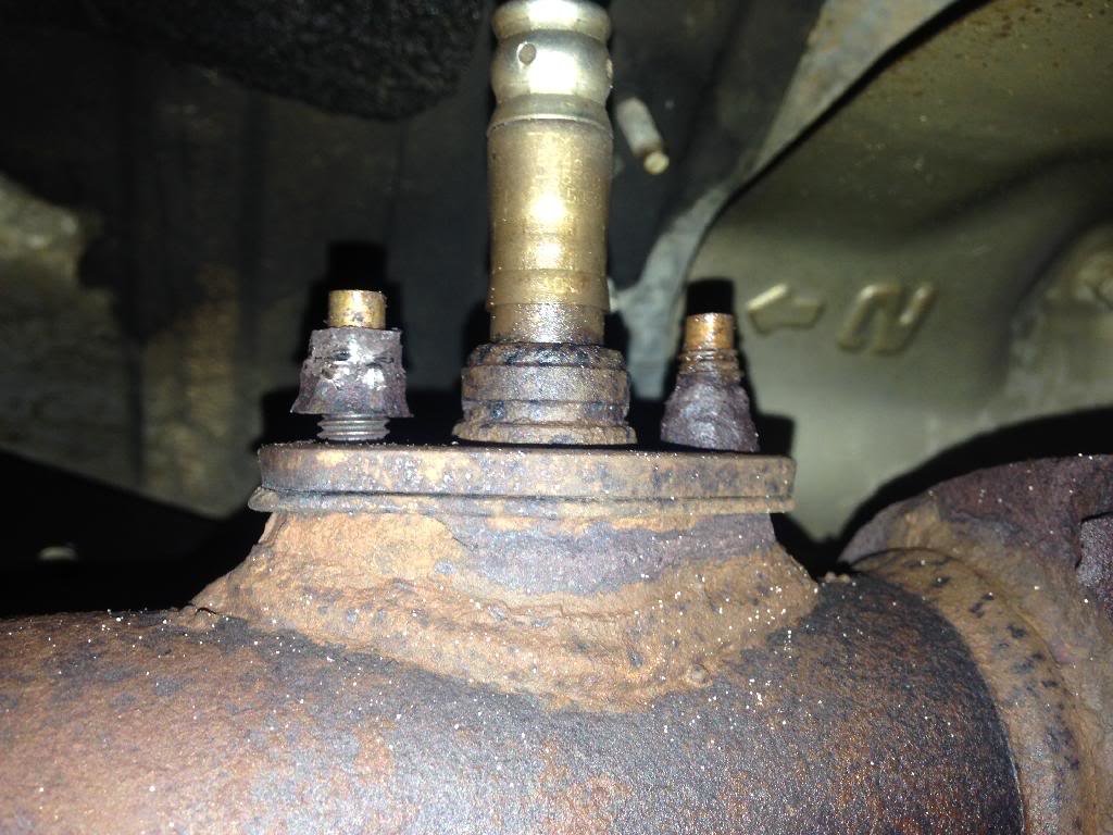

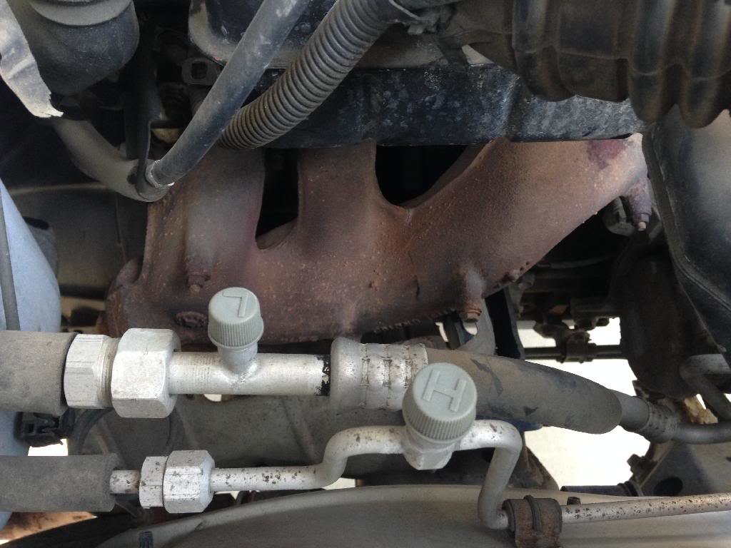

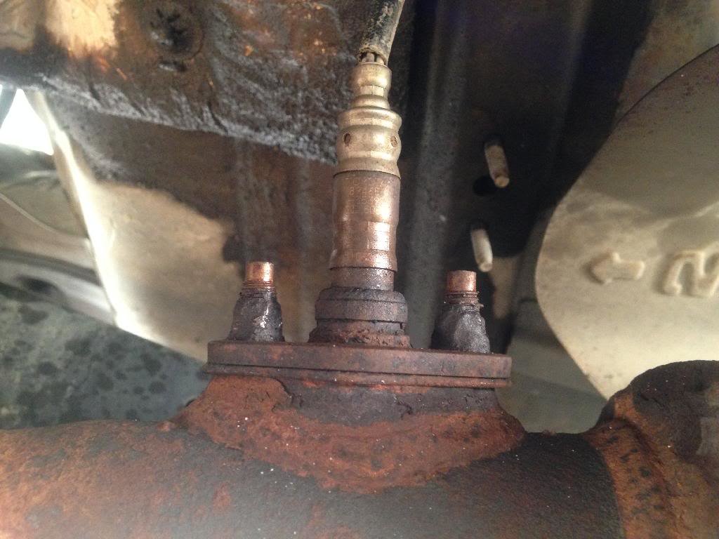

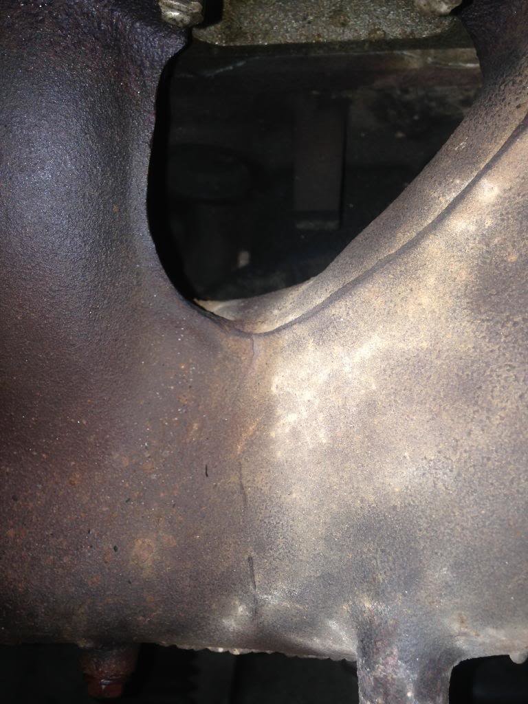

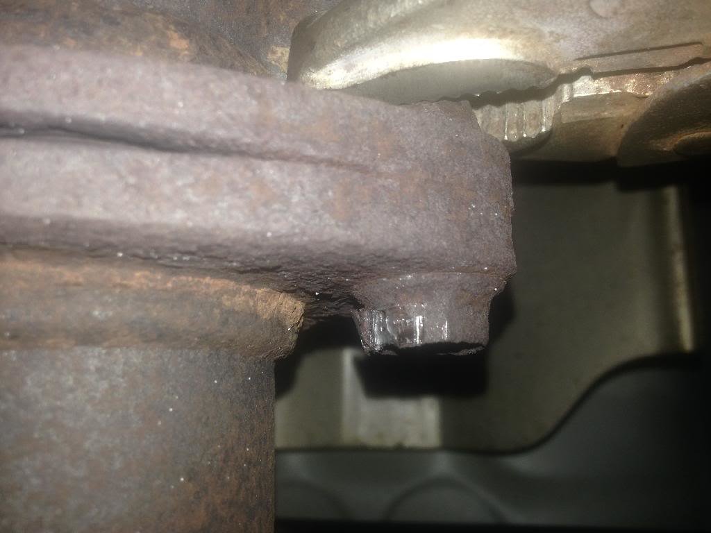

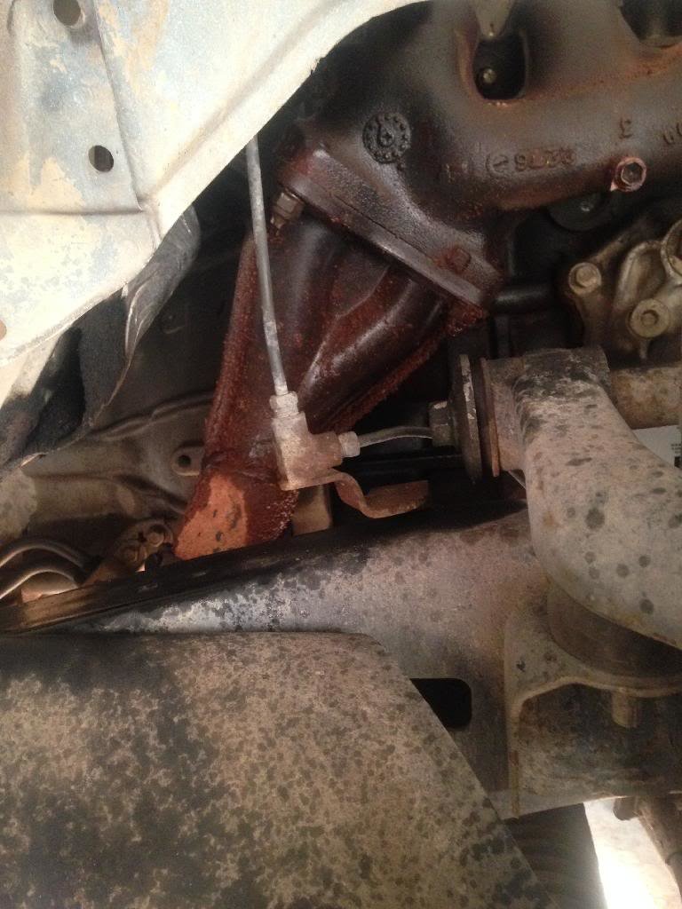

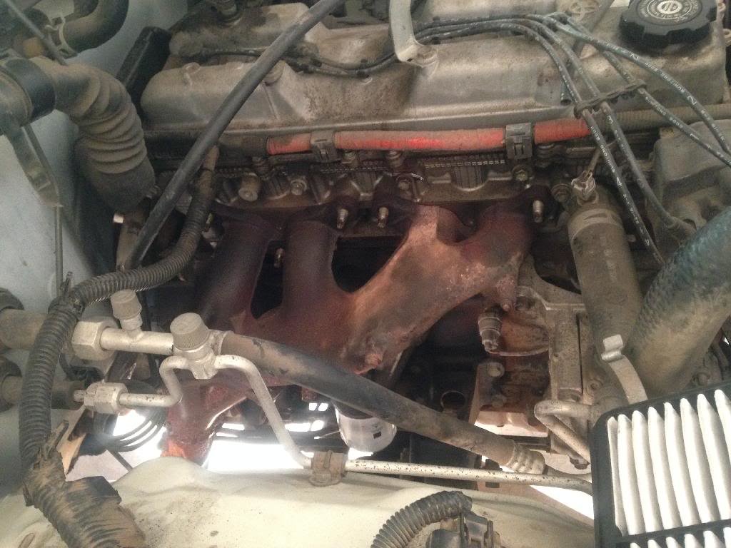

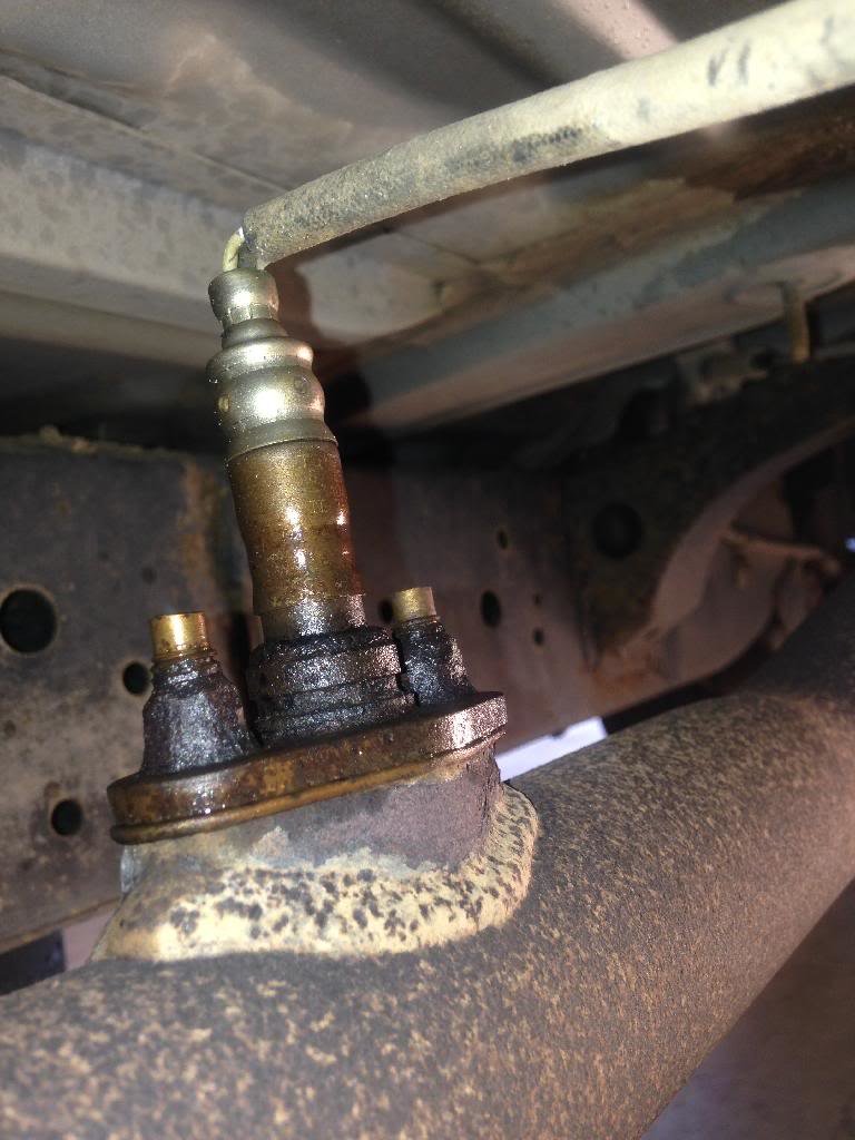

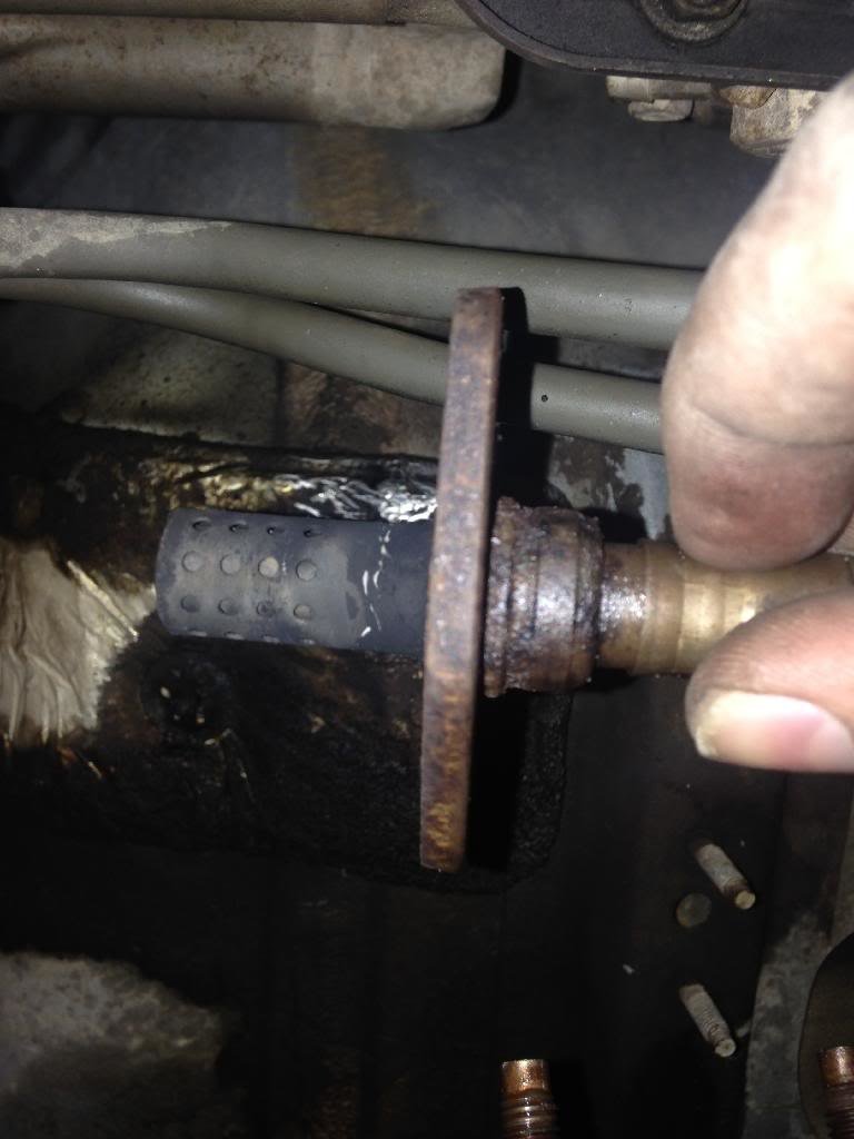

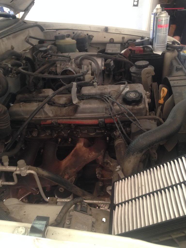

    So I decided to focus on the MAF sensor and cleaning the O2 sensors. The MAF sensor was hard at all now the O2 sensors are giving me issues. I just sprayed WD40 not sure if its going to help. I'll post some pictures so you guys can see whats going on.
    This is the first O2 sensor, very rusted. I'm not sure if I will be able to get it off.
    Here is the second, pretty much the same story.
    This is where I was working on the exhaust manifold
    The crack in the exhaust manifold.
    Any help is greatly appreciated.

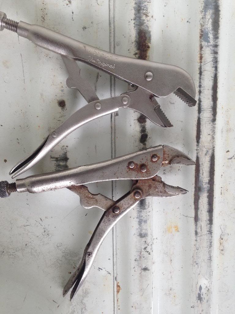

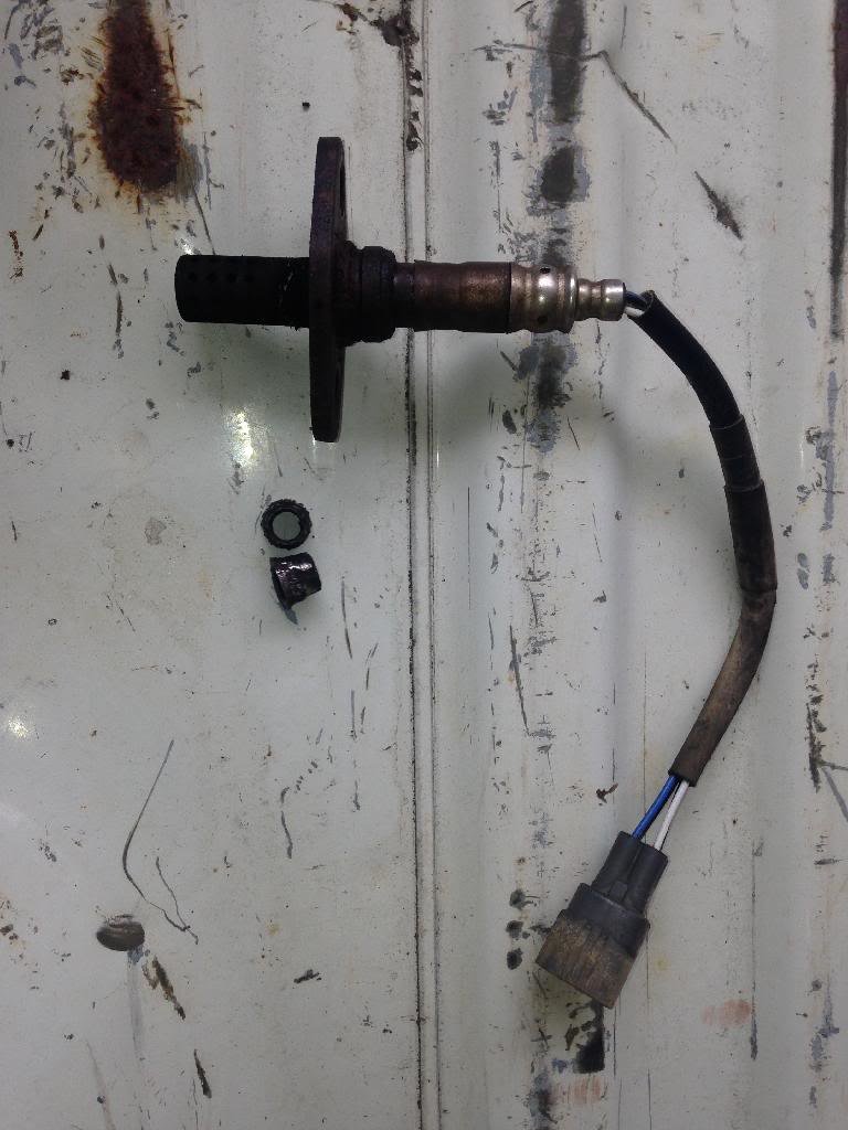

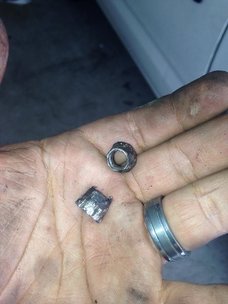

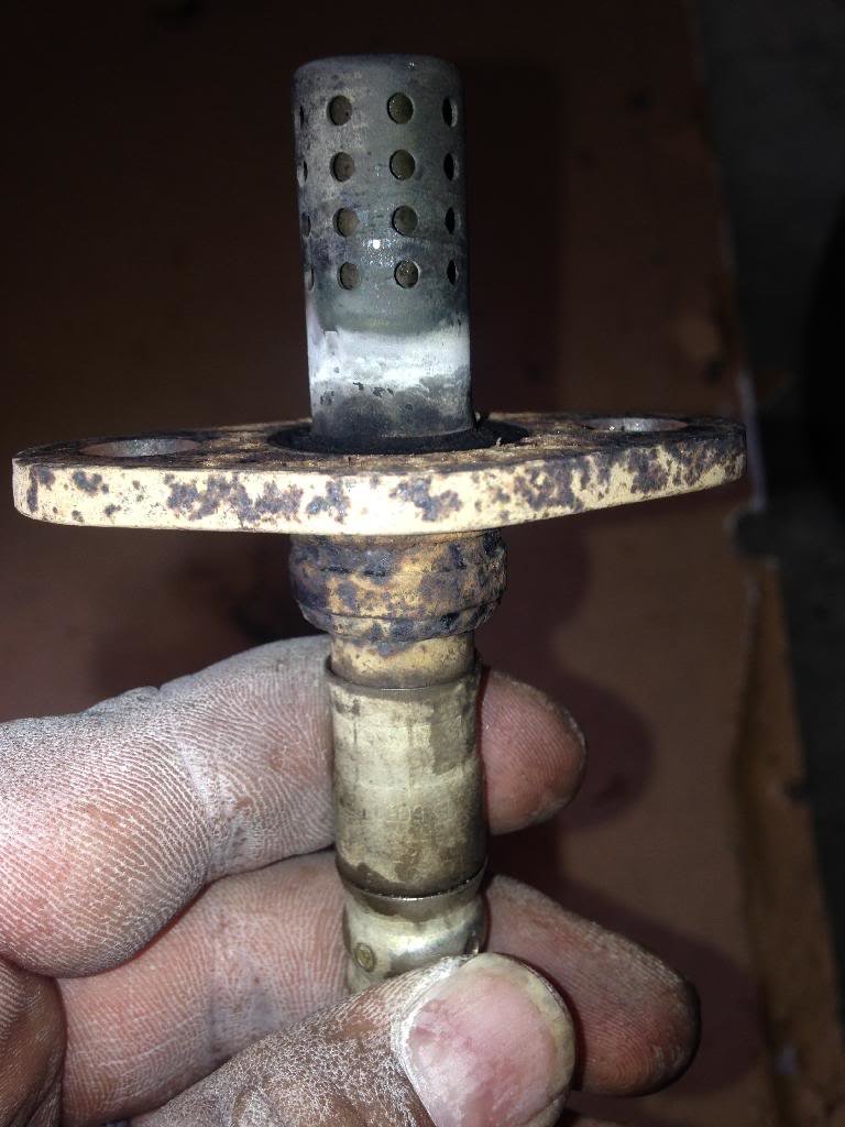

    So lots of WD40 and this is where it got me..
    I had to upgrade my vice grips and I was able to get the o2 sensor off.
    This is what was left of the nuts.
    Dirty o2 sensor
    Clean o2 sensor

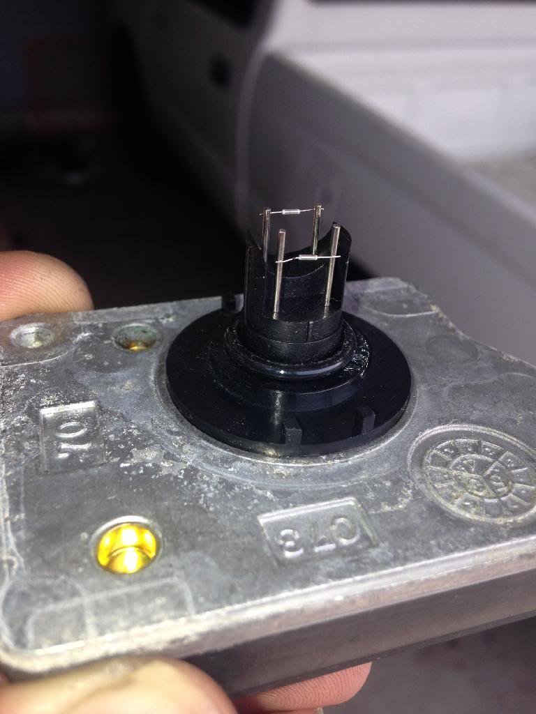

    also here is the clean maf sensor
    Any way to tell by looking if either sensor is still good?
    By the way the new vice grips worked like a charm.

    Sensors definitely look cleaner. The MAF should be fine but the O2 you can only tell when you try to use it again. Any old O2 sensor will be a prick to get out. Try using anti seize when you install anything back on, it'll help you next time to need to do maintenance. Can't tell how deep that crack is. If it's superficial or from the casting then you have time. Good work so far.

    I was under the impression I would be able to get the nuts for the O2 sensor and the exhaust manifold at the dealer without an issue. I was wrong they have to special order them. Does anyone know the demensions on them? Also the for the 2 studs on the backside of the manifold, they connect the ERG line?

    I got it all put back together with the new exhaust manifold, cleaned o2 sensor and cleaned MAF sensor. I cleared the codes and the check engine light is still on giving me the MAF sensor code p0100. It was smoking at first, now the engine seems to be running fine. I decided to take it for a little drive and it won't accelerate, hits about 20 or 25 mph.
    I was thinking it may be a clogged catalytic converter now, any thoughts?

    If you still need new nuts...that sounds bad...take the old ones to Home Depot (i forget what yall call them in Cali) or Ace Hardware and get new ones. They have pegs there that will tell you size and thread count of your old hardware.
