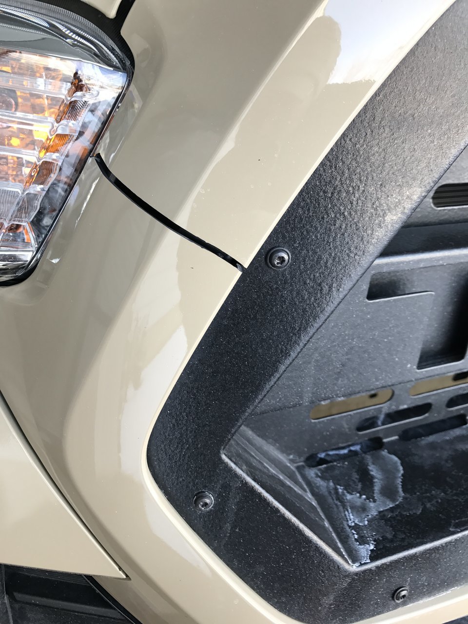

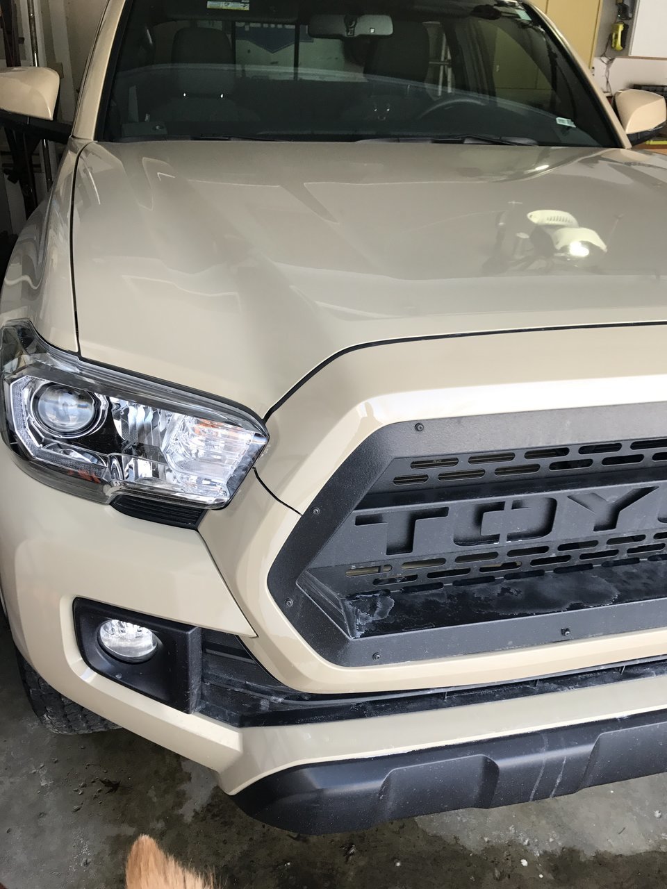

    Hey TW,
    What do you guys supposed happened to my plastic grill surround? Last week I noticed it had cracked. There are no surrounding abrasions to suggest it was hit. It was bitter cold here however, could that have caused it? Additionally, I have the BAMF grill which has been on for about a year now without issue. Think Toyota will warranty this? Should I put the chrome grill back on first? Thx
    Photos below

    Someone else had a similar problem with a BAMF grill cracking the ring, something about the tight fit and no give of the grill

    100% on that grill being the issue. Swap it out before you try and cheat the system.

    Put that plastic chrome one back on before you take to the dealer for sure! Once you get that shroud replaced I would go with a different aftermarket grill, that one fits too tightly and being metal doesn’t give at all and is hard on the plastic shroud judging from the posts I’ve seen.

    Don't try to get Toyota to warranty it, its not a fault of the truck. Contact BAMF and see what they will do for you. Otherwise, man up and pay for it yourself.

    Plastic expands and contracts with temperature change. Metal does not(well, not as much) Your surround shrunk and the grill didn't give. I wouldn't say it's common, but I have seen many that have done this in colder temperatures. For me, it's the best grill out so I will take the risk. Plus it rarely drops below 32° here
