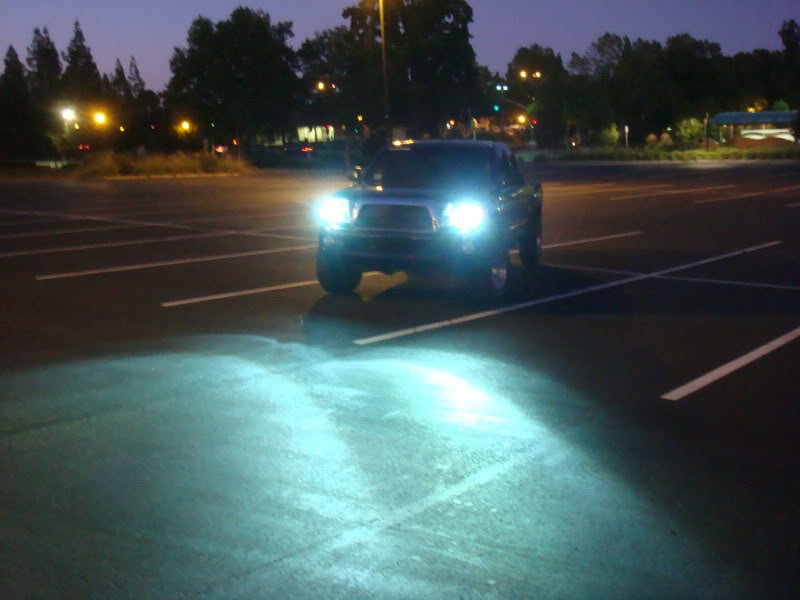

    the projector lens is purple... not clear...

    12k is purple.. It's neat looking but doesn't do much other than get you pulled over a lot.
    I have 5k in my moms 05 and my dads 08, both were installed when they got the trucks band new in those years. So never had any issues in all these years other than one bulb going out.

    first off your factory fogs will put down more light than this setup second it will be purple :rolleyes: third if your buying 12 anything it's got to be some piece of shit pnp kit.
    dude save your money retrofit it's a thousand times better or the alternative is to run a high performance halogen bulb.
    check this link to clearcorners.com there is a solid write up on halogens and the choices you have for bulbs. also look inot there hid faq page as it will basically repeat what i just told you about choosing a color temp. if you want hids look into 4300k or 5k no higher or you will lose light. in a quality setup the color of the lights can be dramatic not from the bulb temp but, the color flicker from the projector ie, the cut off line.
    http://www.clearcorners.com/tech/001/
    http://www.clearcorners.com/tech/005/
    or go to theretrofitsource.com and buy your self a real set-up parts will run around 300 dollars for a very respectable setup one that will in fact be brighter than any oem hid light by a good bit. plus your not going to glare other drivers into a ditch on the side of the road :)
