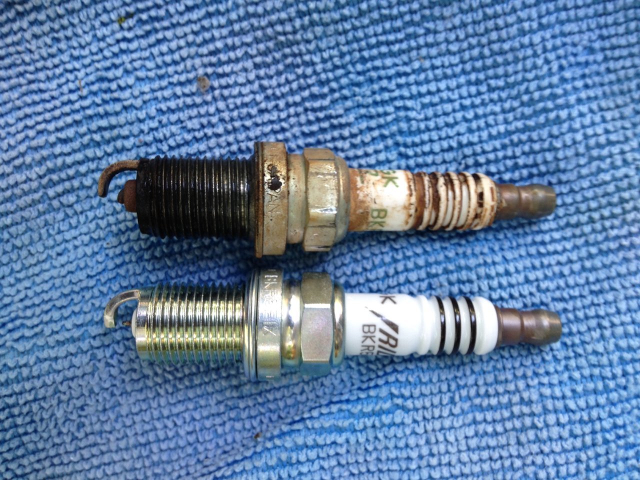

    Problem solved! The flashing check engine light came on so I thought I was screwed for a second. Been meaning to change my spark plugs out anyway so took the opportunity and swapped em out, boy were they toast. #3 in particular was wet down to the threads (or oily?) either way disgusting, that was probably the one shorting out on me. Learned my lesson to go easy with the hose around the spark plugs. The cracked coils certainly didn't help matters. Will replace those one of these days...
