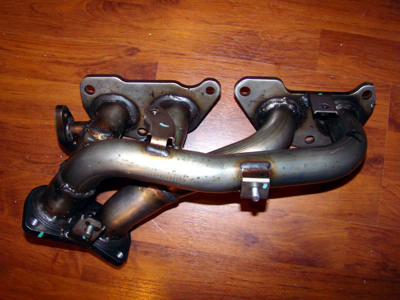

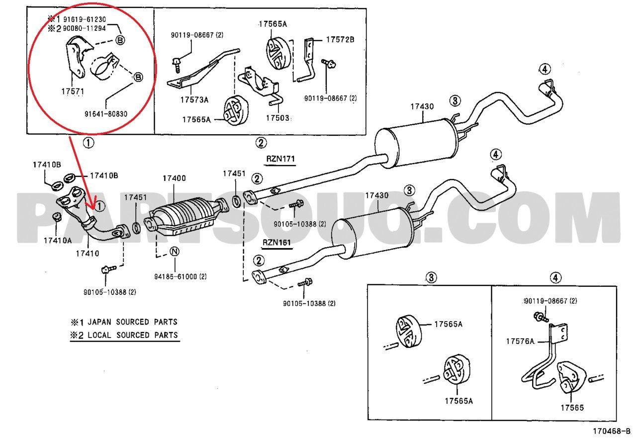

    What tends to cause it is the engine torquing (twisting when you press the throttle) and not having the exhaust bracket on your down pipe to hold it to the transmission. If it is not there, the exhaust pipe doesn't move with the engine when it twists but tries to stay stationary so it tends to crack the exhaust manifold due to it getting weaker from the HOT/COLD cycle and added pressure
