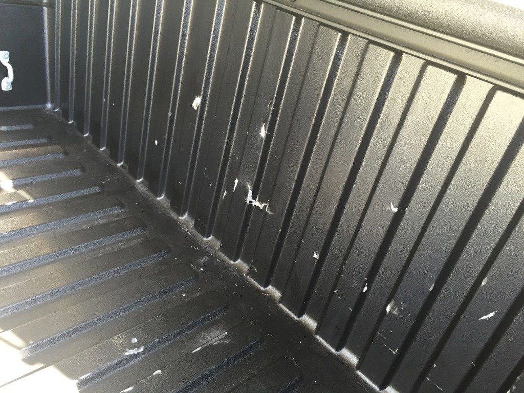

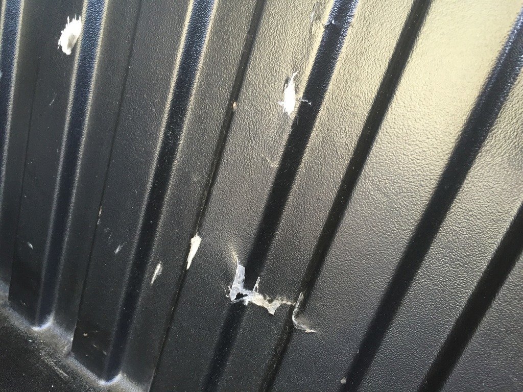

    Just wanted to post some pics of what I'm looking at, crawled under the truck to see how bad it was on the other side
    C5F45D34-01F6-4C96-B9E3-09C0E321C62E_zps_fddde44066142f7e123efb14af59ee3c825c4d65.jpg
    94D03A7B-932C-4EF1-A0B9-9F777FBD1176_zps_290060f988759164873d27ff995eb0af0bbb4efa.jpg

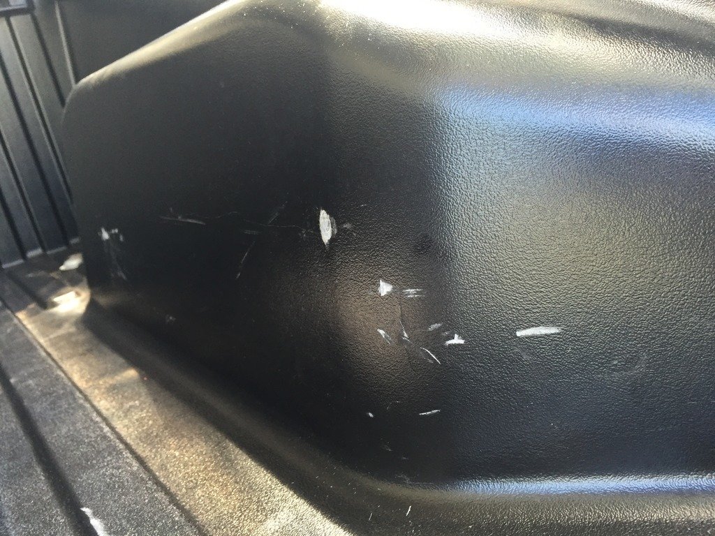

    This is I between the cab and bed
    21F6BA65-839B-4BBD-A13B-E1D847E0501C_zps_8a86d1abbb640f767772555b7a51d0d5b1565dd5.jpg
    687907EA-9304-46F3-B006-C5E3F8EB052D_zps_4240cff44ab64eece5cd7d9d2c7f1ef40ed9664d.jpg

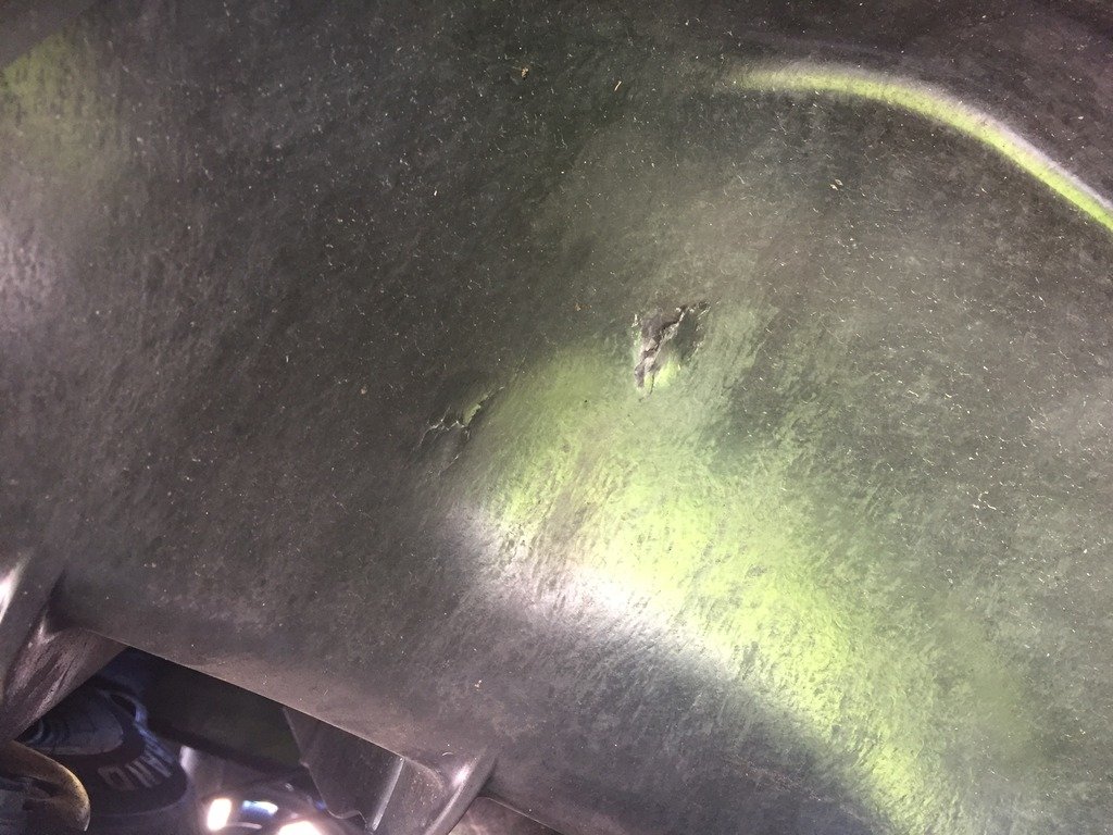

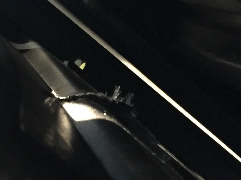

    While I was under there I also found this at the pass side wheel well
    E4D4911D-AFA2-47ED-80C0-9C89E350AC35_zps_1c78de79340ed1c1af2243615f4ac20d7edd64b5.jpg
    Didn't even realize it was there, this is what it looks like from the bed

    Kinda bummed out about it. I'd like to fix it as best I can. I know it's just the bed of a truck and I don't really care about scratches and gouges in the bed, but the ones that broke through are on my mind.
    Anyone else have broken through gouges? Common? I worked my 13 a lot harder then this one but I don't remember having any break through, never really checked tho.
    I'm more worried about it weakening the bed and spreading with more use.
    I'm a mechanic so having engines, trannys, engine hoist, just generally heavy car parts/tools isn't uncommon to find in the back of my truck on any given day.
    And found some more stress fractures through the other side wheel well as well, not as bad tho
