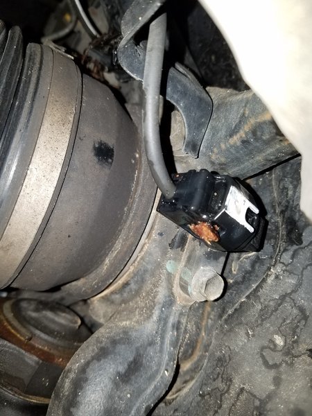

    Did some light wheeling today in the new regular cab, got into 1 somewhat hairy spot. Put it in 4L (which is absolutely beastly) and crawled right out, however I think I knocked my wheel speed sensor at this time. Afterwards my traction and abs lights have been on.
    After some quick searches about the lights, I checked my wheel sensors, and sure enough, my drivers side is cracked. So is $138 really the cheapest to get these things? And can I be driving for a while with it? It hasn't done anything weird except annoy me with the lights.

    The only issue is that the TRAC and ABS are both disabled. Doesn't hurt to drive it.

    check Amazon i got mine for 20 bucks
