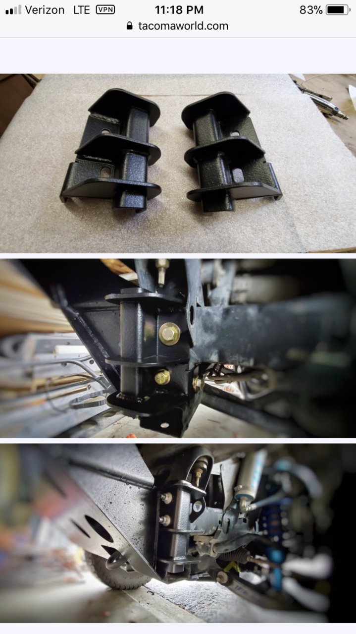

    That is the part that supports the cabin to the frame. Is the same part as in the picture below.
    Next to it is the cabin area plate that is cracked in OP's pictures. Reach with your arm down the hole next to the light till to find/feel the support part. Then move your fingers a bit lower and along the edge of the cabin plate. If is smooth and continuous you're good, if you find cracks and tears you're screwed.

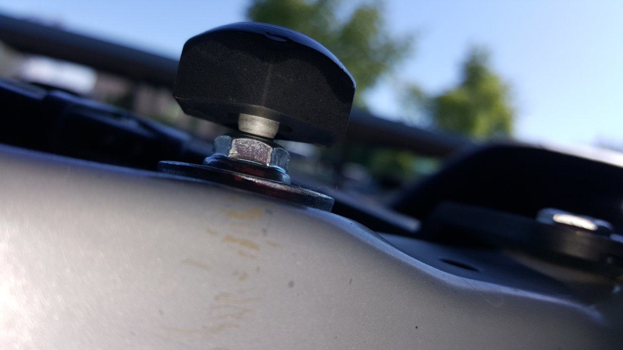

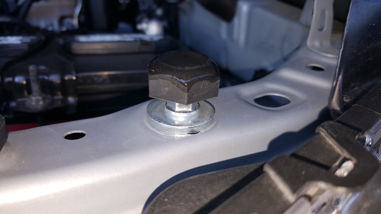

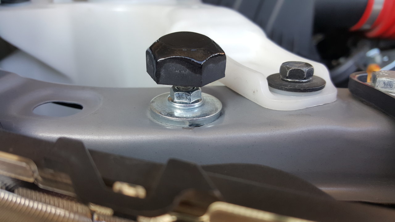

    Good write up!!!
    What bumper are you using for your hood, that's not stock....

    I removed the OEM rubber screw hood bumper (that was a fucking piece of shit, total garbage, good for nothing SOB support) with a hood bumper from FORD :facepalm:and two washers. A lot better now and the hood is not moving LEFT to RIGHT as much now.

    I'm surprised, at least some Ford parts are not garbage, lol. Good mod Danny!
