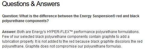

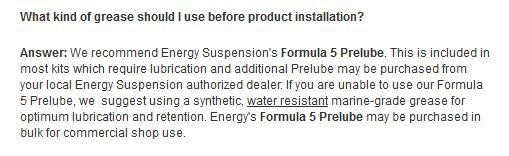

    A bit disappointed in the ES bushings. They are a lot better than the OEM bushings BUT they do not tell you that they will squeak if not greased. Have watched their promo video and they mention that poly bushings will make noise without grease. Also a few other videos about poly bushings want installers that grease MUST be used since poly is notorious for squeaking. There was no grease in the package box. Have called them and asked where is my grease and pointed to their promo video and was told that I have to buy it separately...I did. Yesterday I called again and asked them how much I should grease their bushings and the guy told me not to use their silicone grease but use anti seize grease...Now I have to spend a lot of time again to undo-redo the installation, torque to specks and grease them. The worst and hardest part is removing the wheel-well liner.

    Did you buy the red bushings?
  16. Nov 8, 2019 at 8:54 AM
    #216
    Dacon
    Dacon 2017 Tacoma TRD PRO Quikrete
    Dec 20, 2016
    #205354
    2,932
    Danny
    Gilbert, Arizona.
    2017 TRD PRO DCSB. DOP 02.20.2017
    TRD PRO Cement 2017 TRD CAI and AFE Magnum Flow Dry Air Filter Camburg KINETIK Series Billet UCA Icon LCA skid plates Icon Coilover extended travel shocks with 700# springs Icon 2" rear shocks Icon RXT leaf springs full pack (new rims and tires soon)
    Black.
  17. Nov 8, 2019 at 9:49 AM
    #217
    TireFire
    TireFire Superunknown Member
    Feb 6, 2016
    #177349
    7,666
    Olympic Peninsula
    So there ya have it. No grease required they it wouldn’t hurt and stave off rust though based on your location probably not a concern
