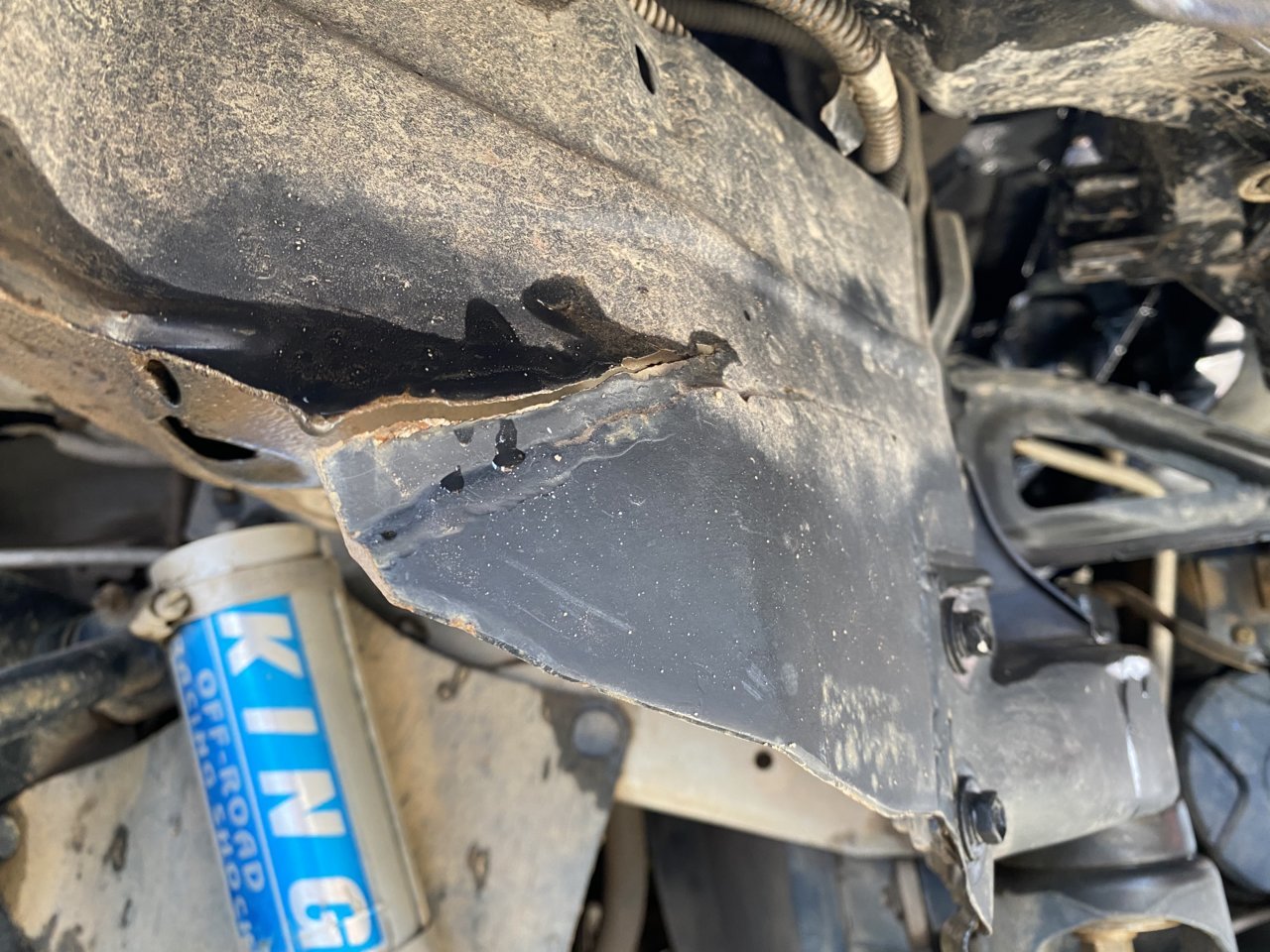

    And my plate fix finally died this weekend. But to be fair I was really driving like an asshole.

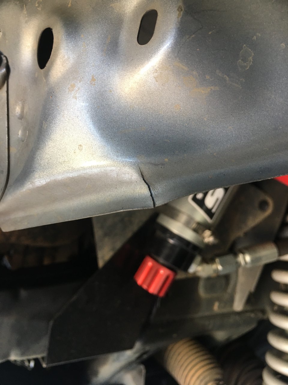

    @CG256 Is this what you were talking about?

    Did that break above a weld, or on a weld? It looks like you had rust under the paint. Plating the support should be a good solution, but that is a fuck ton of work. Not a big deal on a 70s or 80s truck that where you can stand in the engine bay, but these are tight and there are so many wires and hoses to move to get to stuff.

    Above the weld, and probably.
    The cases I have seen of cracking are extreme abuse. My fix held for quite a while. It wasn't until I bombed up a rocky mountain trail at 20 mph for half an hour, getting a little airborne a few times, that this new crack formed.

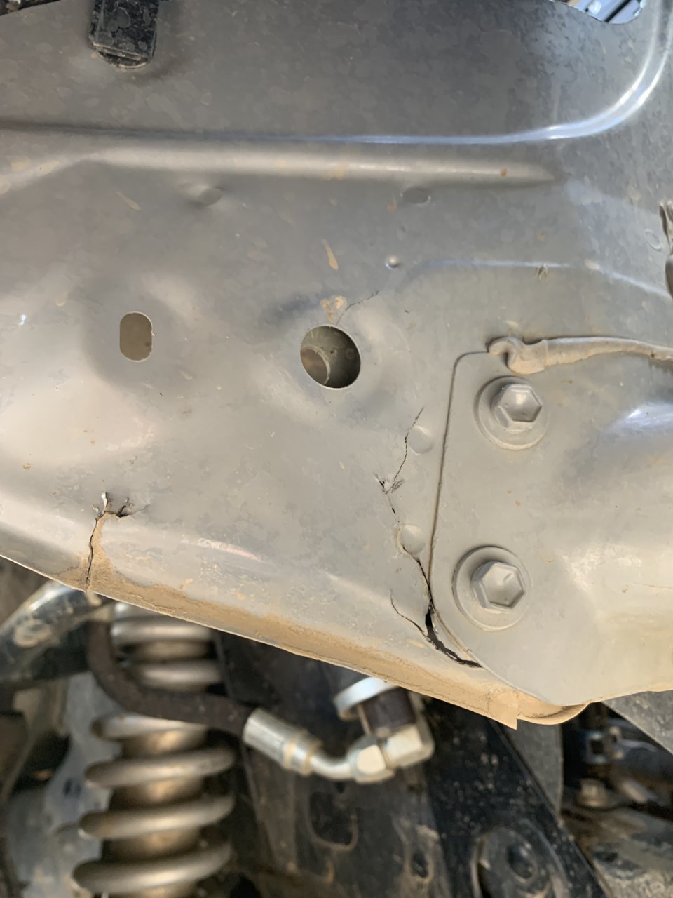

    Well, shit. Just rolled over 100k miles and noticed it this afternoon.
    poly pushings in the radiator support the last three months and a AGM 27F battery since May. 99% street driven, haven’t been off the highway in over a year and a half.
  19. Sep 5, 2020 at 12:35 PM

    I would stop drill that ASAP

    yeah I am. Just goes to show how weak the metal really is. You don’t necessarily have to abuse the truck to make it crack.
